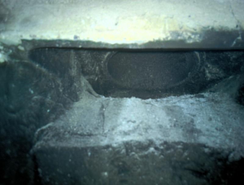

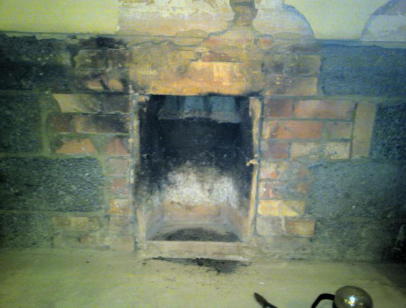

I want to install a wood burning stove, I've searched for advice but practically all examples/information describe fitting a stove into a recessed fireplace.
Our fireplace is very small, so it would be a bit of work to open it up, it also has a throat lintel and clay linning, I'm sure it's possible to install a stove that sits on the hearth, can someone offer advice on how to do this please?
I don't think I can install a register plate as the gap behind the throat lintel is only about 4 inches, I have seen a plate for sale that gets placed over the entire opening, is that an option, what about sealing it?

As mentioned, the fireplace is tiny, it also has a throat lintel sitting on top of the linning, and it is this that makes it difficult for me to see how a stove can be installed; there is no room for a register plate with the lintel/linning as it is and if I remove these another lintel will need to be installed, which I'd rather avoid.
I'm sure I've seen installations where the entire fire opening is covered by a board and the pipe passes through this, but I can't find the links now.
Is this a possibility still, I wonder if this method is still OK with the current regulations, is it possible to seal it adequately this way?
I suppose the question should be 'can I fit a wood burning stove using my existing fireplace, or does it have to be opened up?'.

8m x 4.5m x 2.3m just a square room no recesses.
The fireplace is in the centre of one of the long walls, an outside wall, the chimney is built on the outside.
Are these pics any good? The first is a view through the throat lintel.
You can put a fire proof board (e.g. steel or bricks) over the hole. Obviously it needs sealing 100% so no gases/smoke can escape. Pipe out of the back of your stove, through the board (tight through perfect hole), into the recess (seal with fire cement last mm). Distance from stove to end of pipe can be no more than 150mm (as it is horizontal).
So far this is all okay to pass building regs.
BUT you have no way of sweepingand collecting the soot. Create soot door on otherside of wall into fireplace chamber. Then you can sweep from this soot door and remove excess soot. Bottom of soot collection area needs to be at least Xmm below bottom of horizontal pipe (X = diameter of the pipe).
I do not know if one is allowed to have a soot door under the horizontal pipe on the same side as the pipe?
You also need to look at air vent regs, hearth regs...
