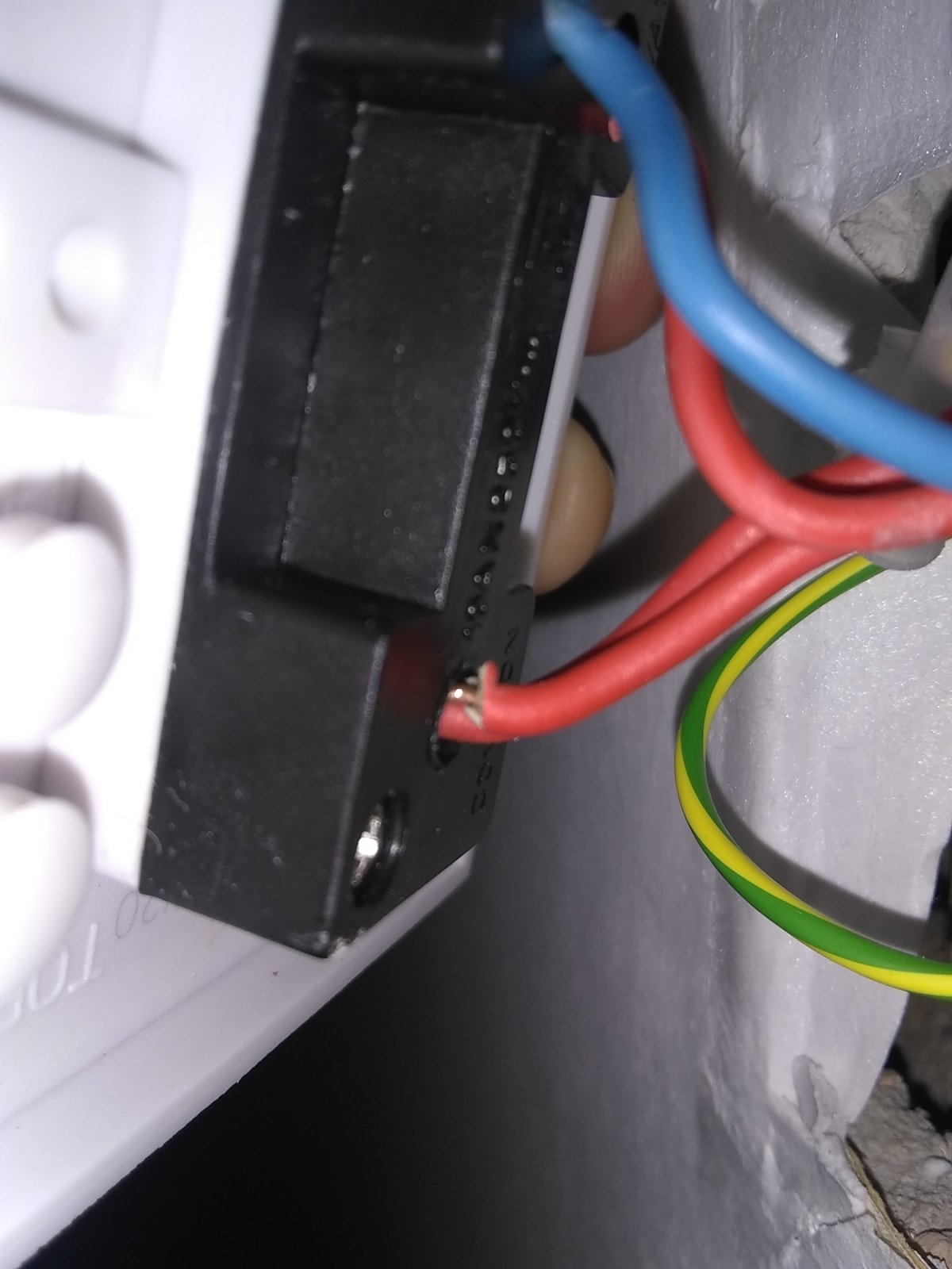

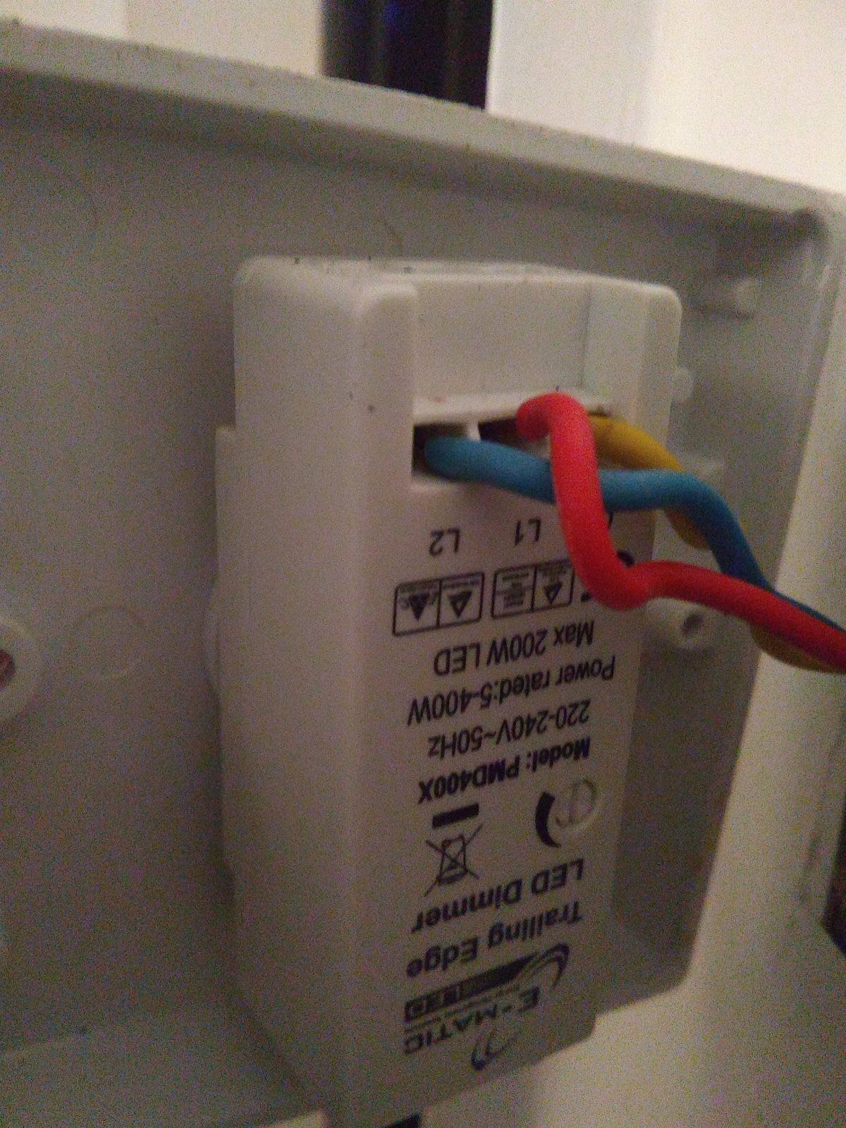

Hi again I am having a problem sorting this out.
I have tried to connect the wires in a connector block in the switch but it trips the RCD.
So I am attaching pics of the layout.
The first pic is the switch I want to blank out, this has to reds going into the common and a red and blue each going into L1 and L2. Now I have connected the two going into the common in a conn block and terminated each of the other two in a separate conn block.
The other pic is the dimmer switch end with one wire into c one into L1 and other into L2.

I don't understand what point you were trying to make. Given that (in that quote from the OP) L1 of the switch is unused, then all that is happening at that switch is that two of the conductors are joined and, if the switch is 'on', the third conductor is also connected to those other two. IF (as is what we assumed) that cable came from the dimmer, then that 'functionality' at the switch could be duplicated at the dimmer end, and the cable then simply disconnected.
However, the goalposts now seem to have been completely moved by the OP's most recent post and photos (which are very different from the original OP, as quoted by you), so I withdraw any assumptions (and conclusions/suggestions based on those assumptions) about where the cable(s) in question actually go/goes. Indeed, since there are three red and one blue conductors at the switch, I now don't even know how many cables we are talking about - certainly not the 'one' I had been assuming!
Kind Regards,m John
Not if the Line (or SL) is at the switch end - as it would be with the conventional two strapper method.
