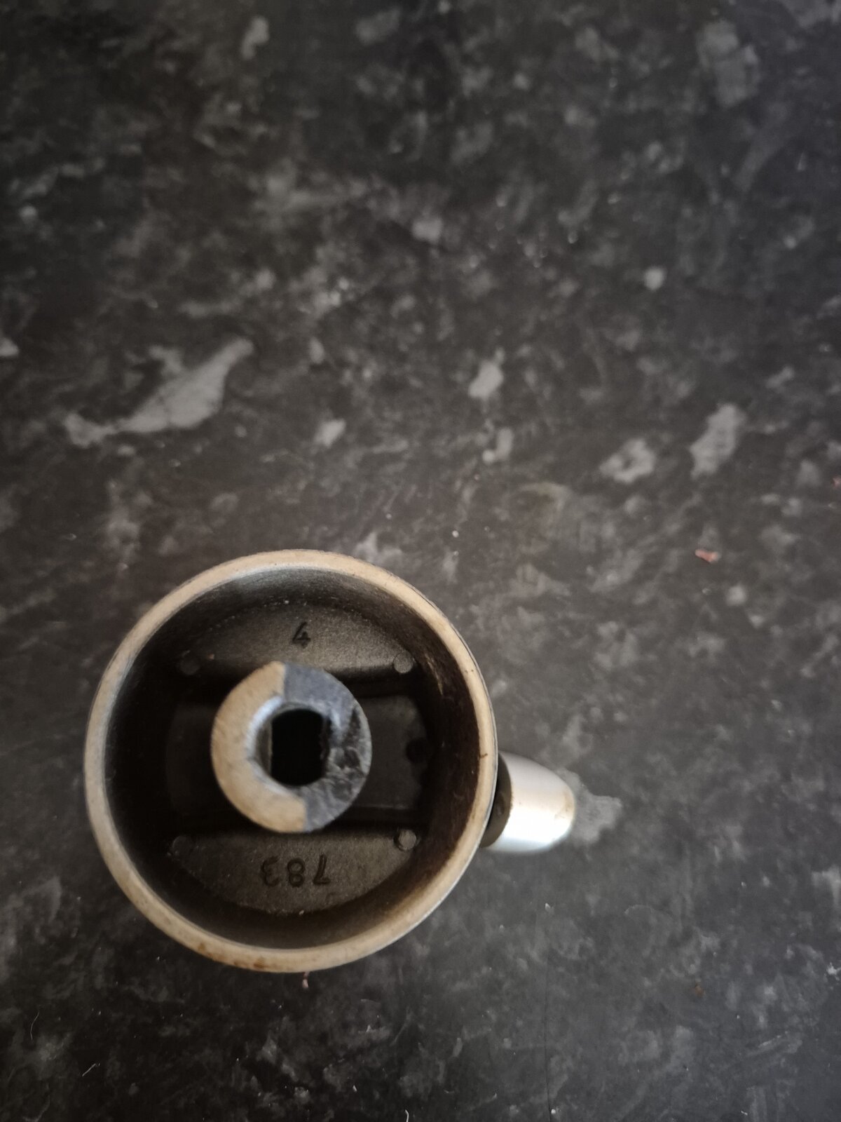

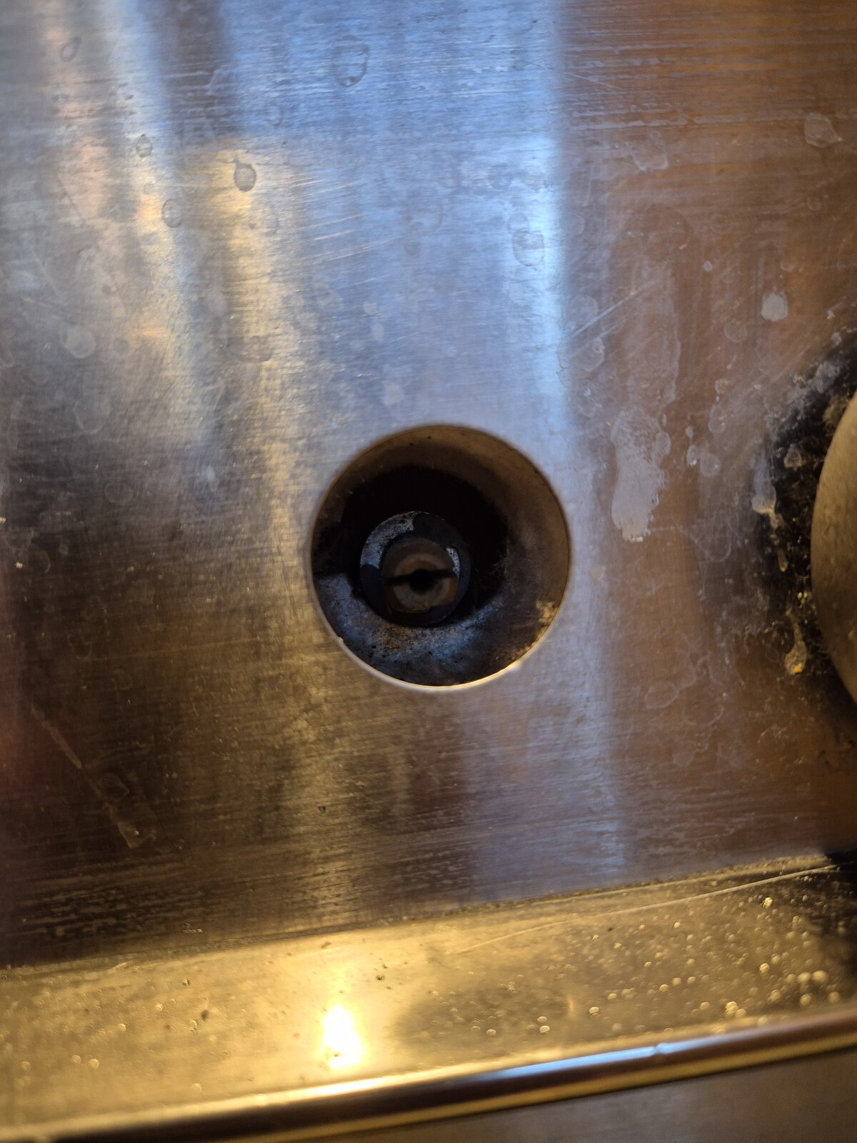

Hi, anyone that can help me out here? Is there replacements out there I can get to replace my broken stove knob? It broke off a couple years ago but haven't come to terms to replace it yet.
I am seeing you can get universal ones, would these 90% of the time just slot in?
From what I think I can see in your photo, you need a type of knob where the socket to fit on the shaft, protrudes below the knob. Like this style, but I am not recommending this particular one - https://www.ebay.co.uk/itm/31431389...Z2NESbNlBif2q08MV1qp6C3w==|tkp:BlBMUN6lvcy6Zg
The other style of knob, fits a shaft which sticks up above the plate, so the bottom of the knob is completely flat, which is of no use to you. If you are buying one, worth getting a full set, to replace all of them, for a match.

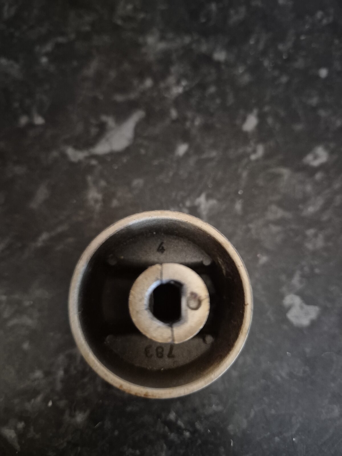

I have found the broken original piece, would glueing it together not work?
Unlikely for very long. There is usually a metal spring part, around the outside of the D, have you lost that?
Wasn't aware of the spring but nothing seemed to come off with it. I am not totally sure. I just needed something similar, I am not bothered if it is slightly different. Just want to make sure it is the right size.
