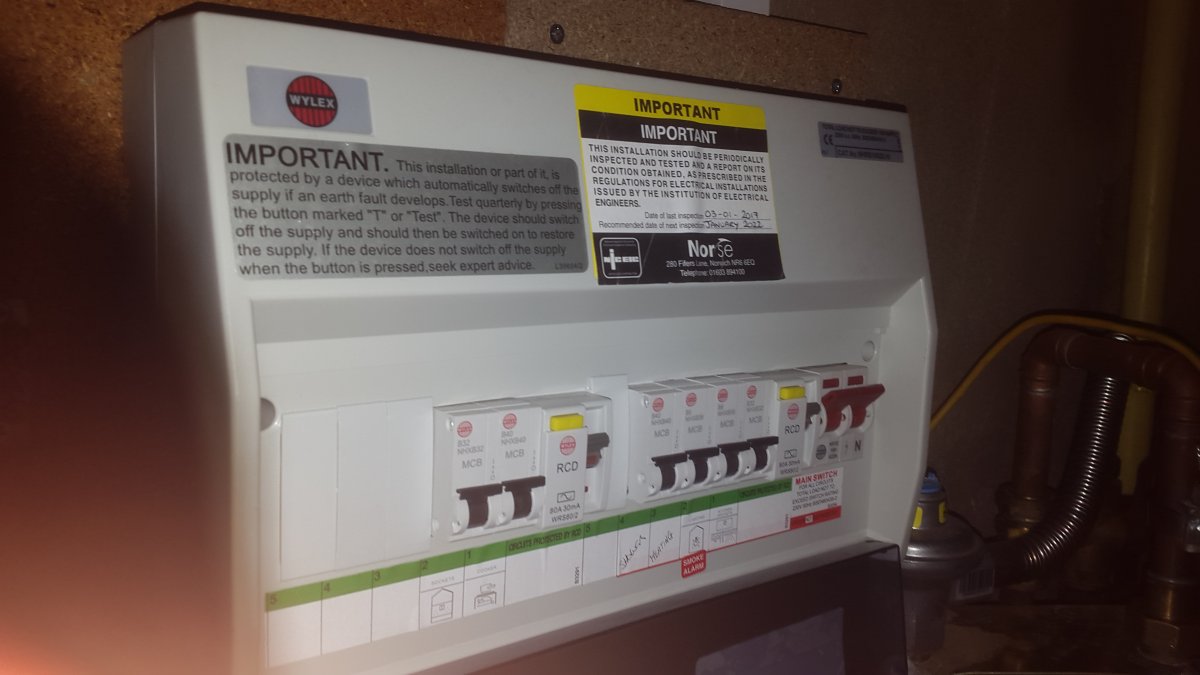

Hi everybody just got a cooker installed everything works fine except when I go turn the dial off to the fan assisted oven at the bottom it trips my electrics out not sure what's happening the lights to my home stay on but sockets become dead . I can turn it back on by the fuse box but not sure what's happening any advice would be great
I'm not sure it's connected via a box at the back of the cooker with a wire to the cooker this has a switch with a light on the wall .. this all goes off and then have to reset it in the cupboard where the box with all the switches are the people that installed it did the switches I have no idea when it comes to things like this the cooker works fine until turn that 1 oven off with the dial on the Cooker then it trips out
About 6 months old so not new no.. it was just installed today though and took a while I'm wondering if maybe it wasn't installed correctly would this cause this problem the top oven works OK and the 4 hobs would it be safe to still use these I have no experience with things like this so just looking for advice really .. seems odd how it's when turning off rather than on

You are not telling us enough for it to be diagnosed. IMO it is quite likely an RCD that is tripping, but you will have to repeat the test (do it in daylight) and describe the thing that trips, or post a photo for us.
It's possible that you need a cooker repairman rather than an electrician.
A photo of your whole "fusebox" would be very useful.
' have to reset it in the cupboard where the box with all the switches are
photograph it.
I'm not sure what an rcd is I can take a picture of the fuse box and I can try turn it on tomorrow and see what switches go off ill do a before and after picture . I'm wondering if maybe the switch on the actual cooker is faulty as this is the only thing that does it . I've literally just moved in so I'm trying to get it sorted asap. Would I be OK to use the rest of cooker ?

No problem, I have just realised you say when switched off ! I would suspect you need an electrician to complete an insulation resistance test to determine the earth leakage which is causing the trip is caused by the cooker alone and not something else, which is the culprit.
There is no point in leaving the oven open overnight as it is unlikely to be moisture if it trips on switch off.
