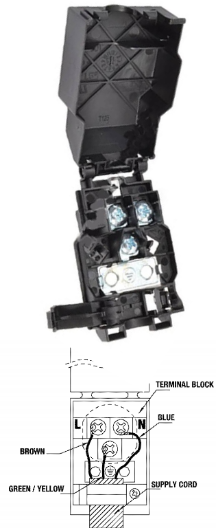

New oven to fit (https://www.currys.co.uk/gbuk/house...double-oven-stainless-steel-10207020-pdt.html) - was expecting to use the existing 6mm t&e to fit this but just checked under the wiring cover and it's just small terminals...
Firstly, this just look like a flex connection, certainly wont take 6mm t&e - how are they so 'small' these days? Manual says to use a H05V2V2-F cable.
Secondly, and more importantly, I can't see anything that differentiates live from neutral for the two connections on the the left (earth is marked in the centre).
Any idea (save taking the back off) how I identify L from N - is there a convention?

Is there not a wiring diagram in the instructions - or on the connector lid?
From what I can find it says it is 5.09kW (22A) so 2.5mm² flex would do, although it also says 30A power supply.
Thanks for the reply both. No markings on the lid, other than showing how to open the lid...
Nothing in the documentation.
We have a switched 30amp outlet there for a connection, I was just confused over the cable requirement and the obvious lack of wiring instruction.
The hob came today and that was pre-wired with a similar flex thickness cable - I was just expecting it to be thicker, previous oven was 6mm t&e ready wired, similar ampage. Hob looked like 5amp solid core t&e - I actually got more 6mm because I thought the job would require wiring and didn't think the 5amp I cut off would be enough!
Found this:
I don't know if it is correct.
The earth wire should always be longer than the other two so that it is the last to be disconnected should the cable be pulled out.
https://www.mybuilder.com/questions/v/38221/wiring-for-oven-terminal-block
Many thanks for that, not exactly the same but very close, will take a look at the others. Seems the same sort of design so would assume L\N are the same way around.
Fitted it today, took the back off quick to double check the wiring - is wired as your diagram notes EFLImpudence, many thanks again for looking for that. Got some of the recommended 2.5mm heat insulated flex from local Screwfix.
