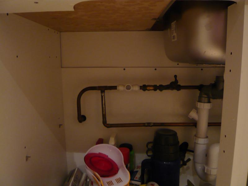

duly fitted the suggested push fit plastic iso valve.
This had been fitted in accordance with instructions
No it hadn't - there are no collet covers or collet clips.
[url=http://www.johnguest.com/linkpages/TechSpec9.html]John Guest[/url] said:
Use of collet covers or collet clips on fittings recommended.
Also, you let it freeze.
My 2 pence worth back on topic, use copper.
If you're arguing that copper is better, be honest - would you have a copper installation freeze without expecting damage?
Funnily enough, JG claim that Hep20 can absorb the expansion of freezing without rupture. The danger arises where there is nearby metal pipework or taps in the system.
3. Problem: Split fittings
Probable Cause:
Formation of ice within a system containing metal pipework, or adjacent to metal taps.
NB: Water freezes at 0°C and increases in volume until it reaches -4°C and 9% volume increase. Hep2O® pipe can absorb this volume increase without rupture, but if metal pipe or components are involved in the system, the extra pressure generated may occasionally be sufficient to split the fitting. Evidence: Splitting of fitting or fitting pulled off pipe after severe cold spell - deformation of grab wedge.
