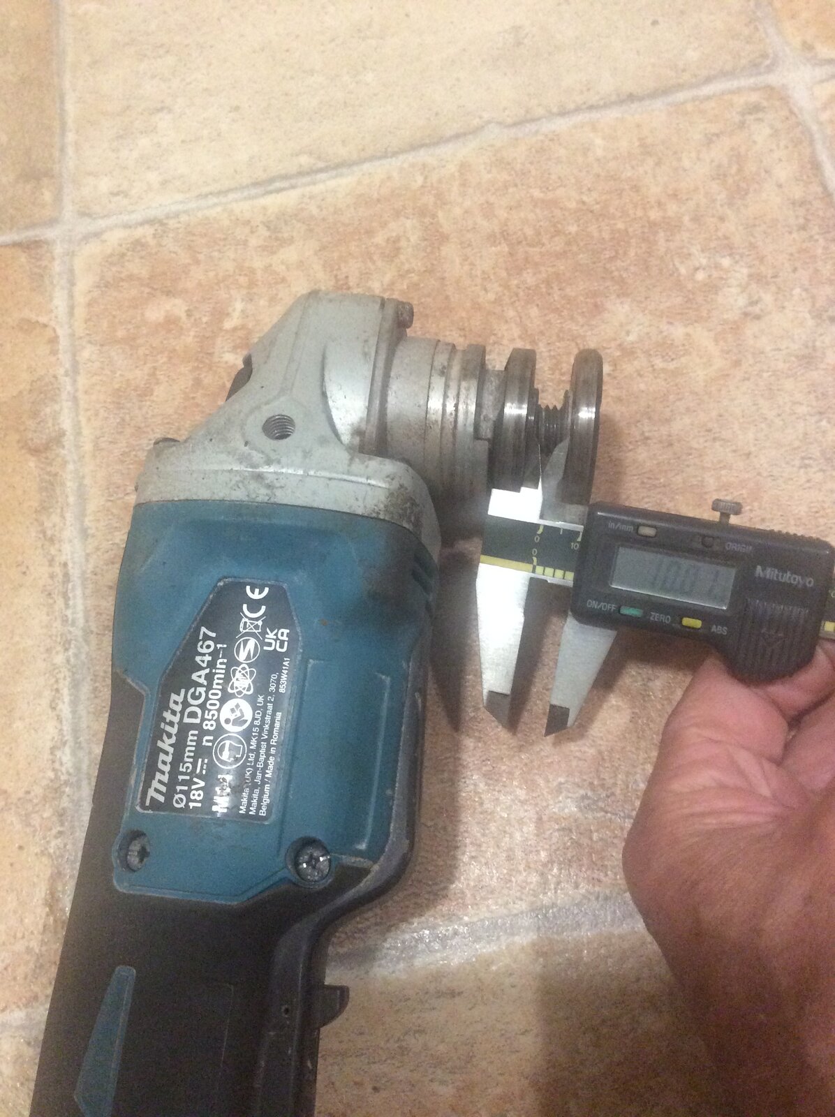

Looking at your model (the cordless, right? But perhaps the spindle size would be the same as the corded...) do you think an 8mm thick blade would safely fit?
Or if anyone reading has the Parkside 125mm Corded - or a Makita - would there be any chance of doing me a favour and checking?

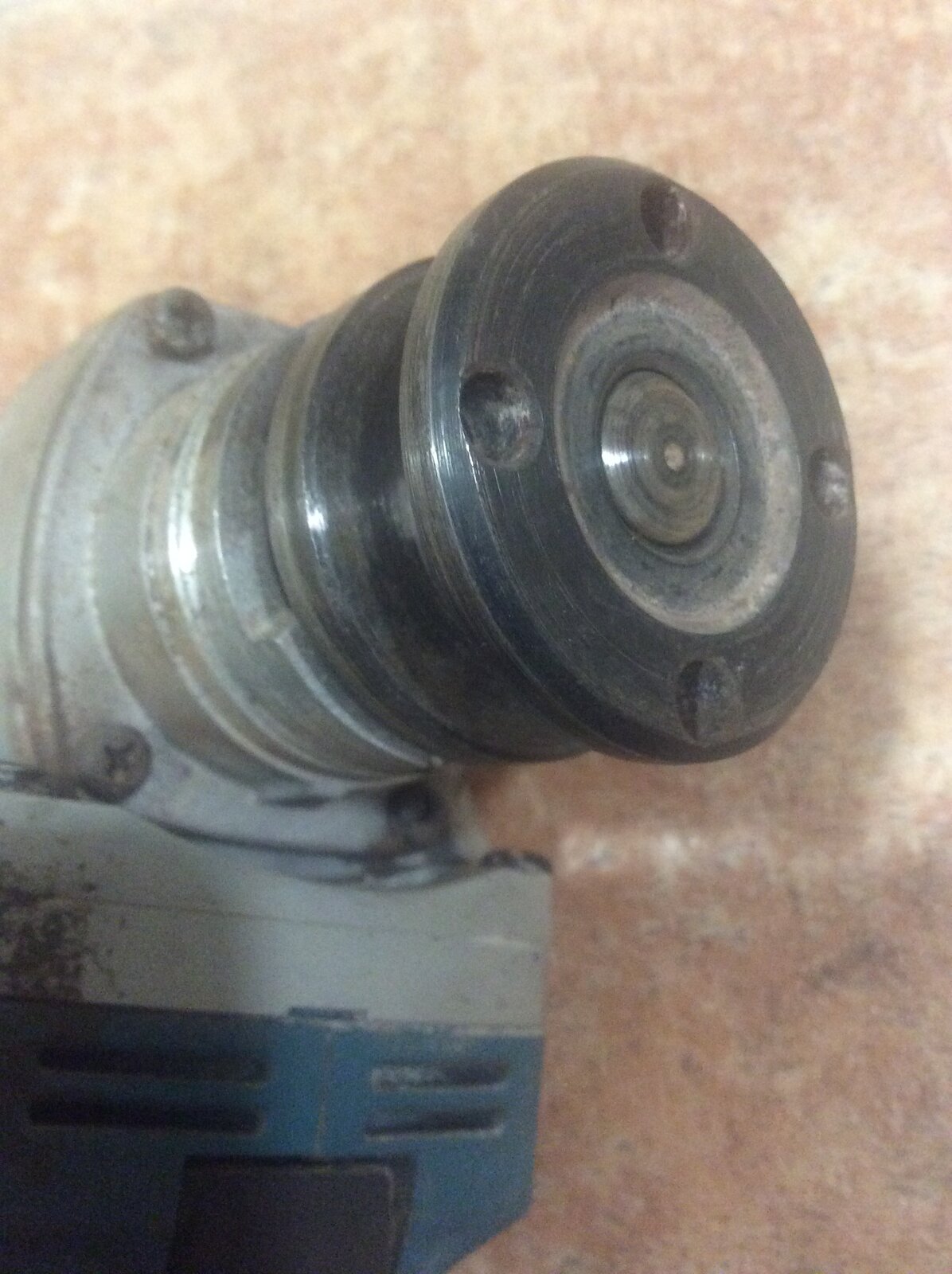

You'll get 10mm in the Makita with all the threads engaged
Thanks for taking the time to do that - very kind of you @lostinthelight :)
That's good news then. Does beg the question why the manual states a 6.4mm max. thickness. Safety margin perhaps? or some other reason? Guess we'll find out if my 8mm thick disc spins off into the ether!
Well the Ferrex could safely do 7mm, one thing to consider is the extra inertia of a thicker disk makes it more likely to unwind the clamp when you stop the motor. I have had it happen occasionally when stopping a 3mm disk.

Regarding fitting on the spindle.... I think I was a bit dumb yesterday. Looking at the mortar raking discs again, while they are 6.4/8mm on the outside at the diamond segments, the inner part of the discs is thinner. So should be fine.... Although still curious as to why they specify the low 3mm maximum in the Parkside manual.
Cheers
In that case even the ferrex would cope, as the 7mm is the thickness it can cope with at the clamp
