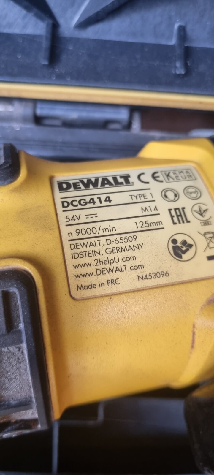

Not sure which 18v DeWalt grinder you have but my brushless one is a beast, easily as powerful as a corded including chasing out for lead, note the blade is 6mm thick
