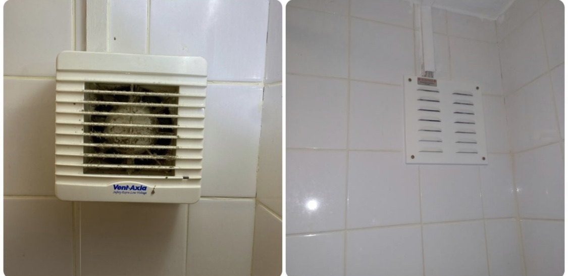

Correct containment?

Before on the left - after on the right, cable exposed as used original containment
Bathroom or kitchen - not sure
Correct? Pass? Lazy?
Not a sparks so asking the Oracles among you.

Could do with a closer picture to see exactly what's going on there, but the initial impression is it's just lazy/rough workmanship. There's nothing that visibly fails to comply with the regs but a closer look might reveal something.

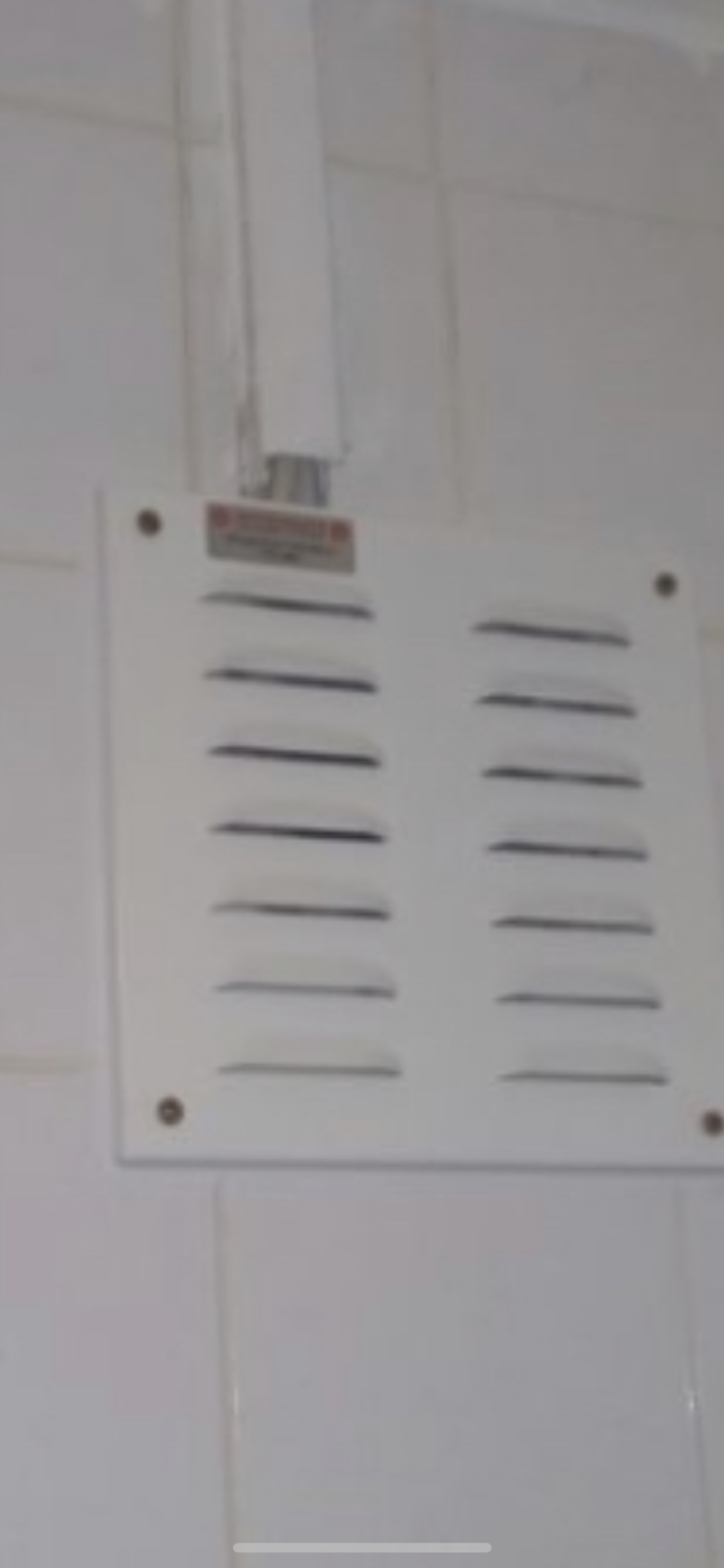

Any better?
If, as looks to be the case, the outer sheaths of those cable are intact, then there is no problem - it would be fine without the trunking at all (i.e. just with the cables clipped, visibly, to the wall surface).
