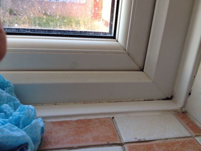

Correct Dow Corning sealant for the jobs?
2 Feb 2014
412
2
I've emailed them directly but the form seemed like a right mess so i'm not confident of a response. Certainly not a swift one for me to get cracking this week.
This stuff came recommended, but i didn't know there was so many different types.
* First off, i'm not fussy whether it can be paintable or not - it'll be staying white anyway so paintable sealant isn't a concern of mine.

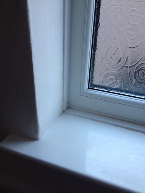

JOB1: Where the window frames meet the walls/wooden windowsill on the interior - the sealant has become either manky or loose or manky+loose. Needs digging out & renewing.
JOB2: Where the window frame in the kitchen meets the tiles - this sealant is manky & needs renewing.
JOB3: Where the tiles meet the kitchen worktop surface - needs renewing.
JOB4: The rear of the sink & where the bath meets the tiled wall - needs doing & re-doing in parts.
There's so many different numbered tubes though. I don't mind if i'll need to buy different ones as they're not that expensive, but obviously it'll be handy if 1 will do all jobs.
So with so many different numbers, which am i looking at?

Job 1
http://www.ebay.co.uk/itm/Wurth-Acr..._Body_Shop_Supplies_Paint&hash=item20c7bc8d95
Masking tape a nice straight edge on the frame, Seal it, Run your finger in both directions a few times, Then paint and remove tape straight away.
Most silicone's are going to go manky at some point so unless you plan on doing this every few years thats what I would do.

For sealing to PVC frame you want low modulus, neutral cure. Maybe something with mold resistance as well. Masking tape both edges.

EDIT: Photos oh where i'll be using it...
EDIT x2: After more googling i found that water/shampoo etc will react with the silicone which is why it goes black in the bath example.
I was wondering - just around the window frame will it still go black since it's not in contact with water, or does it just need the moisture that's in the air to turn it black?

Caulk once over painted is basically the same as any wall surface, Mold is possible but less likely, It also looks much neater, The Wurth sealant I gave you a link to Is one of the best quality caulks, It shrinks less than most and can be used inside and out.
