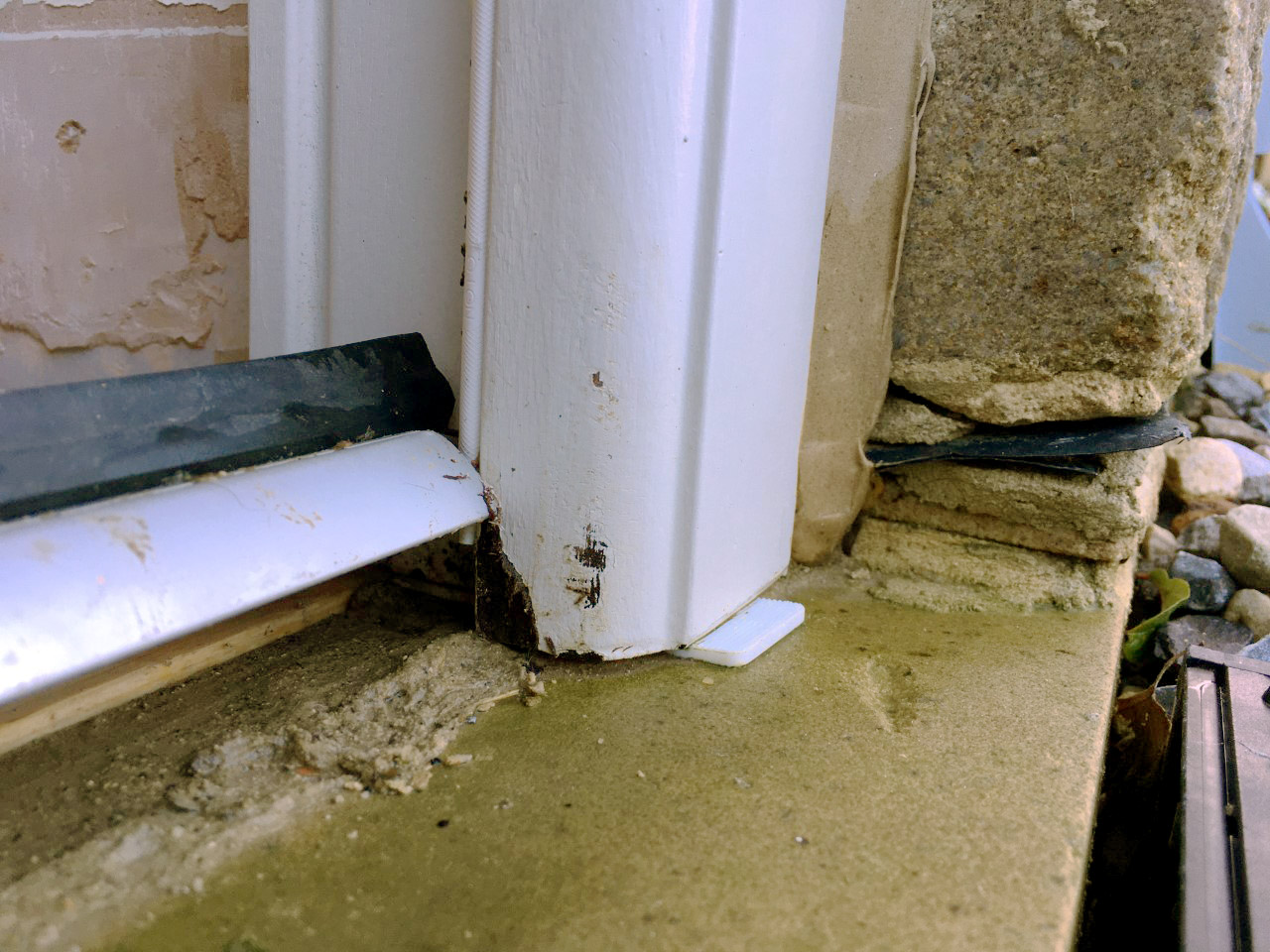

Then I heard our neighbour's solid wood parquet flooring has been soaked, not happy to DIY it. They rang the developer/builder, and the builder's people were round this morning "fixing" her threshold. Remove screws, silicone bead underneath, then refit, and a silicone bead across the front.
One thing the neighbours had mentioned was the lintel was angled back.
Checked mine and it was angled back too.
Mine was loose, in this weather wind was blowing between the aluminium bar and the wood underneath, and if I pushed down the draft would disappear. This was causing condensation to forum, but no actual damp ingress.

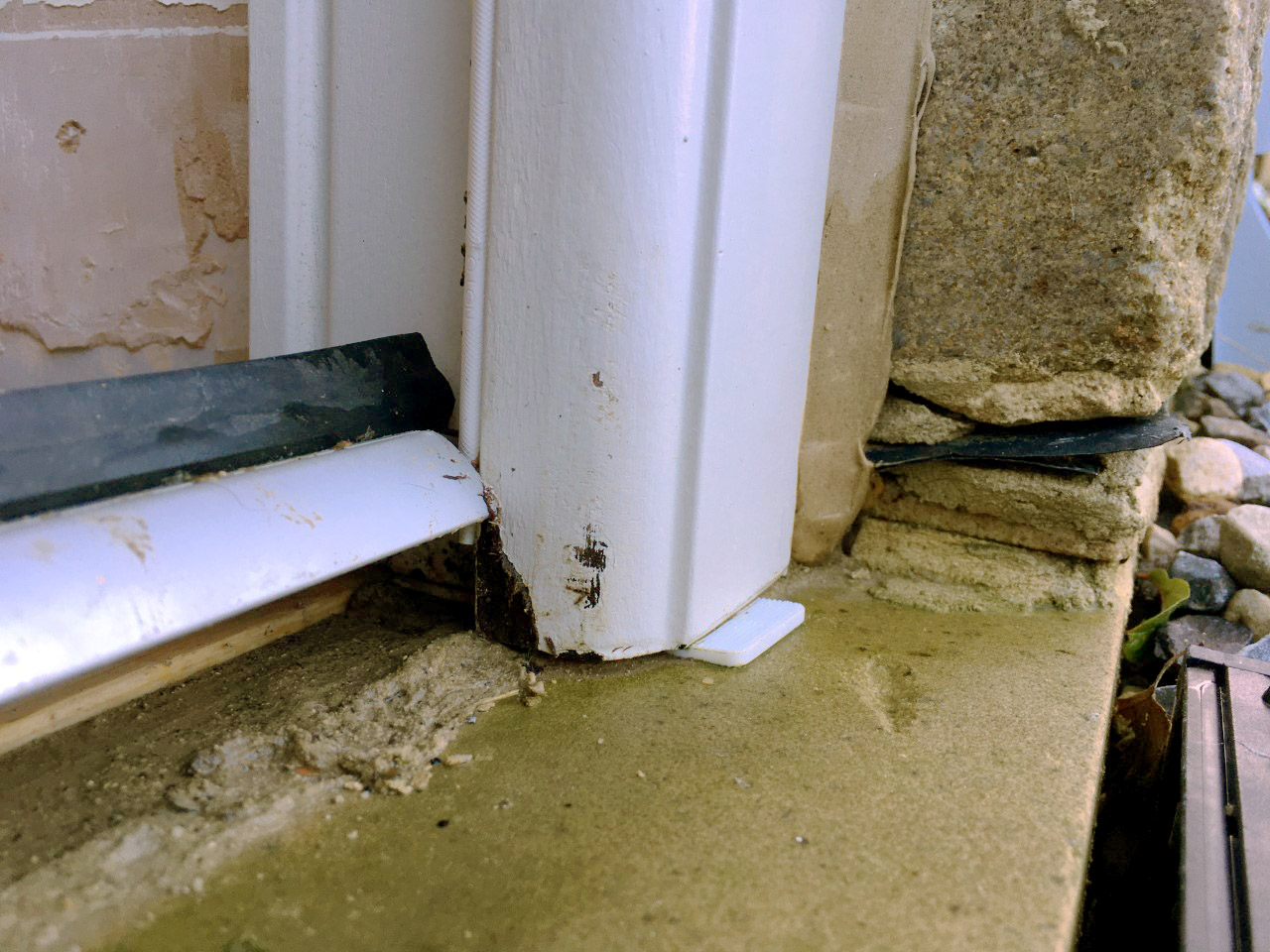

I decided to just lift it a bit to take a look as it was already loose, but it kinda just lifted up, it was super easy, barely an inconvenience.
It seems bad practice to have the wood frame touch the stone(?) sill long-term?

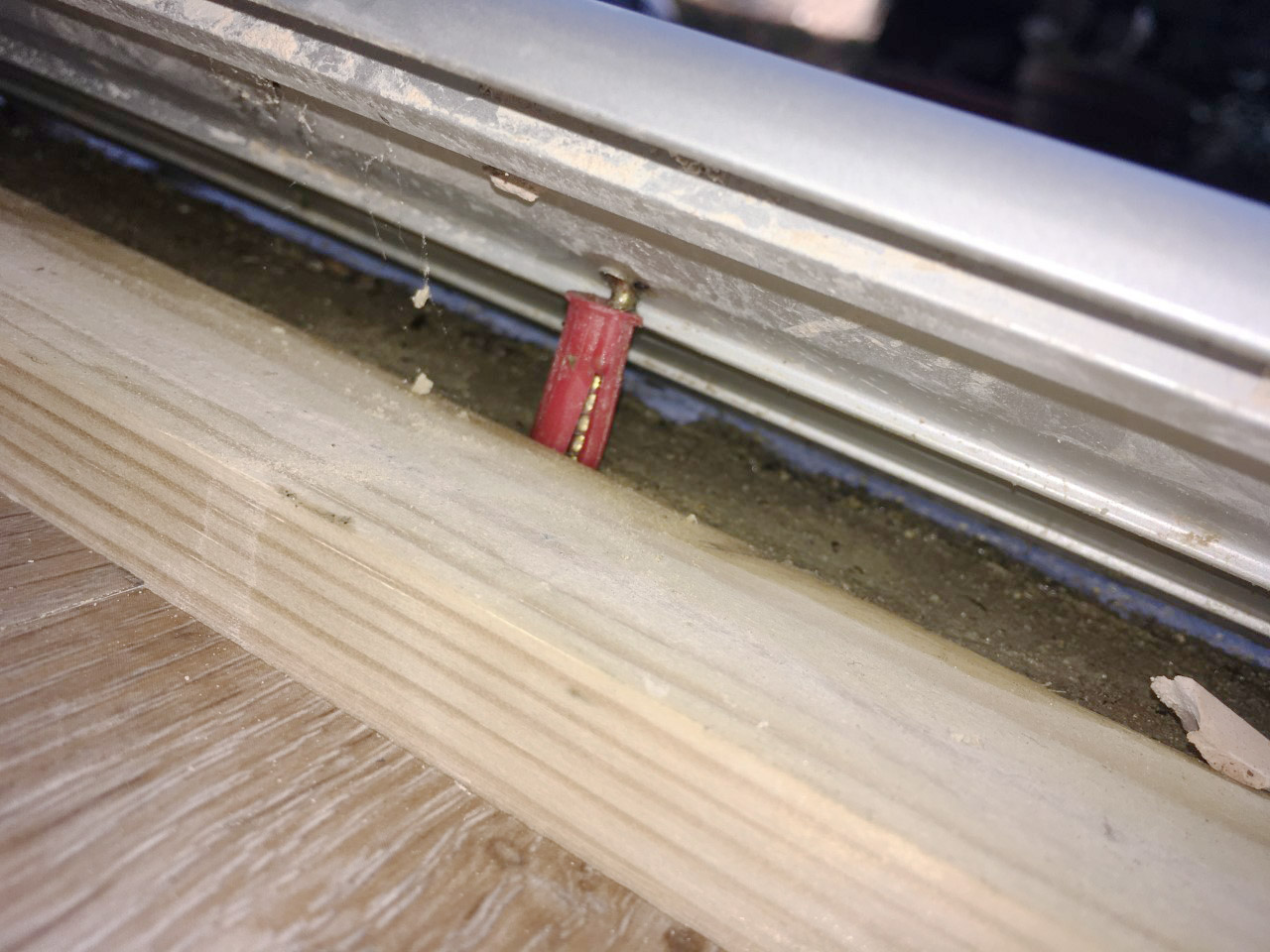

More context. Drain bedded on concrete, big gap to sill vs neighbours. Drain clear.

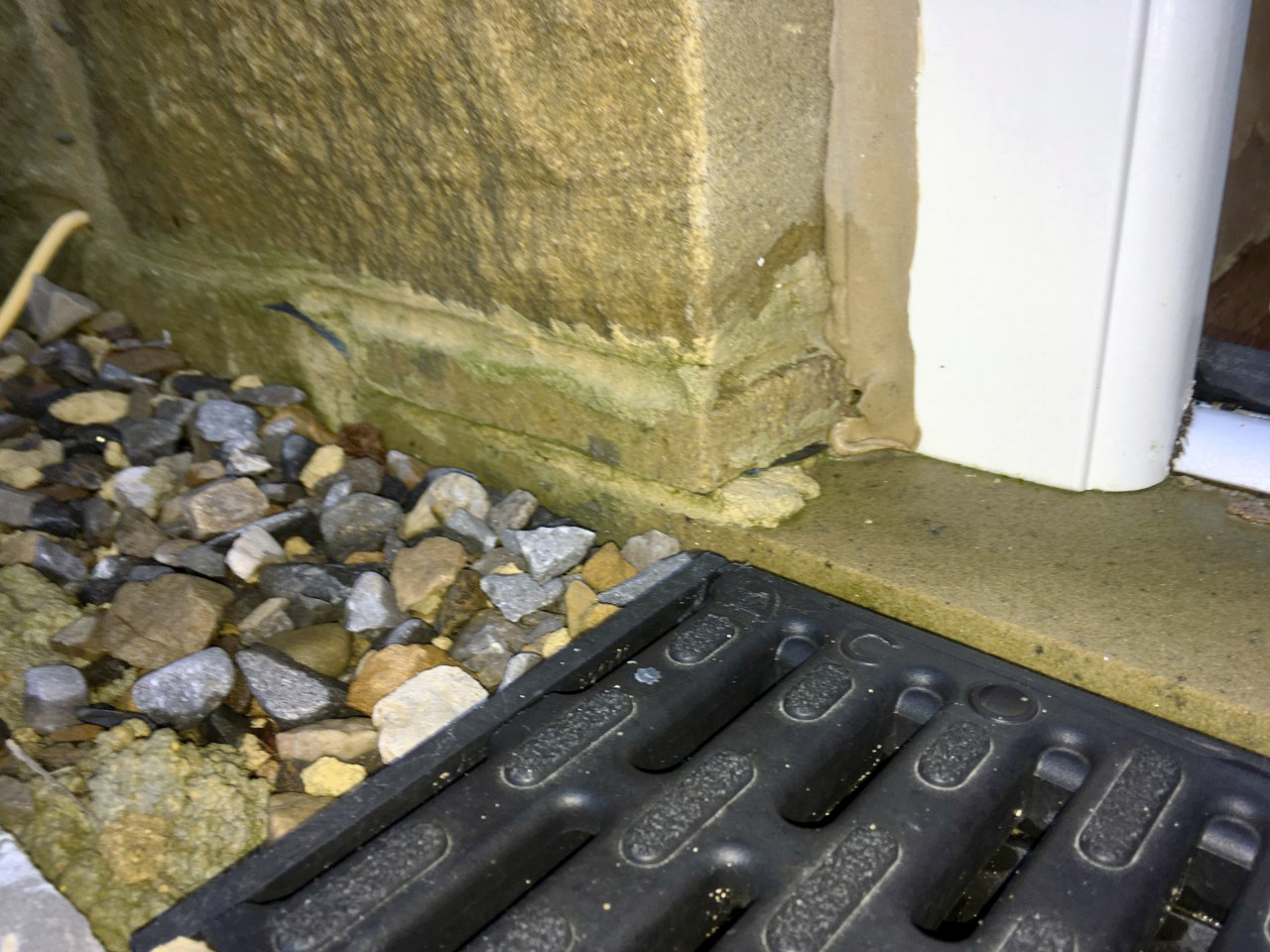

More context. Skirting off due to fitting LVT.
Timber sill on interior is dry. The neighbour's one looked soaked.

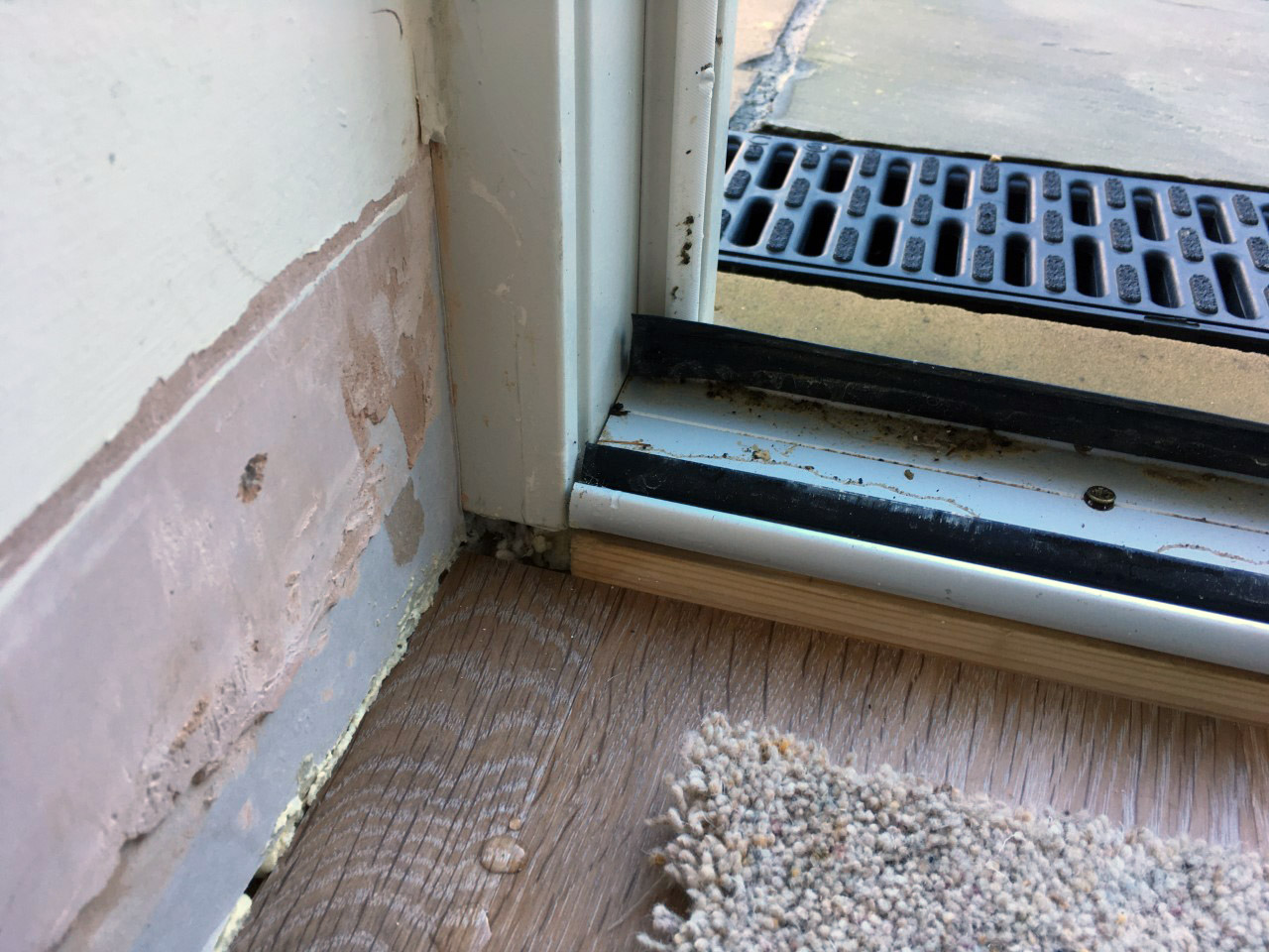

Screws don't actually go into the wood sill, but into the gap between the stone sill and the wooden interior sill.
I've no idea how the interior wood sill is fixed down.

Does this all look standard practice for current building approaches?
Anything missing that should have been done?
What's the right way to make good?
My current plan is to do what the builders did next door and run a fat bead of silicone on the stone side, in what looks like a groove behind the leading edge of the aluminium threshold, to stop water there.
If I clear the cavity between the stone sill and wood sill of building debris, is that best left as an air-gap?
The builders next door also ran a small clear bead across the sill leading edge, but this seems unnecessary assuming there is some seal somewhere under the sill on the stone side?

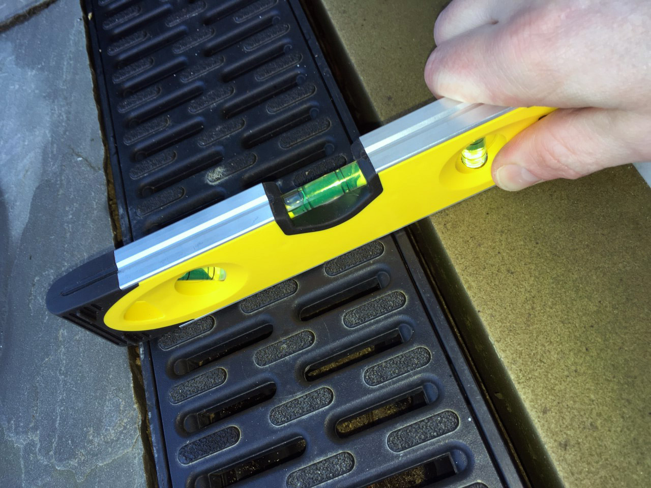

Anything fundamentally wrong with this that would ideally be rectified? Ie, should that sill be level?

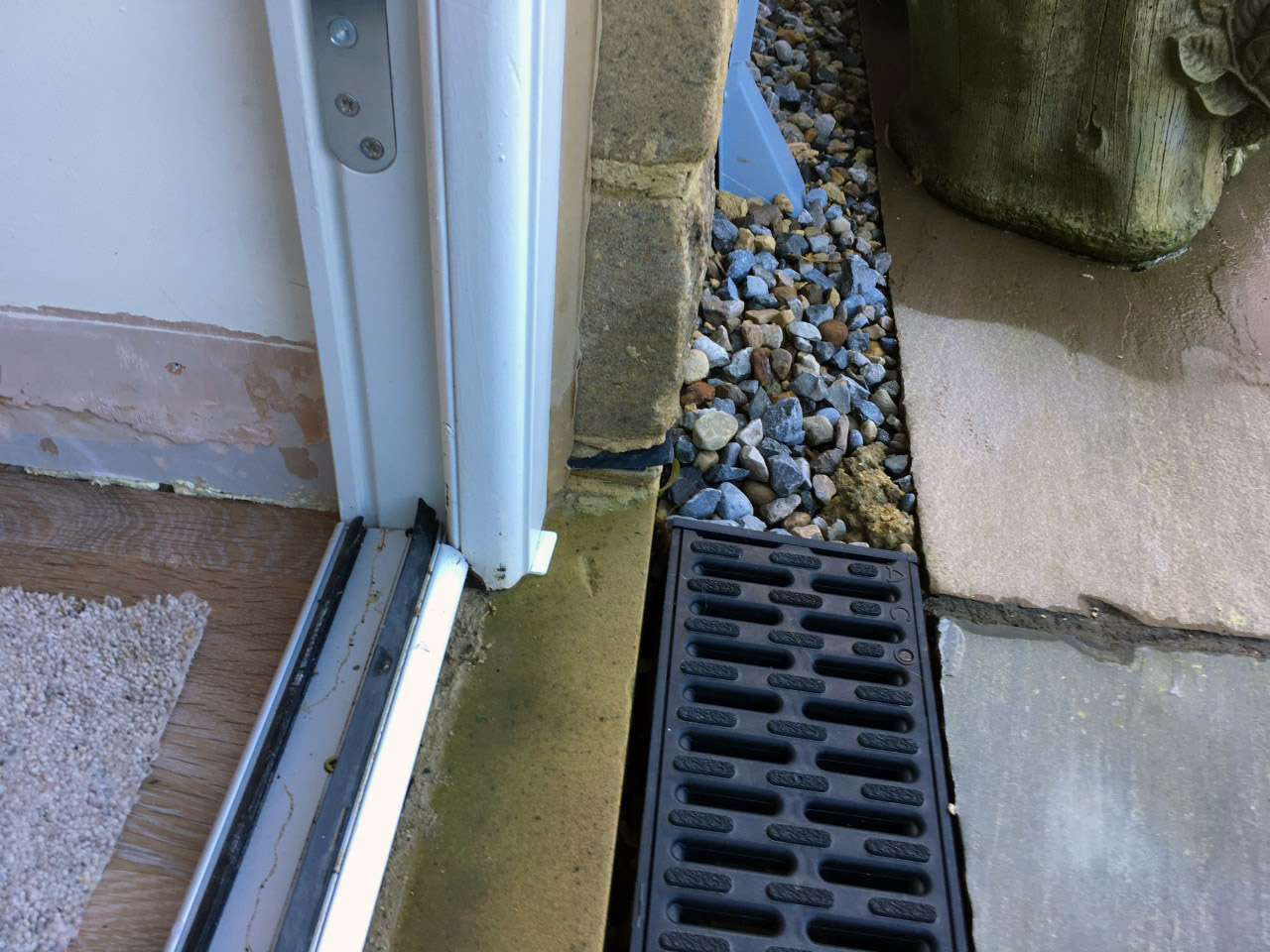

Is there any reason the DPC should dip down here? It looks like a damp bridge as it is.

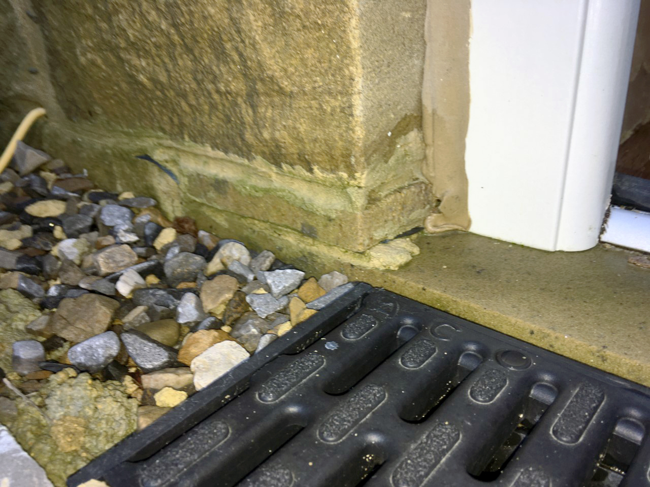

![8.jpg 8.jpg](https://cdn.diynot.com/data/attachments/261/261963-711efd8a400860e4221f2ea51302e445.jpg)

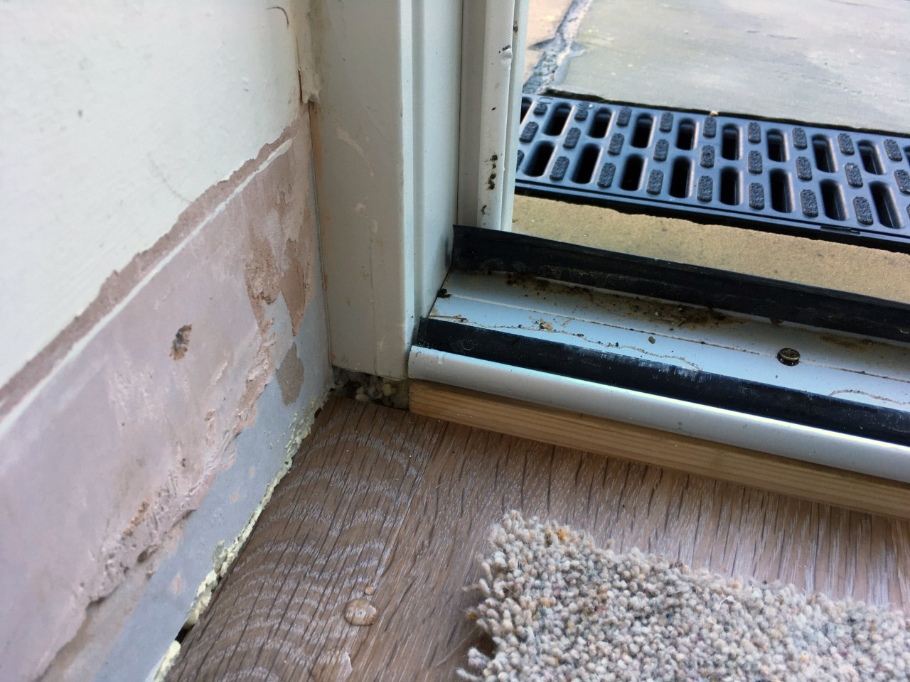

![2.jpg 2.jpg](https://cdn.diynot.com/data/attachments/261/261959-8d8b066605646edd14de9a943f50619f.jpg)

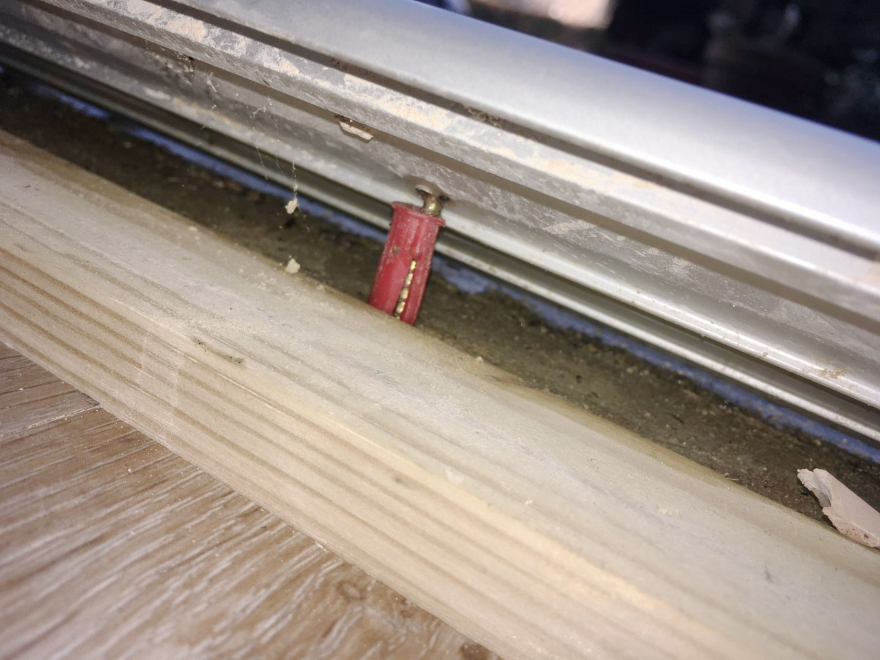

![3.jpg 3.jpg](https://cdn.diynot.com/data/attachments/261/261960-ff22c17d7449611f3232e776def5d768.jpg)

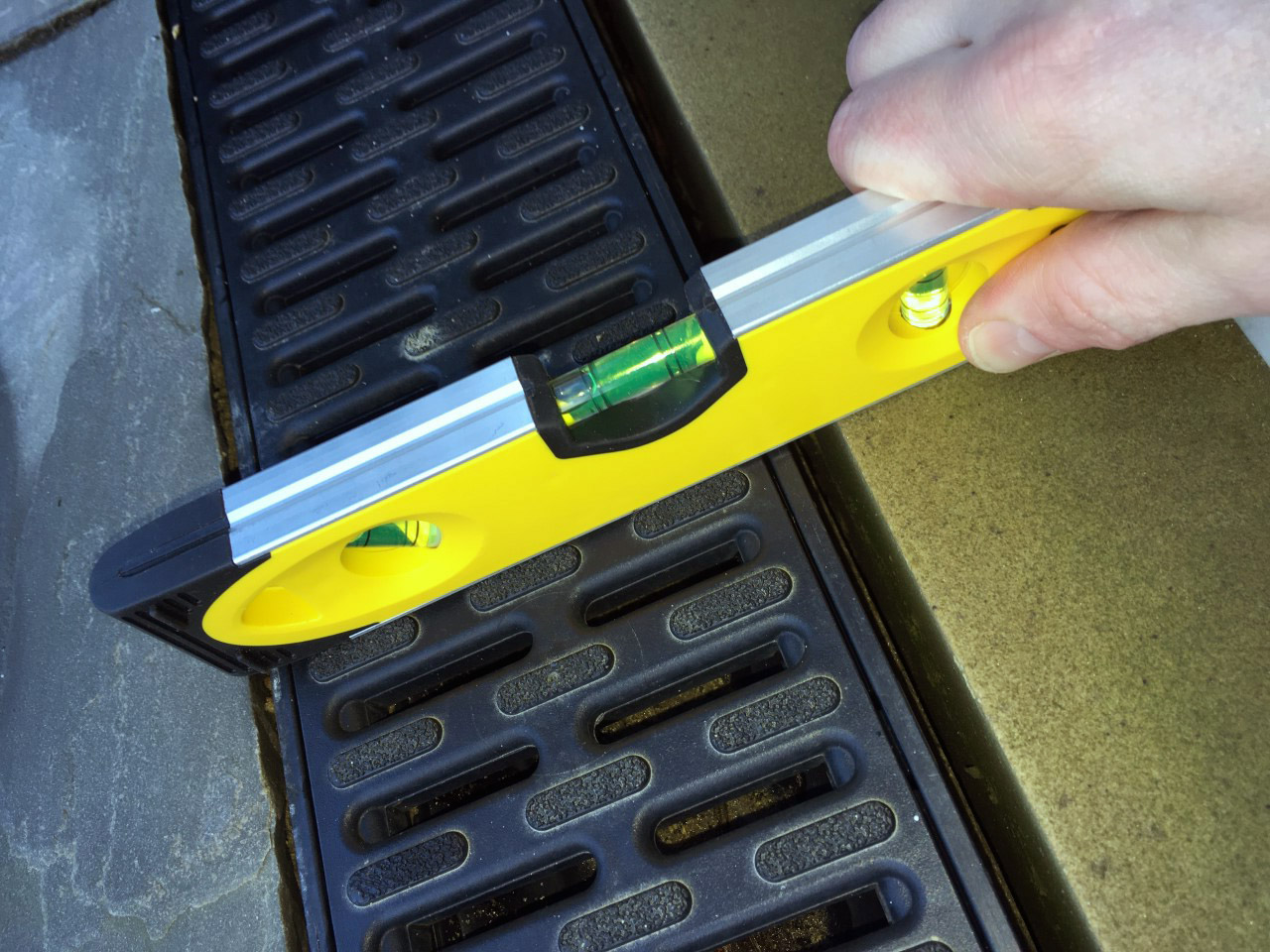

![5.jpg 5.jpg](https://cdn.diynot.com/data/attachments/261/261961-fed46c28ec935552bf0711d1ee979595.jpg)
