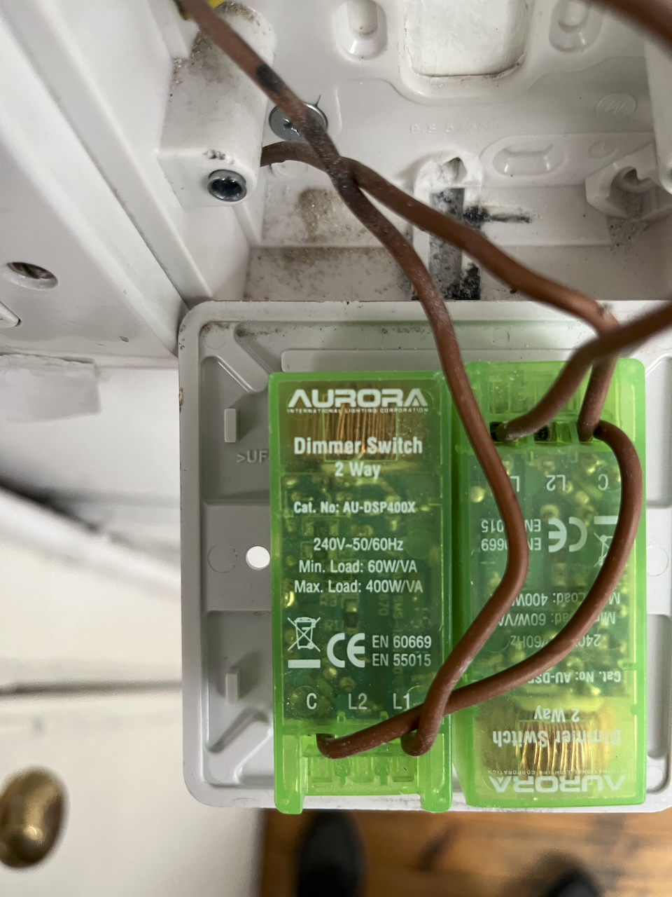

Hi. Some advice please.
Are these two switches correctly wired for 2 tracks of LED spotlights (6 spotlights per track).
One is giving trouble, so I will replace it with:
Aurora AU-DSP400X Zero Cross Rotary Dimmer Module​
Quickfind : 28012 SKU : AU-DSP400X
Might as well do both, I am thinking.
Many thanks.

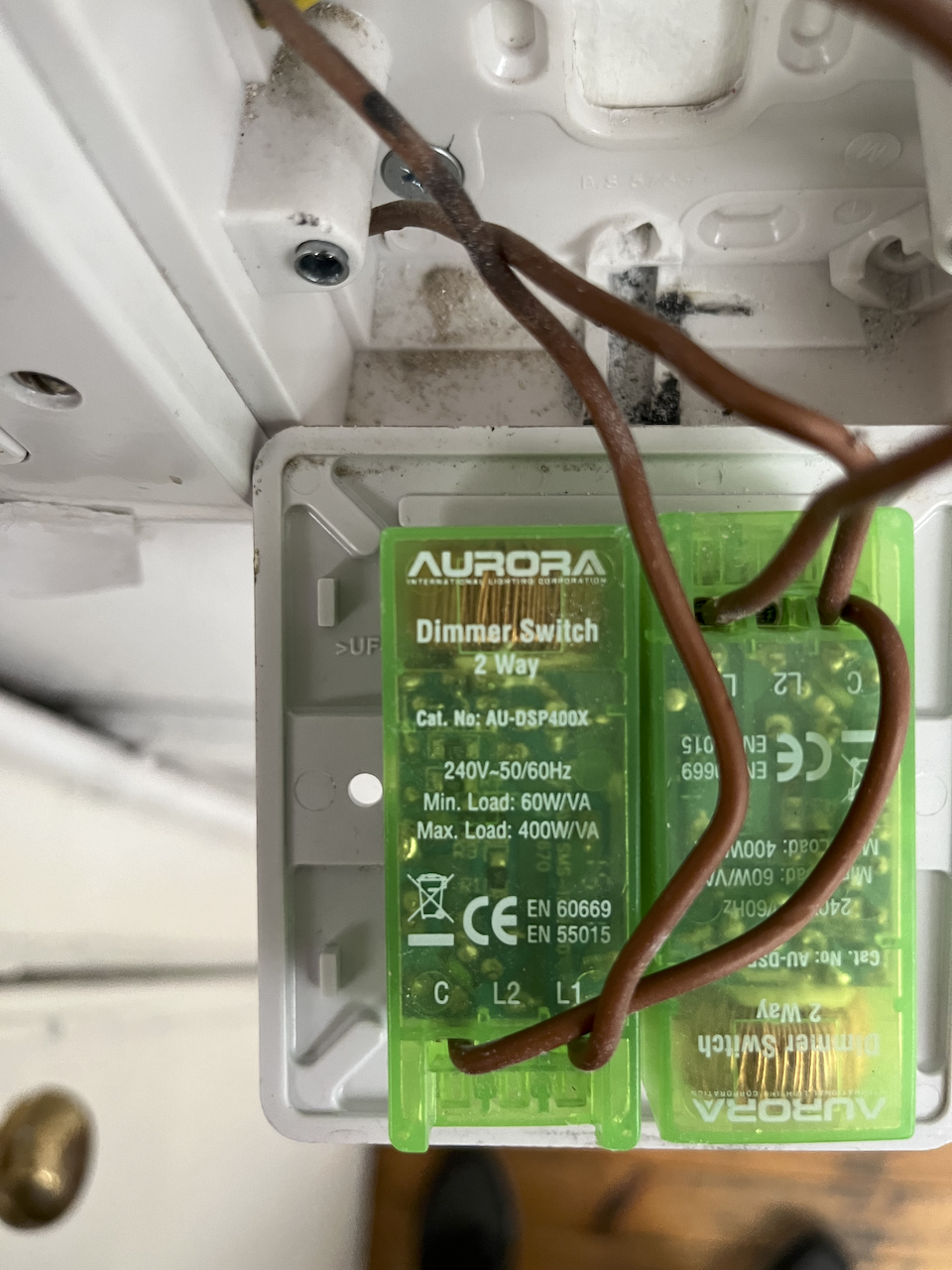

Without knowing which wire is which, they appear to be wired correctly; they are both wired the same.
As one is working properly we might presume it is all correct.
The dimmers shown and the one you intend purchasing appear to be 60w minimum load.
Your 6 spotlights are unlikely to meet that requirement unless for led loads the dimmer rating is different.
