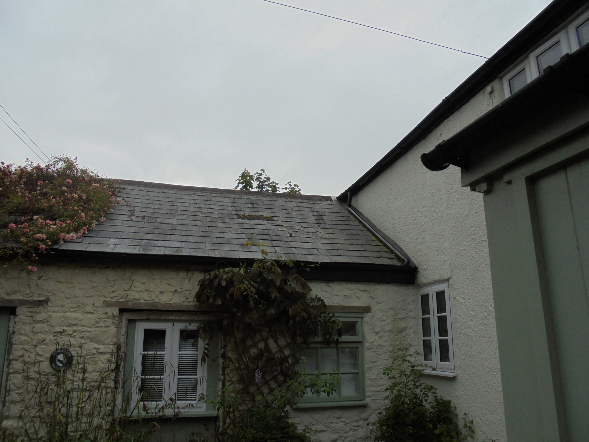

Took me a couple of days to take the paint off this wall for a customer.
Used a needle gun, but it can only be used on really hard stone. This one is chert which is really hard
Nice job
I was told i could use a needle gun on the main stone but would have to buy a air compressor and gun what type of Air compressor would you recommend to use with a needle gun i shop on eBay allot.
