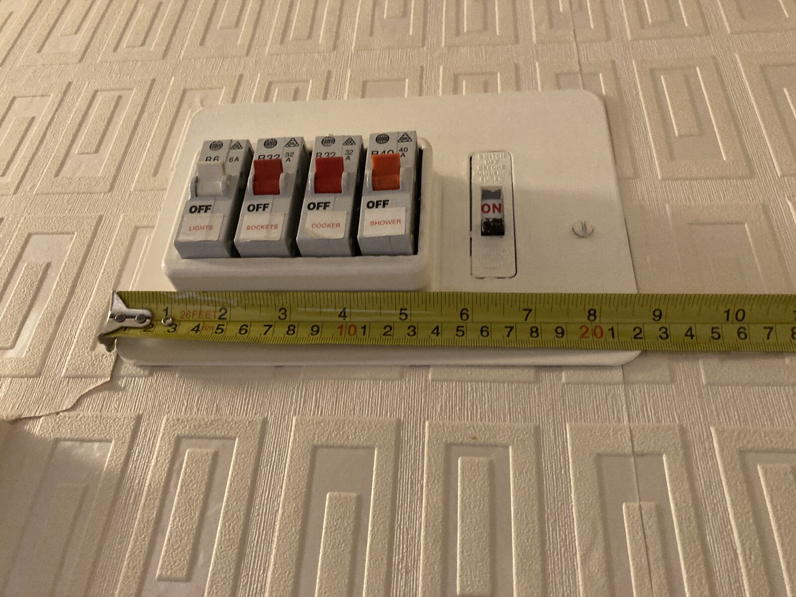

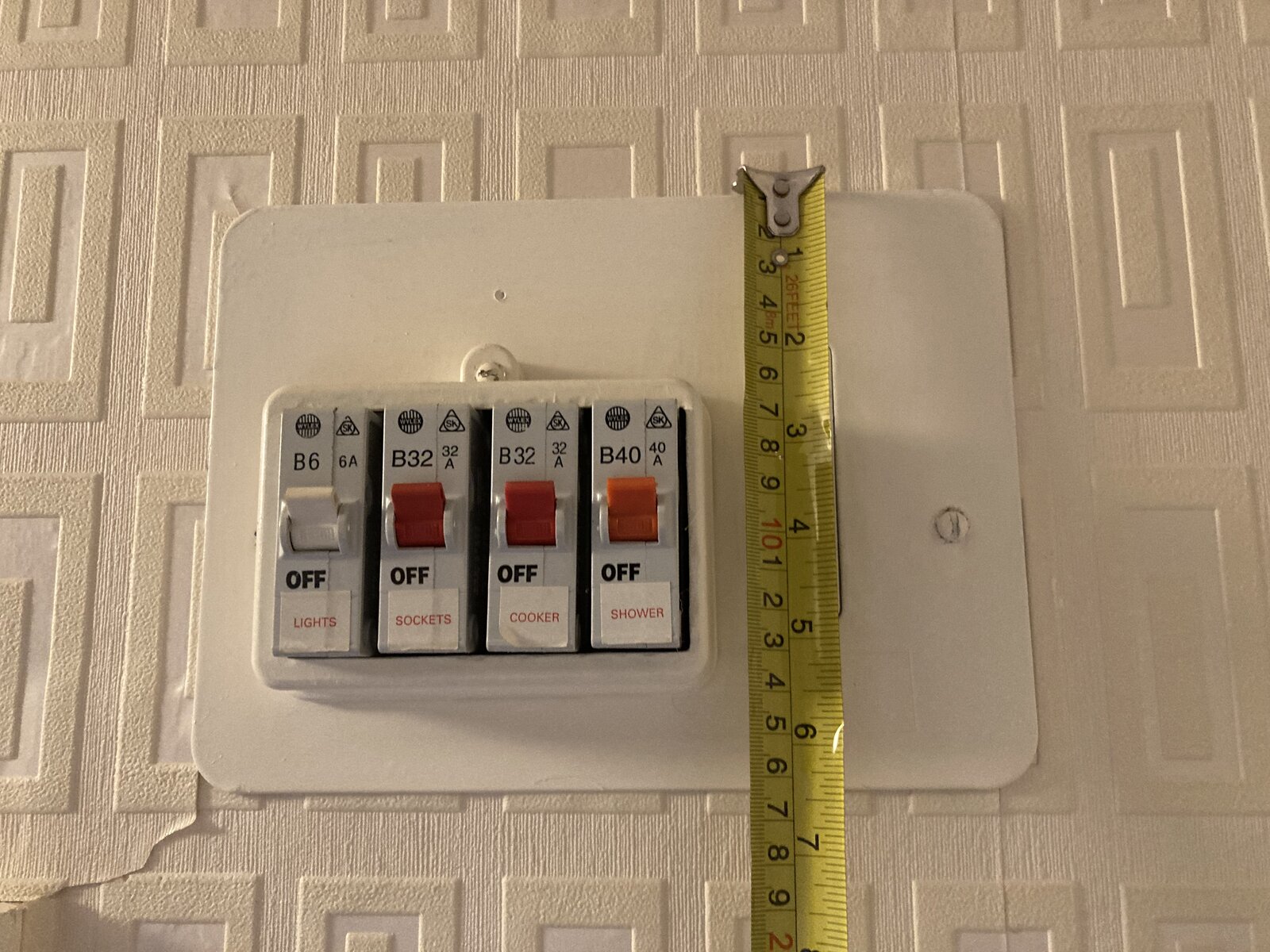

Hi,
I have just got a flat and think i want to have the consumer unit replaced, purely owing that it appears quite dated. the wiring was installed in 1987 ish, everything works fine. Is it good practice to replace this unit below?, and if so I wanted some advice on what consumer unit type I ought to have someone fit in advance of contacting an electrician to do it, as i understand there are various types of circuit protection devices?
thanks for any help

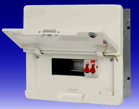

Cheaper makes like fusebox don't tend to make so many flush units, Contactum do however, this one upload_2022-2-28_15-9-26.png £60.60 and type A RCBO's £17.10 each, SPU £45 so £174 for the box, plus glands and grommets etc. With one spare way.
Personally I would want 8 way and have some room for more. Quoted TLC prices. Dimensions: 6 way.
Width: 299mm.
Height: 262mm.
Depth: 100mm.
Will depend if it can physically fit.
The consumer unit pictured is a "wylex standard", very common for many years and Wylex coninued to support the range even many years after it was effectively obsolete. Even today you can still buy replacement MCBs.
The main problem with it when judged in the context of current editions of BS7671, is it has no provision for RCD protection. Current editions of BS7671 require RCD protection for nearly all domestic circuits. You could potentially add RCD protection upstream, but that leaves you will the whole property on a single RCD which is considered undesirable.
If you are planning to live in the property yourself then there is nothing forcing you to update your installation, however you are likely to find it difficult to find electricians willing to work on a circuit without first bringing said circuit up to current standards in terms of RCD protection.
If you are planning to rent out the property, then you are subject to the newish laws on landlord electrical inspections. The law itself is not super-clear but the common interpretation is that a "satisfactory" EICR is needed. For an EICR to be "satisfactory" it must have no C1 or C2 coded defects. BS7671 doesn't specify what code to give to any particular defect, but guidance from the electrical safety council is that lack of RCD protection for sockets that can reasonably be expected to supply equipment outside the equipotential zone (i.e. outdoors) should be coded C2. For an upper floor flat it could be argued that no sockets are reasonably expected to supply equipment outside the equipoential zone, but for a house or ground floor flat I don't think that argument can reasonably be made.

thankyou so much for all of the replies, this has really helped understand what the requirements are and consider what i should buy. I've decided to purchase the item myself from TLC and will take the cost of the units out of the equation.
i went for a flush 10way, with SPD, and have populated the two spares that will exist with a 32amp and 16 amp RCBO. it was 226.77 all in delivered. the unit is around 50% bigger than the old one but its a stud wall so should be ok to fit in, look ok and and make good afterwards.
great result and thankyou all again, i came close to getting the wylex but its tall and i figured the majority of existing cables will come from the bottom in this instance so wanted to expand horizontally moreso than vertically.
