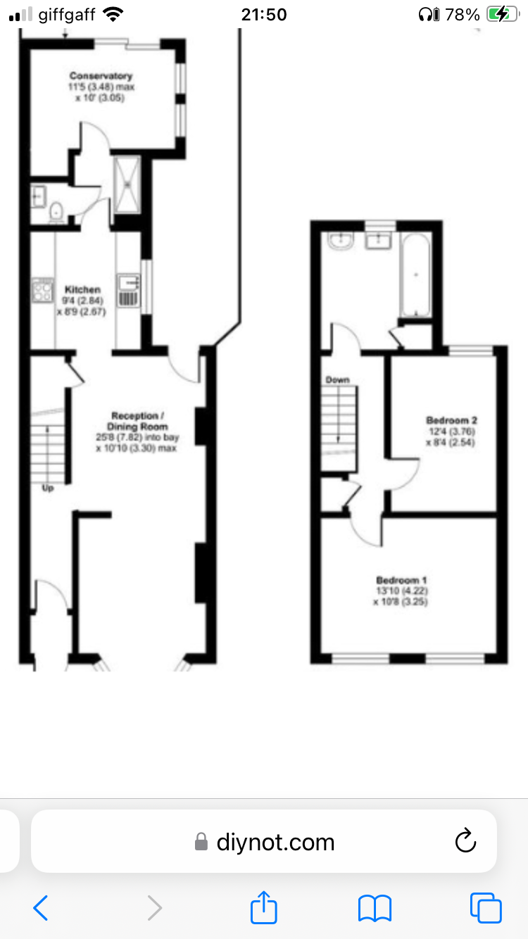

We live in a two bed Victorian terrace, we are end of terrace. We are hoping to add a third bedroom. Can anyone advise if we may be able to build up on top of the ground floor extension? On the floor plan it says conservatory but this is a solid brick extension. What would we need to do for this process? We can’t see neighbours who have done this but hope it could be an option so we could shift the bathroom to one side and add another bedroom to the back. Many thanks for any advice
Floorplan here

You'd need planning permission which I doubt you'd get.
If you do then if the founds are ok then build away. Maybe get a trial hole dug before you do anything.

The first thing I'd do is check the foundations to see if they are suitable. If not, then you can plan a whole new extension and extension footprint, without being constrained to what's there. Bare in mind the new cavity wall thickness/Part L reg's etc.

The only way to know for certain is to formally apply for PP. No one can tell you otherwise: even pre-app advice isn't binding.
Thanks - in terms of the planning permission application would we need to get an architect to draw up plans before submitting? And is there a cost to applying for planning permission? Sorry we are very new to this kind of thing
You'd be looking at anything from about £500 for someone doing private jobs to a couple of £K+ for a proper firm to put some drawings together, local authority planning fees are on top, they're £258 atm but about to go up to £528 as of April 1st. But if you're looking at doing this extension then you may as well consider a loft conversion.
If you are any good at drawing you can do them yourself. They don't have to be fancy CAD drawings and you will find guidance on the council's website as to what is required. Generally elevation before and after. floor plans before and after, section through works (all 1:100) then site or block plan (your garden including where neighbours adjoin (1:200) They usually like a roof plan (despite the roof shape being clear to anyone who can read a drawing which one hopes would be a prerequisite for being a planner): I do these at 1:200. Finally you'll need an OS plan at 1:1250 showing your place in the middle. You may have one in your deeds or plenty places on line (around £25-30)
RTPI Town Planner here, I would advise you use the website planning geek for help on householder PD allowances it’s pretty useful and is still used by many in the industry.
In order to ascertain whether it would be PD or not we’d need more details on location postcode etc (please don’t post this publicly), depth of extension at ground floor (anything over 3m from original house renders PD route at first floor null and void here).
