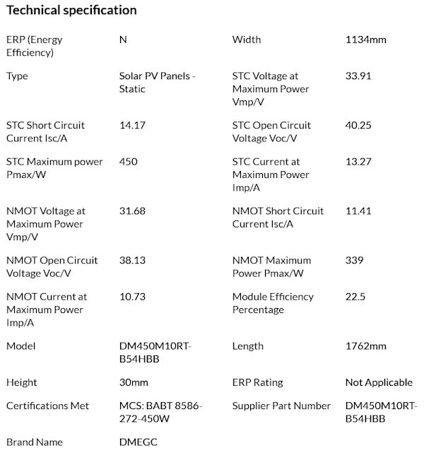

Hi, i have an inverter that is a Growatt 6kw with a max 500v input & 150v start up & the panels are all as per spec below. I have 10 panels & would like to wire them in 2 series of 5 = 10 in total. Which i think is 5x40.25voc = 212.50v Is my figures correct for my inverter & should i take any other things into account. Thanks for your help.

Are you doing two strings because of the possibility of shading on one set but not the other?
Hi, no shading. It was a case of a little bit of future proofing if it was ok to do. I will have a permanent amp/volt meter on each string to keep an eye on things & if any problem, & its far easeir to pull 5 apart than 10 when X amount of feet up on a roof.
