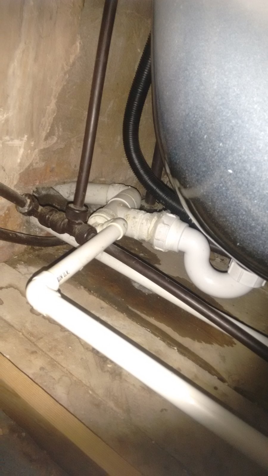

Bath waste installed without rubber seal in place.
Leaked.
Council plumber No 2 couldnt see problem but cut cut off pipe near the tee in the process and attempted to seal the stump with boss white.
Leaked.
Council plumber No 3 couldnt see problem but wrapped some ptfe tape round the thread just in case.
Leaking.
Boiler condensate has to flow uphill to reach waste pipe.
Exit hole not made good and snow gets in under the bath
Tenant in dispair
Its all solvent welded so Im going to renew the lot with a
new trap and pipe straight out though the wall and the condensate kept separate until outside (where the pipes all fall to a hopper)
I need means of coupling two potentially different types of overfow pipe WITHOUT solvent weld

Tenant cannot afford to pay for repairs(should not have to really)but dreads what Council Plumber No 4 will do.
I have some cheap 22mm push fit similar to the black 15mm in the photo.Before I have to wrestle the grab rings back
off ,any guesses to would this seal just enough for the boiler condensate.

I sympathise with the tenant - I was a "council" plumber ( Housing Association) until Maggie decided it was cheaper to employ outside contractors. The FACT is - unless you are a Registered Gas Installer you must not touch the condensate pipe - you may do work on the waste pipe etc. BUT the Council need a rocket up their arses, and to be told of the facts - involve the local press is a good idea;) I know what I'd do
