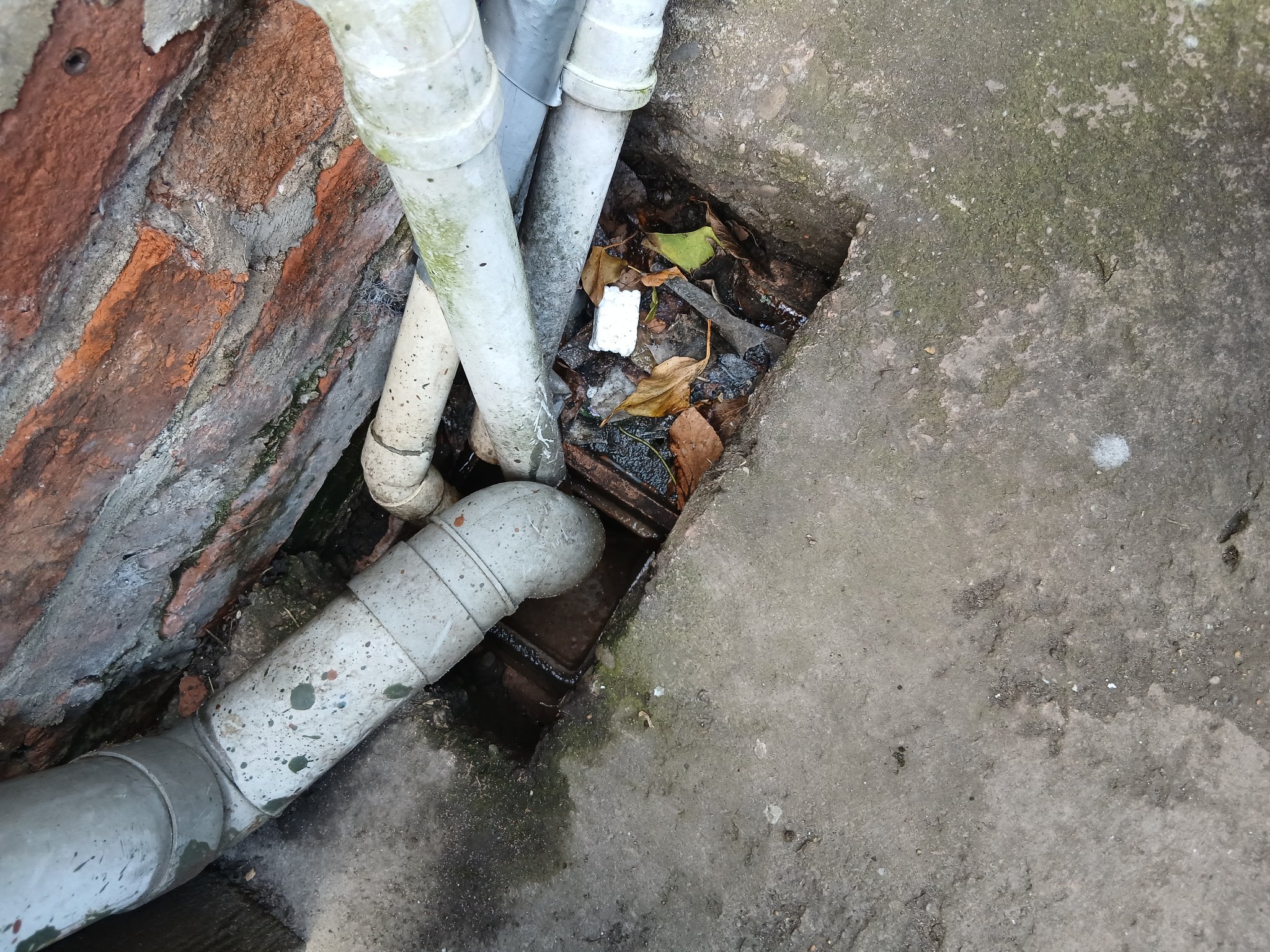

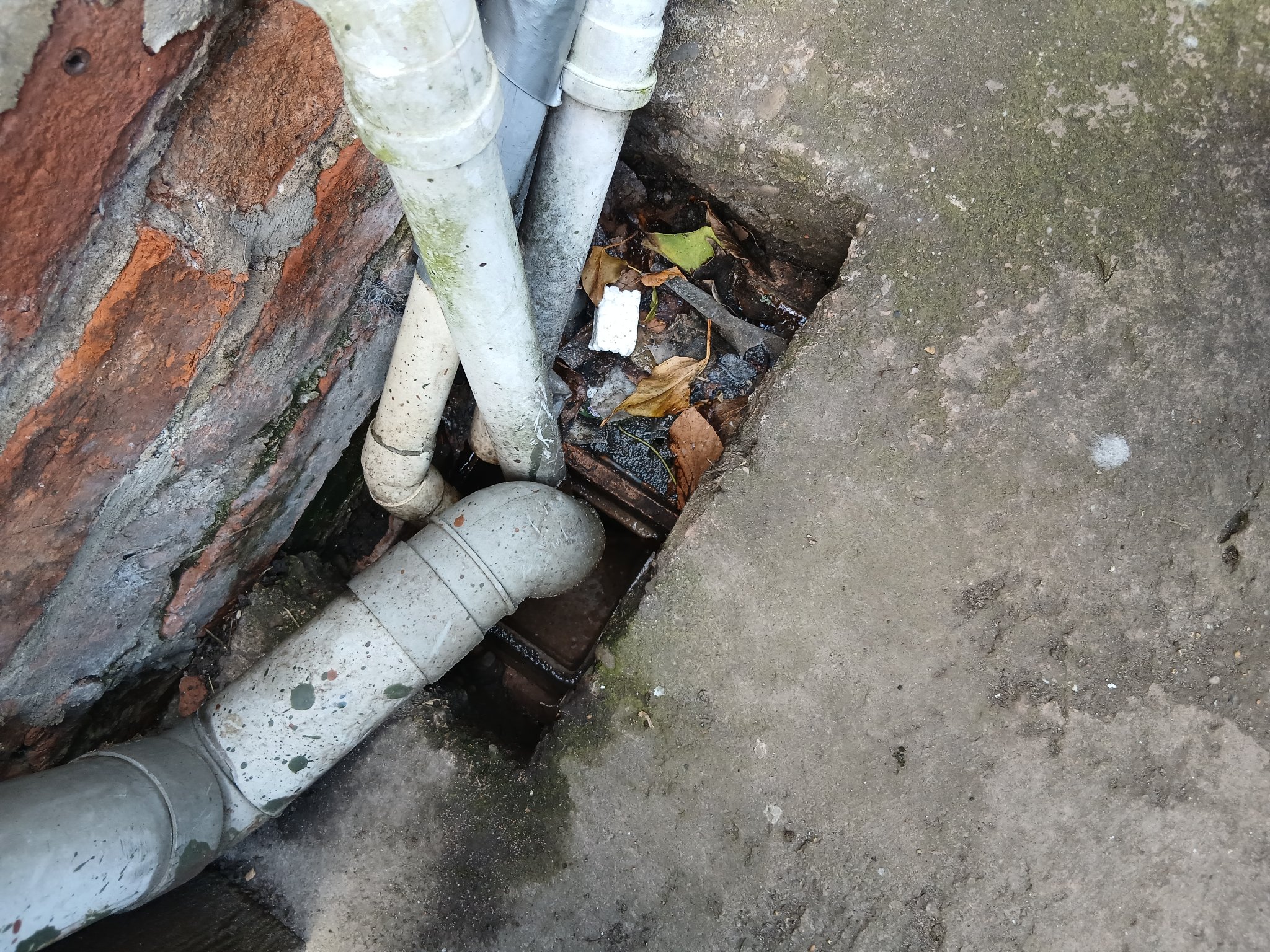

What to do with this Daughter lives in rented bottom flat and has this mess outside of her kitchen door Can i put some newspaper around
it and cover with a bit of sand.cement thanks Charles

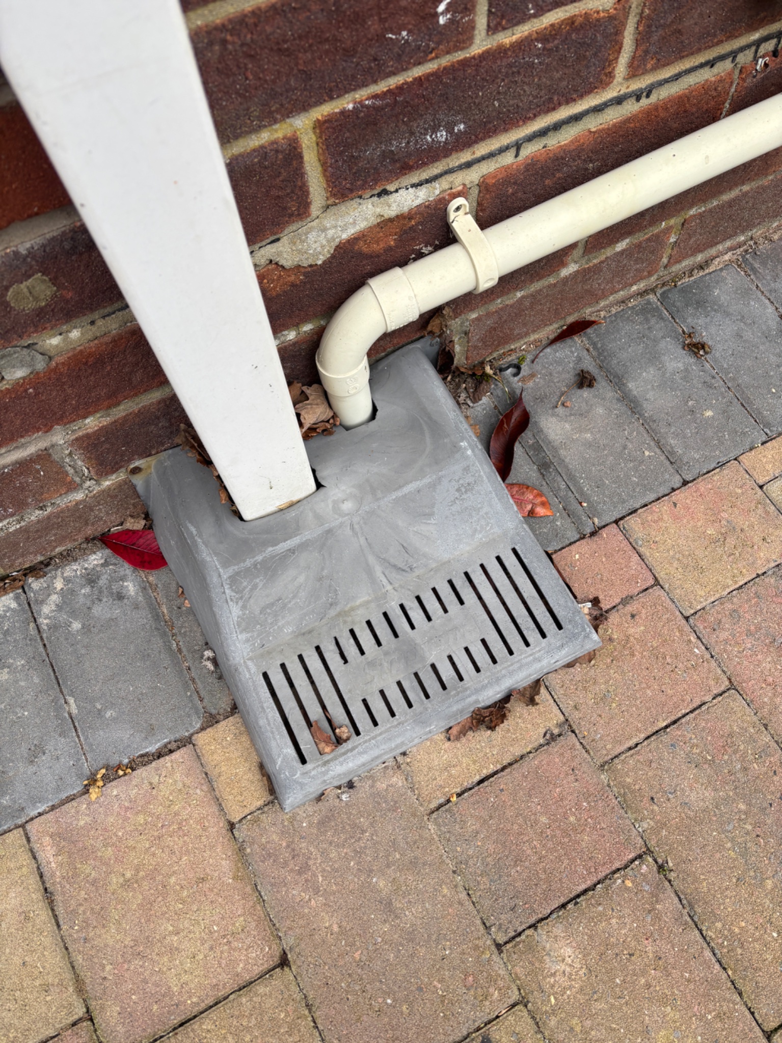

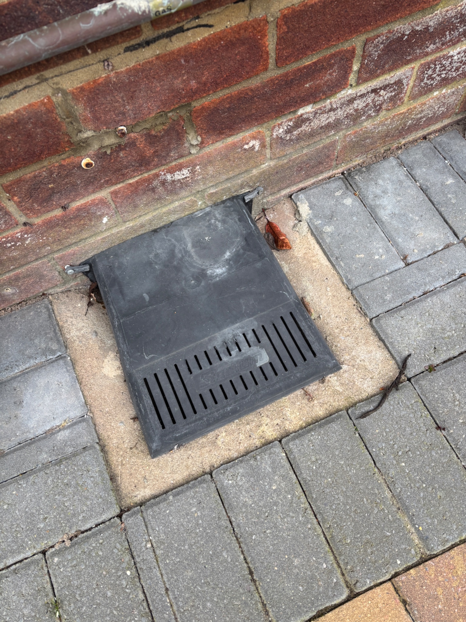

Nope, that would be pointless. You can buy cheap, plastic, drain covers, which can be trimmed to be a close fit around such things. That would at least make it tidier looking. and easily removed for inspection.
OP,
The concrete ground level has been raised since the gulley was installed - you can just see the rim of a gulley hopper below the waste pipe outlets.
Clear the obvious debris from the hopper, and cut back the pipe ends to allow you to reach down into the hopper to clean it out, and then install a grating over the hopper outlet.
To sort the various pipes into a neater arrangement might need a handyman?

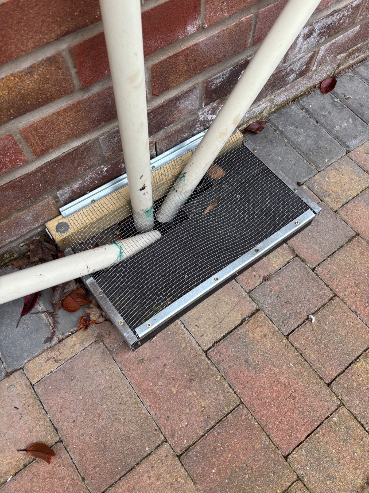

I have a wooden framework around mine with SS grid across the top and securing the pipes. I shall take a pic tomorrow if I think on.

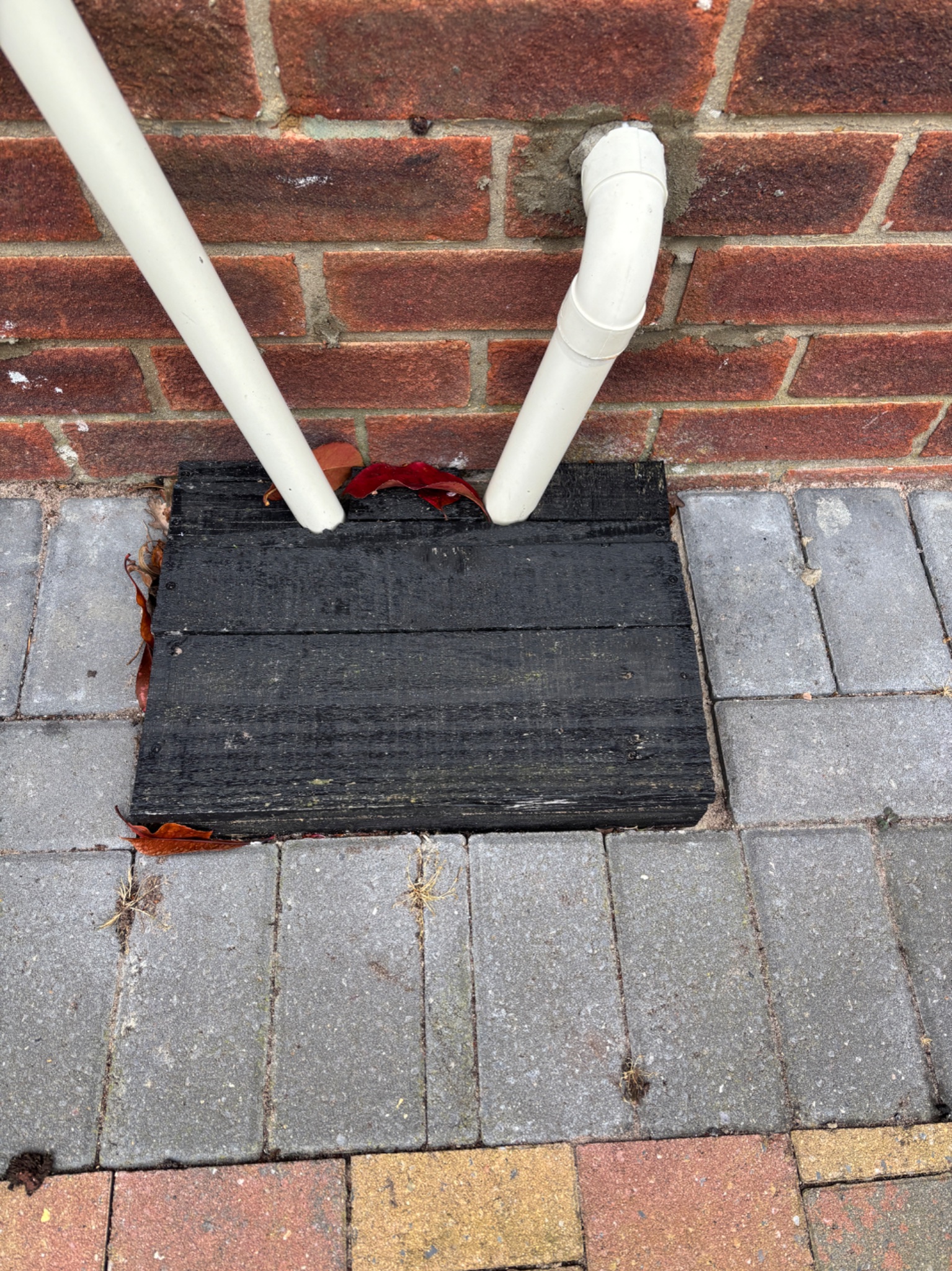

Use several pieces of cardboard and tape to create a template of the gulley and pipe locations.
Then copy this onto something (ideally) weatherproof to make a cover.
Plywood/upvc/ cement board. If ply, it will need many coats of waterproofing.
Wander around B&Q to find something suitable- even if it’s a flat sided plant container that you cut up.
Possibly a sheet af aluminium.

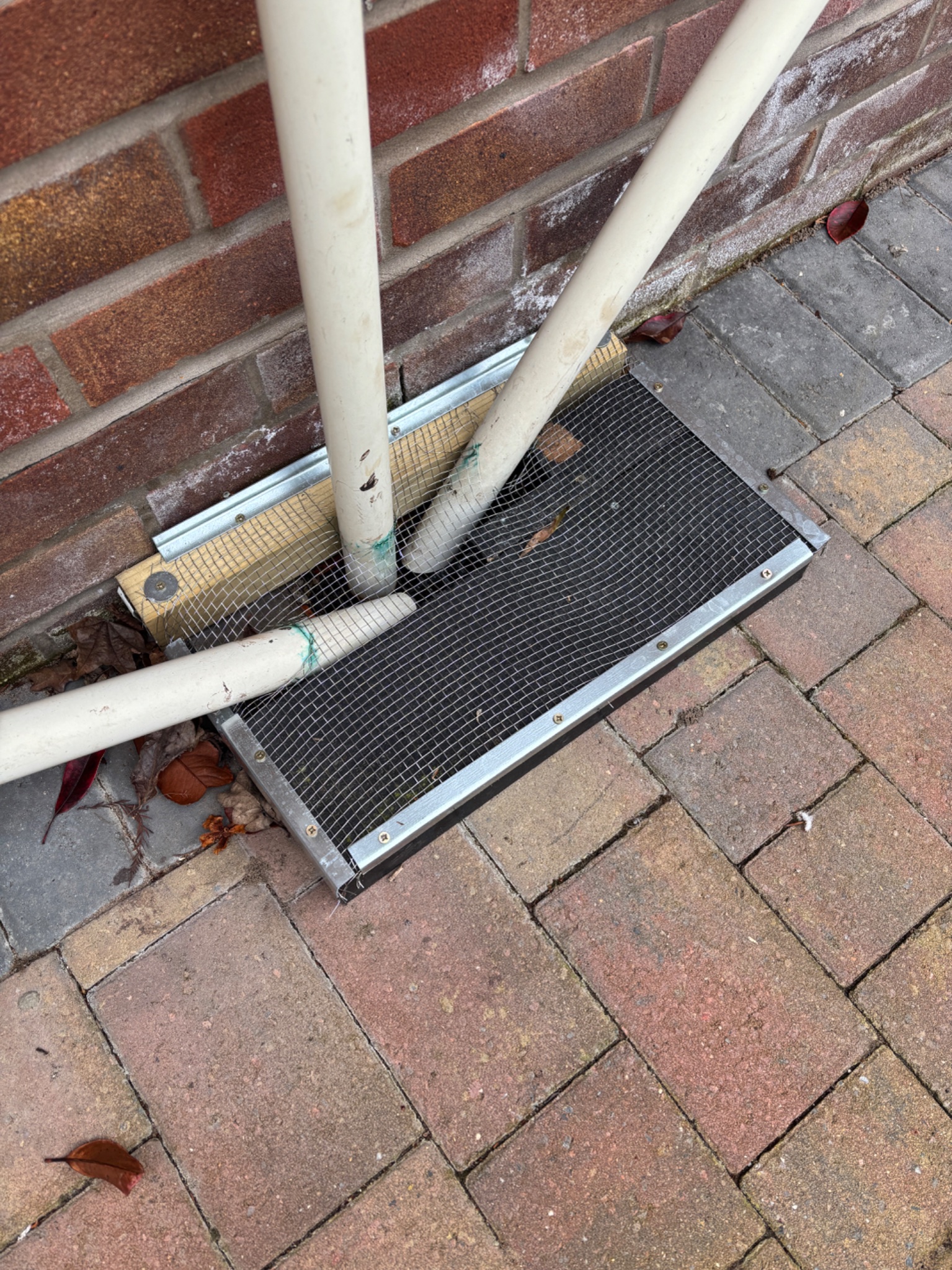

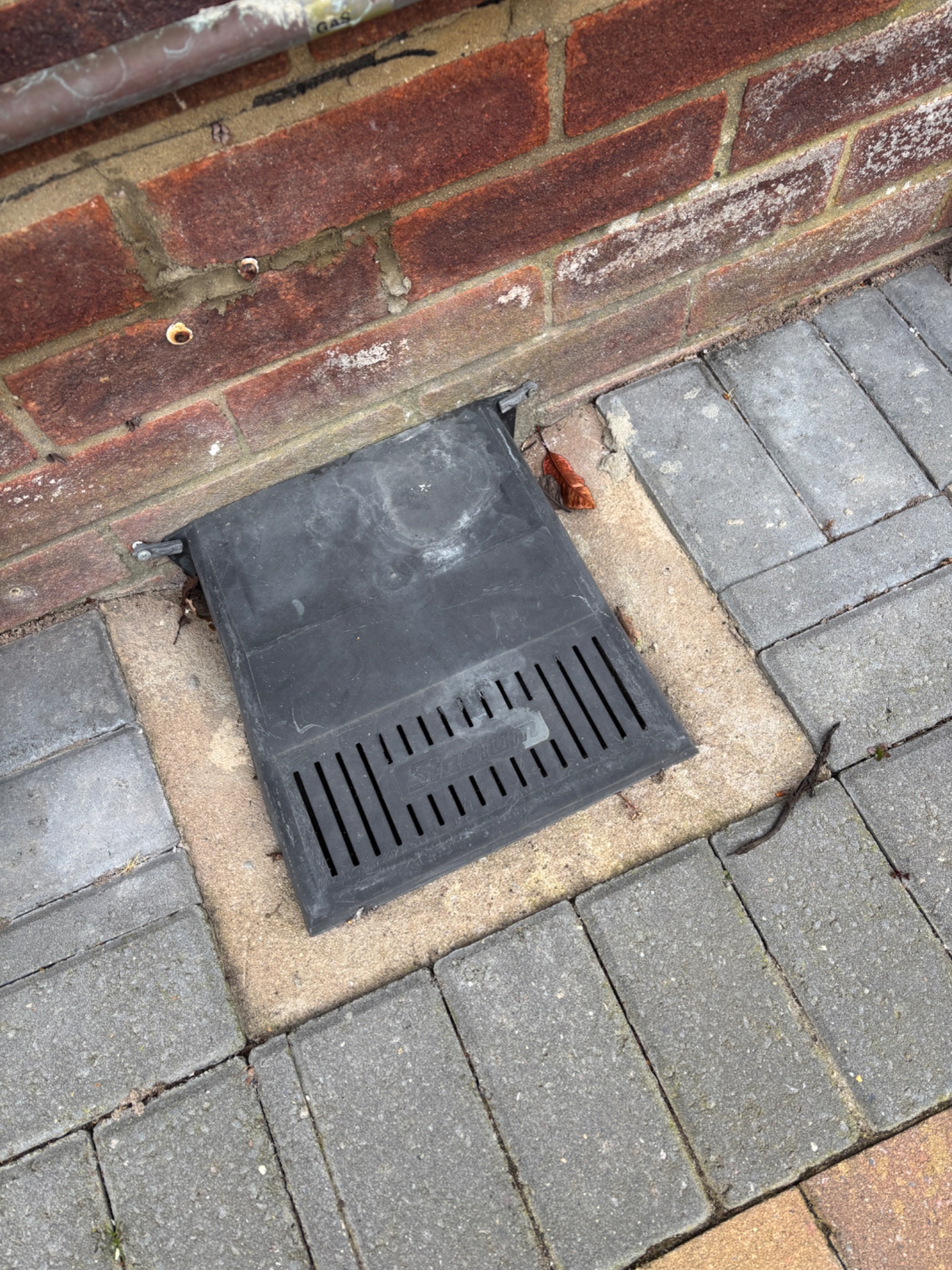

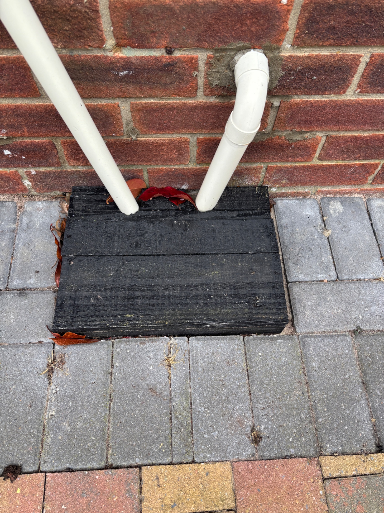

In order the pictures are a plain plastic cover, a flat wooden cover, plastic cover with holes drilled and a wooden frame with stainless steel mesh.
