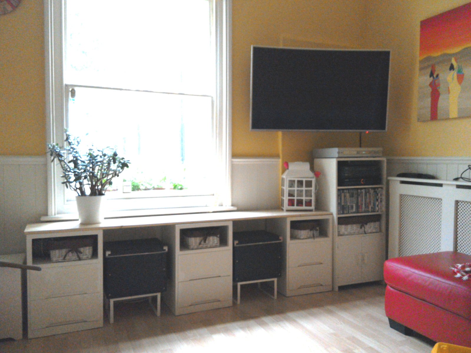

I don't want to get rid of thee original Victorian door or architrave in case a future owner wants to reinstate the door. I have no basement, no garage, nowhere to store the door.
I don't want shelves in the living room because a new TV is going to be attached to the wall on a bracket right in front of this unused door, and seeing the architrave, frame, door and panels showing around the new TV is very distracting to the eye. So I thought, panel it over, and paint it the same colour as the wall, and it will "disappear".

Well, because I didn't get any answer about what kind of filler to use before I did the job, I decided to try using some plasterer's tape on a roll I already had. The type that has metal bits that make it stay folded when you fold it around a corner. I stuck it on with wallpaper border adhesive, and now it's dry it looks OK. Of course the proof of the pudding won't be known until after it's painted.
KenGMac and Opps: no, I didn't use batons. The hardboard was pinned with panel pins onto the architrave, all the way around. It looks fine.

Pic. Door not particularly noticeable and almost invisible when watching the telly.
