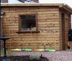

Morning,
I have recently done a complete rescape of our garden and it is looking lovely.
However, we have one of those pre.formed concrete garages which has pebble dashed sections. I've tried drilling into this for a hanging basket but it is rock solid and the drill bit just wore out very quickly with it hardly making a mark on the concrete!
It's a bit of an eye sore and I'm wondering if there's anything that can be done to cover this so it looks just a bit nicer?
Thanks.
I clad mine in T&G shiplap .
Put vertical batons 400mm apart and clad.

Enlighten us.
Fixing timber to the outside using battens is simple.
Precast concrete (especially aged concrete) is very hard and you need a decent (Sds) drill.
It also mentions in this post about drilling into these panels can lead to them breaking and knackering drills.
That is because they are reinforced ( with rebar I guess ) so once you feel resistance to a masonary drill swithc to larger HSS then back to masonary. That is if you hit any, you may not.
Have used ads drill when I had concrete garage , takes about three second to drill , couldn’t be easier .
