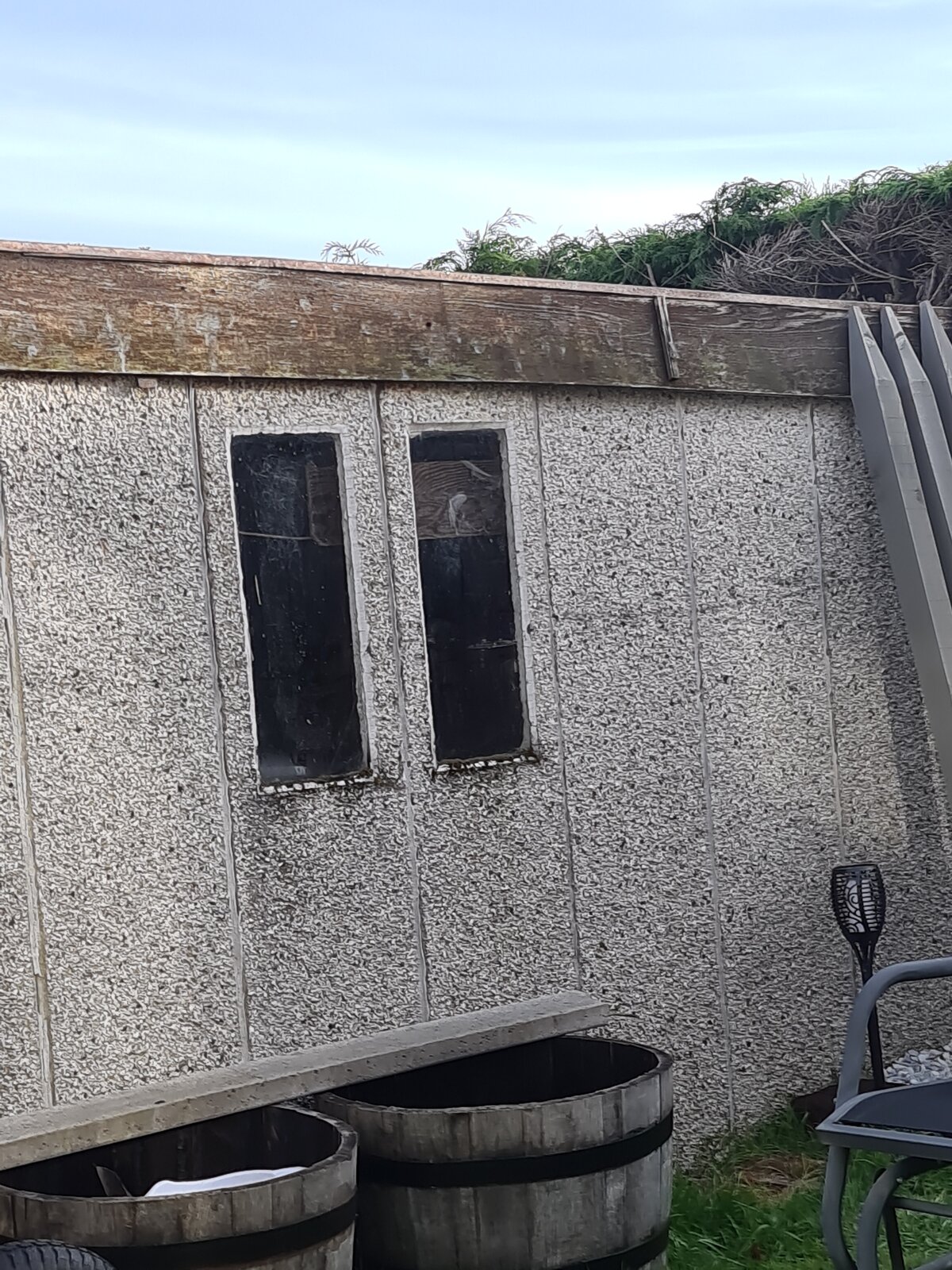

Morning everyone,
Looking for some advice re a concrete panel garage please.
We recently bought this house and the detached garage appears in need of some maintenance. The sealant between the concrete panels appears to have cracked and chipped away in sections, which is letting in water.
Whats the best stuff to reseal with? Can I just put it over the existing stuff or should I remove as much as possible first?
Cheers

Rake as much of the old sealant out as possible......with mine, its silicone on the outside and I foam the gaps on the inside.
Water ingress through the bottom of the panel where it touches the raft was a huge issue for me, so I laid a concrete screed about 11/2” thick inside. That sorted it!
John :)
RonnieRM, good evening, again.
OK it looks like a "Marley" sectional garage.
The joints are simply a mastic, but a fairly wide Mastic.
As John above remove the badly failed areas and new mastic
Ken.

My 24 x 12 garage is of that type - it has never been sealed between the panels and there has never been any ingress because of it. The panel edges are all tongue and groove, perhaps that is the difference?
Like John, I do suffer ingress via the slab. I made the error of setting the slab a fraction too low, when I laid it out 40 odd years ago, that plus the slab settlement and garden rising, meant that when there is a lot of rain, I get a wet floor. It only just does wet the floor. A temporary solution over the years, has been to add a fillet of cement like a dam, inside along the bottoms of each panel, but only struck to the floor/ not the panels.
My long term fix, if I ever get a roundtuit, like John is to screed the slab over.
