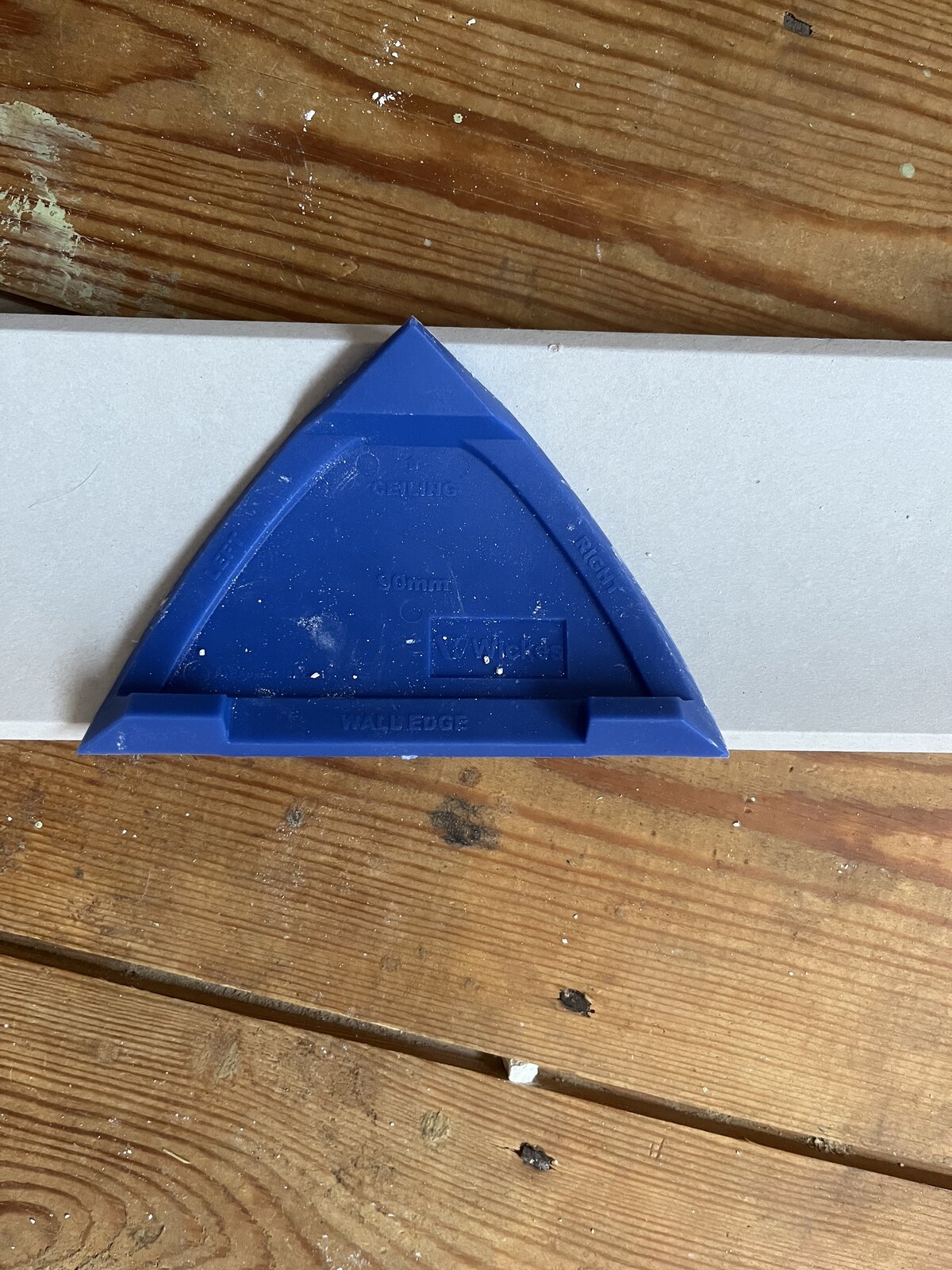

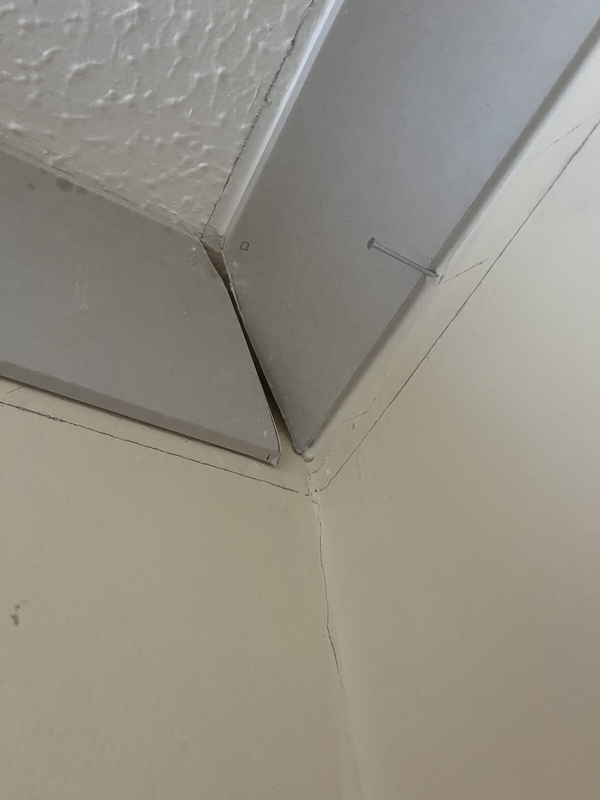

Hi all
I’m currently attempting to fit my coving using the 90mm coving tool from Wickes. Following the instructions, i’ve put the first internal corner up and they aren’t butting up to each other
Any ideas why it isn’t sitting correctly?
Many thanks
You have to make sure you angle the saw to follow the tool profile.
Also, make sure you put the ceiling side in the correct position which is marked on the tool and on the back of the coving.
Finally, you'll need to make sure the flat bits of the coving are flat to the wall and the coving doesn't slide up or down so to mess up the corner.
BTW, unless the walls are at perfect 90⁰, there will be some filling to do and if you're using coving adhesive in powder, you can fill with that.

I believe the walls may not be 90 degrees, I’ll check this out tonight! May need to fill in the gaps instead
You cant go wrong if you make a box up like:
Assuming that your lower pencil line is correct- you have deviated from it...
The bottom will never line up.
It look like the two sections are sitting in different planes.
I do coving occasionally, not very often though.
Like you, I will run a pencil line but yours seem to be massively incorrect.
The right hand pencil lines are way bigger than the left hand side.
The pencil lines are incorrect. I bought 90mm coving and was given false information. On the fitting sheet it told me to mark a line 83mm across the ceiling, and 83mm down the wall, which meant to coving was nowhere near each mark!
The narrow lines, I made the coving square with the wall and ceiling and just marked them off that way
Fair play, but the more important line is the bottom line, you have deviated a lot from that.

In your defence- the stippled finish may have thrown out your markings.
It's so easy to get it too high up the wall/too low....
The idea of the lines, is to ensure you get the coving square into the corner, not up the wall too much, not set too low. What I found useful, to enure both edges of the coving were equally spaced from the wall/ceiling corner - was to hammer in a series of panel pins, along the line, along the wall. That makes it easy to get into the right place, and helps support it, whilst the adhesive sets. Once set, the pins just pull out, leaving almost no mark.

Great thanks guys. Can I ask, would you have any idea as to the distance the lines should be down the wall and across the ceiling for a 90mm coving?
I was definitely given the wrong info from wickes!!
You can easily determine that, by your own measurements - cut a short section of coving off, place it somewhere which has a perfect 90 degree corner, adjust it up and down so it is absolutely equal, then measure distance out from corner.
