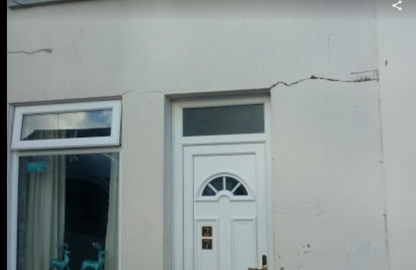

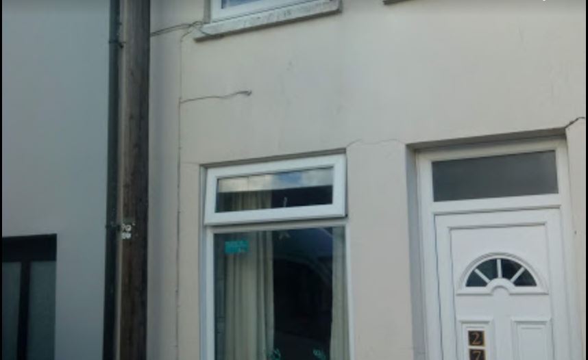

Cracks present in the render just to the top and right of the window and door (see photos). There's no sign of movement on the inside or anywhere else about the building. I'm also not sure how long the cracks have been there.
Is this something that I need to be concerned about?
Do I simply chisel off the cracked area and make-good, blending it in?
Or is this signs of something more sinister?
The property, although it looks Victorian, is actually a conversion from a garage done in the early 1980s.

If you are concerned it is still moving then fit a glass tell-tale for a couple of months.

Oh so not your property, would help to know that. If it’s an ex garage then there is a risk the foundations don’t run under what would have been the mains doors, saves a few £’s not supporting an area which will take no weight.If the opening was later infilled without foundations it could be a serious problem.

Would it be a structural engineer or a building surveyor that I should be asking to investigate further? In my experience, surveyors tend to just look and comment on possibilities rather than actual saying what it is.
Would need a hole out front down to foundation level to confirm .

I've made contact with a structural engineer to see what if anything, they can offer. Also, I'll be attempting to trace the previous owner (to the current one) re anything they can offer. Unfortunately there are no building regs records nor drawings within the planning permission portal.
It may be that it is historic, in which case nothing to worry about.
Unless it is ridiculously cheap then I think I would walk away or at least delay until the owners have supplied evidence of compliance with building regs. & a structural engineers report. As you say a surveyor will just say there is a large crack in the front wall.I don't think I would be paying extra fees.

That cracking could be being caused by a rusting Steel lintel? if that elevation was at one time a garage then it is possible the door was full width??
If so then the damage should be easily repairable

Does that entrance door open and close easily? Ditto for the Window sash.
