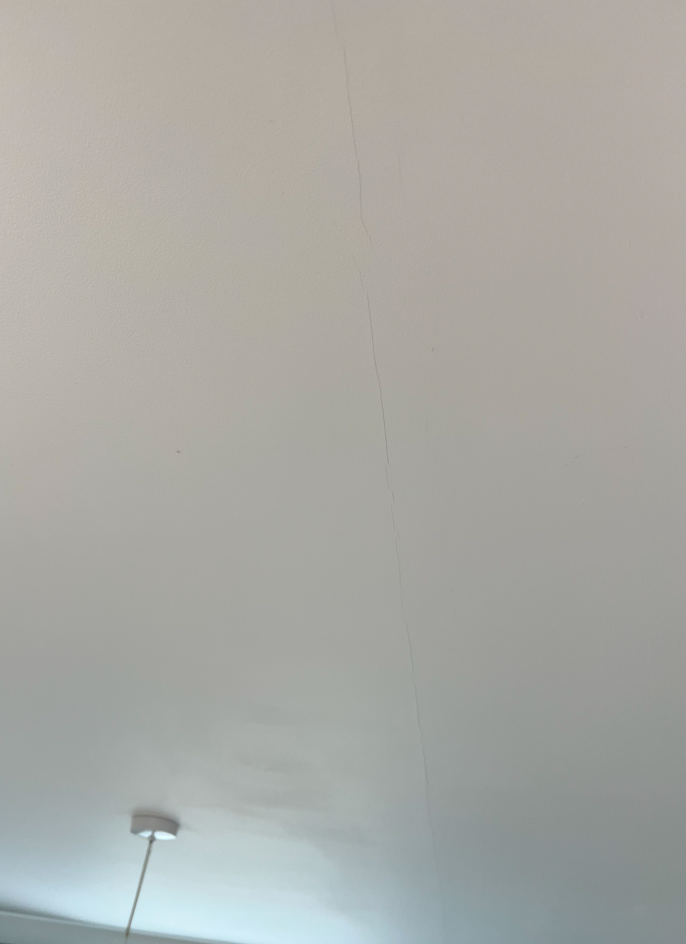

I am embarking on re-painting one of our bedrooms and annoyingly it has had a crack in the ceiling for almost 4 years now. I don't think it has deteriorated over that time. Can be seen here:
I am quite handy with easifill/Toupret and the sander but wanted some advice.
In the past. I have used a screwdriver to scrape out more of the crack (not this one but a similar crack elsewhere) and then filled, sanded. The crack has resurfaced a few months later.
On one occasion, I used the paper based jointing tape in a similar situation. I then applied easifill. Results were much better.
Since this is going the entire width of the room (around 4 meters), I didn't know whether it would be a good idea to cut a section and see if there is joist support above and then do something...
Unfortunately, I can't access it from above to see where the edge of the plasterboard is in relation to the ceiling joists.
I would welcome any advice you can offer. Thanks in advance.

Get a rare earth magnet from a phone holder or eBay. Run along the crack, and the magnet will pick up screw heads if there is a joist above the crack.
Another way is to drill a hole in the crack to find the joist behind it.
If there is a joist I'll ill tell you what to do next.

I plan to drill a hole in the crack and report back the results. Thanks again.

Done some investigations and can confirm that the crack runs perpendicular to the joists.
Can you please advise how I should rectify this. Thanks again.
Tungsten scraper. Take 1-2mm off.
Seal with watered down pva.
Fibre Fuse tape cut to width. It's the best tape imo.
Embed the tape in toupret filler.
Fill, sand, fill, sand until smooth.
Won't see a bump from tape as not sat on the surface.
