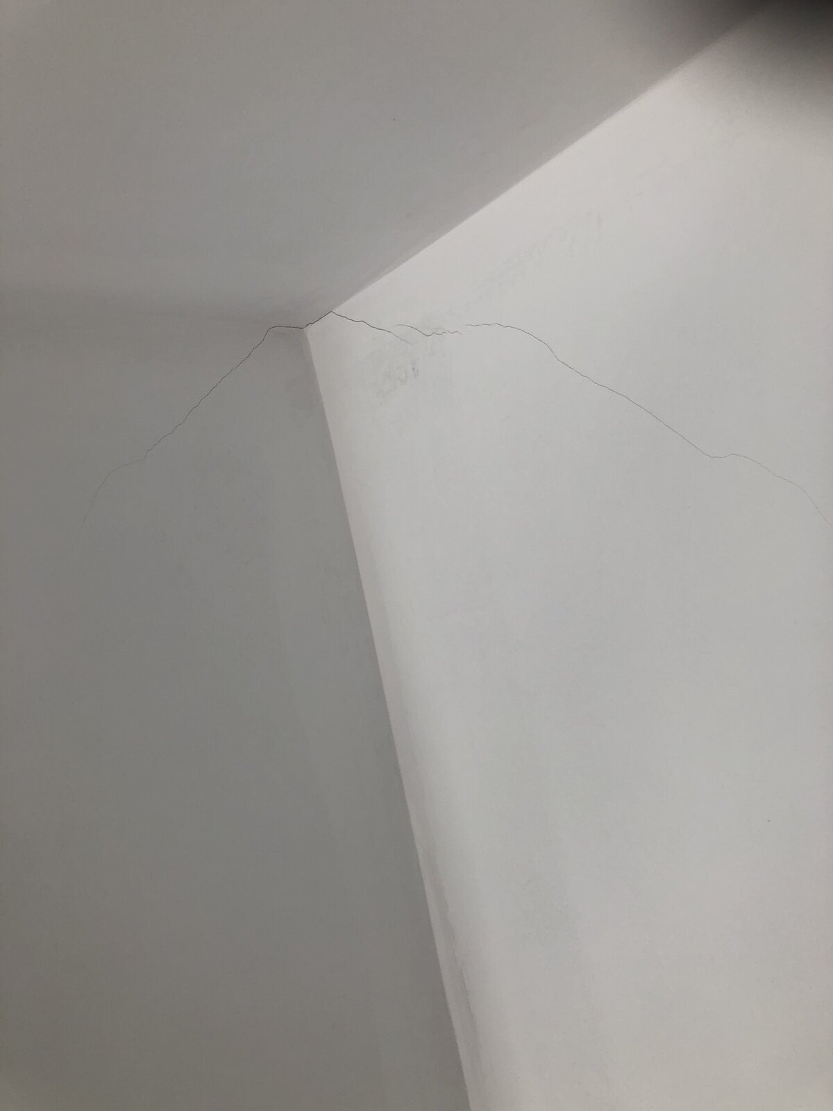

Hi good afternoon I got some plastering completed on a house refurb 2 months ago heating has only just gone in and starting to notice a few cracks is it anything to be worried about most are corner of doorways but 1 is in corner of room. Thanks

If you can't get your fingers in there's nothing to worry about.
Can’t get fingers in just unsure how it’s happened after plastering completed 2 months ago
If you tap along the line of he cracks, does the skim sound "hollow" ?

It does slightly sound hollow, crack looks worse on the photo thanks
Because plaster absorbs and releases moisture 27/7. And then one day 2 weeks/months/years/decades in the future when you crank the heating up and the air dries .........
