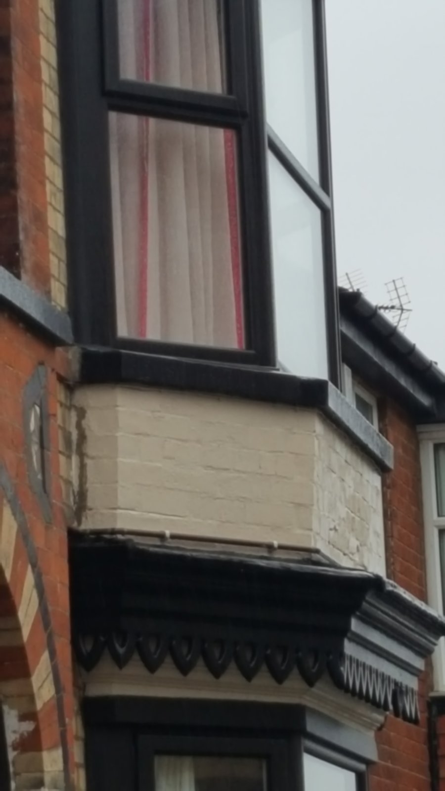

September this year the painter came to paint the outside and upon doing so noticed the full brick work had come away from the window frame! Easy a 1.5/2" gap and enough to fit fingers through said gap to just below the knuckle of your hand! As the painter moved his ladder against the brickwork the full thing moved back.

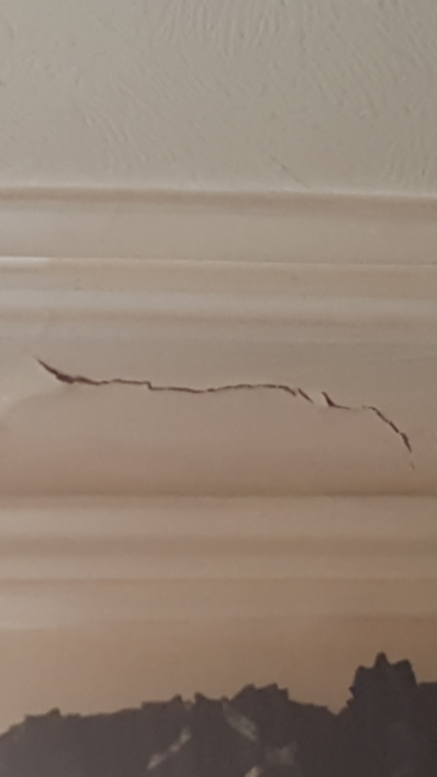

My daughter's room ceiling now has a lip in the ceiling but the lip doesn't drop it goes up. Almost like the ceiling has been lifted!

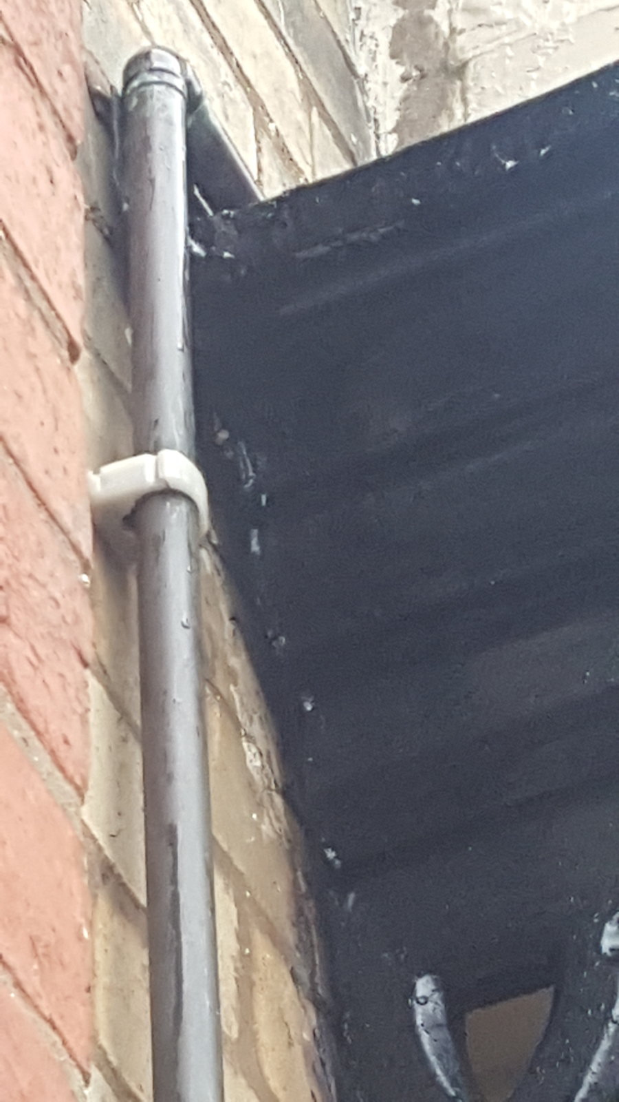

The top of the bottom bay window where the lead/flashing roof is, now touches onto the gas pipe and has moved from the main wall creating a gap!

Just a small part of the gaping crack in my coving in the bottom room ceiling where the brick work had moved above it!

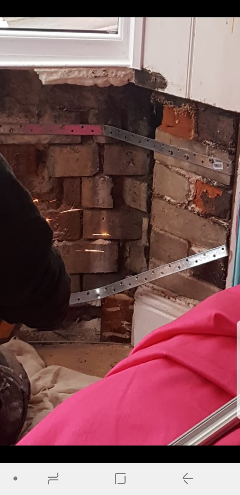

Sorry the metal bracket are the brick ties. From brick of bay to internal wall. I'll try attach pic but possibly in new comment under this one. (Sorry unsure how to upload selection of pics rather than just one. Doesn't seem to allow me more than 1 pic per posting)
The copper piping is my main gas pipe! The right side nearest my front door now touches this gas pipe. (Pic attached)
I have raised this concern also with window company :-(

Pic attached is the metal (brick tie) brackets they've fit to stop the brick working moving anymore

This is the gap that was spotted by painter.
So windows fit July.......gap found beginning of September.
That brickwork is in a poor state, those straps will only offer temporary restraint.

I hate to say it, but it looks to me as though the brickwork needs taking out and redoing.
What you need to find out is whether the bays have been installed with the structural elements to support the brickwork.
Do the windows on the lower bay operate ok? Has that bay moved or dropped and caused the brickwork to drop?

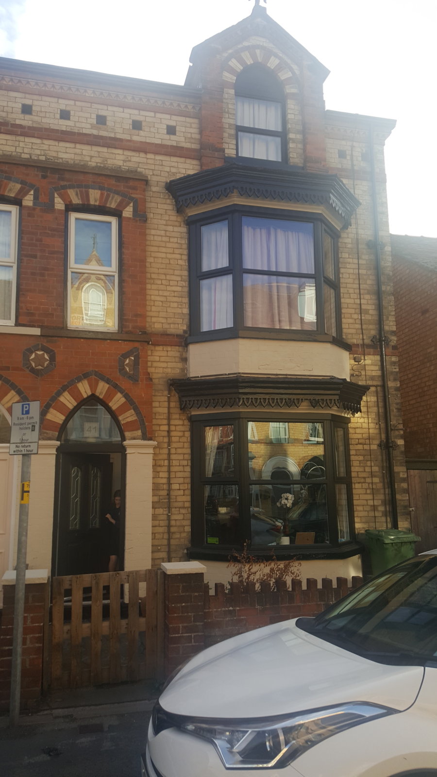

A picture from further back externally showing both bays would be helpful.
Pic of external from further back....

Wow! Stunning property (y)
So the 1st floor bay is supported on the studwork, I wonder if thats sitting on the floor joists.
The brickwork isnt doing much, its not supporting anything. However the brickwork is supported by the ground floor bay, so that needs chacking.
Given the brickwork doesnt have the window above it holding it in place, maybe it wasnt fixed to the inner studwork so its started to lean away, possibly because the bottom bay doesnt have a proper lintel.
The remedial straps arent a suitable solution. I would say it needs a surveyor or experienced builder to check the construction.

2 wall tie brackets to stop the brick work moving
Really sorry to say but the straps as fitted are in effect less than useless [really sorry to say that]
