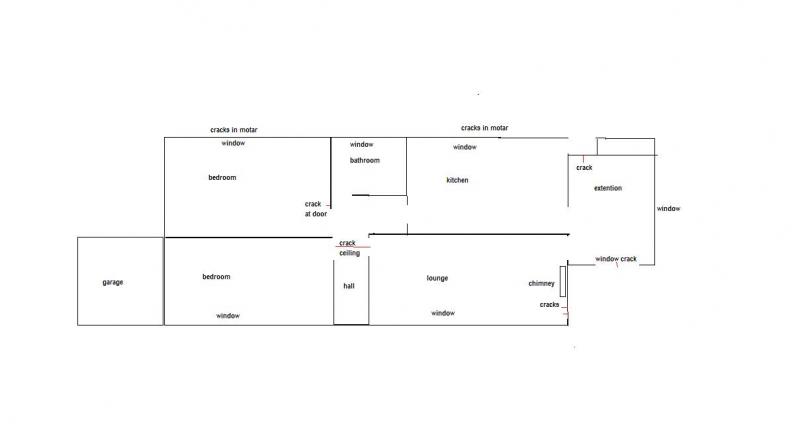

HI, could someone give me an idea on these cracks..we had our offer accepted £5,000 under as in need of modernising..the bungalow is 100ish years old and has been vacant for over a year..it has a 12 by 10 extension built on the side wall and an arch built next to the chimney wall. there is a large crack running down from radiator in extension, crack on extension wall..two diagonal cracks on main house opposite chimney wall, crack running on hall ceiling and crack around back bedroom door. The external brickwork has a couple of motor cracks running down. We are only having a homebuyers report as was told structual would not tell us why and how, so we are expecting to have to pay for SE. Having sleepless night at the moment. thank you Loraine.

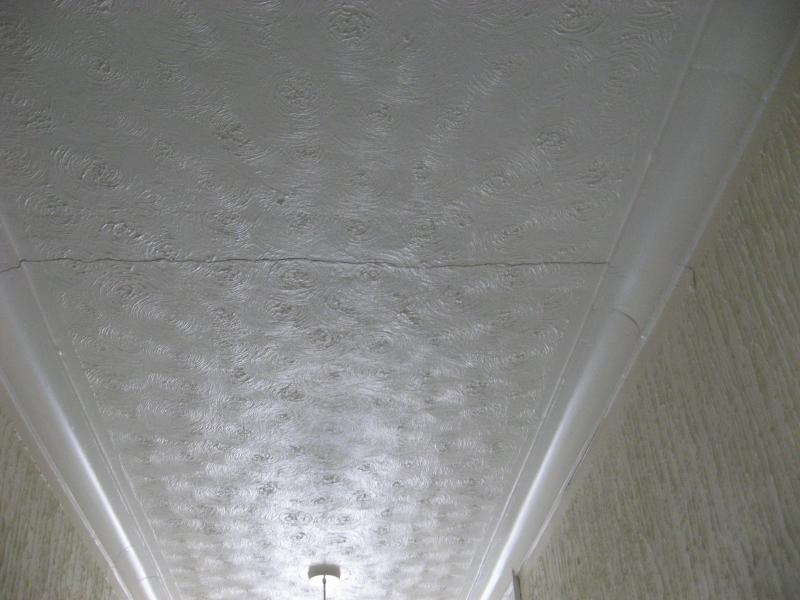

Ceiling crack looks like someone was boucing around too much in the loft and caused a minor crack in the plasterboard.. check the walls each side and see if the crack runs down them if not, then simple crack repair to artex..

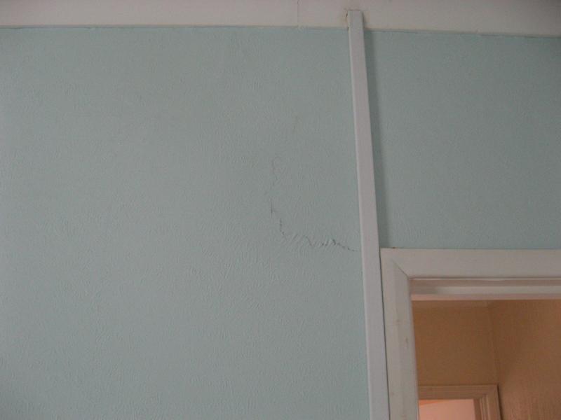

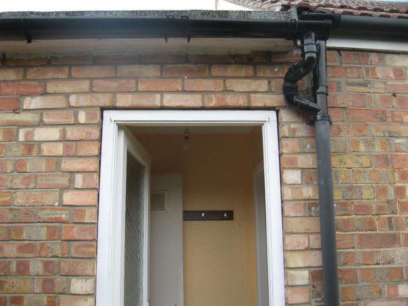

Door crack around lintel looks like just normal movement in the wall nothing special, but check the door still sits in the frame and doesnt wedge in a corner which can indicate a far greater problem

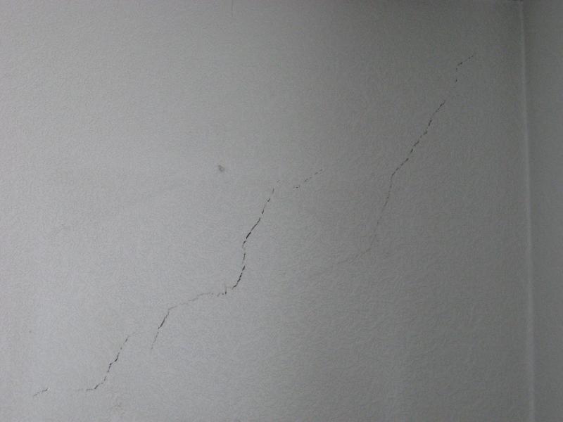

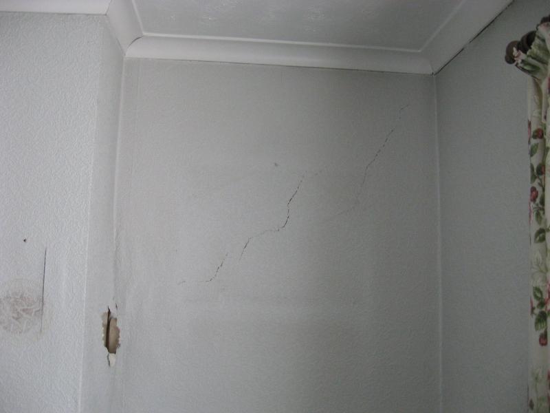

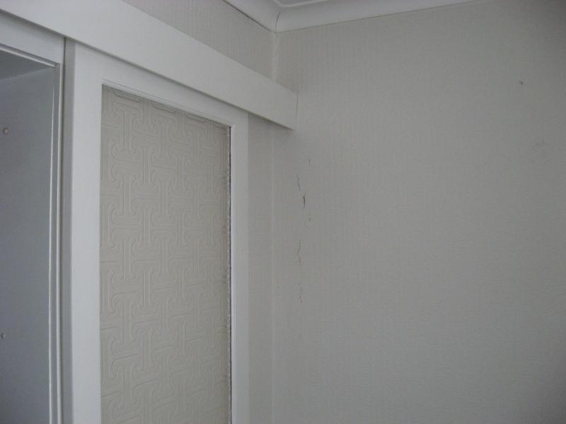

Random diagonal crack, appears to only be in the plaster, probably a shrinkage crack if the plaster is <10yrs old..
Crack in corner near sliding door, is this the other side of the extension? Photo isnt great, cant really see the crack too well

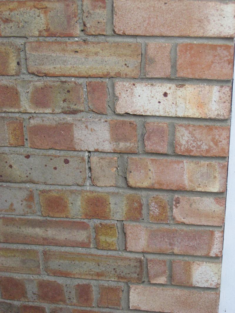

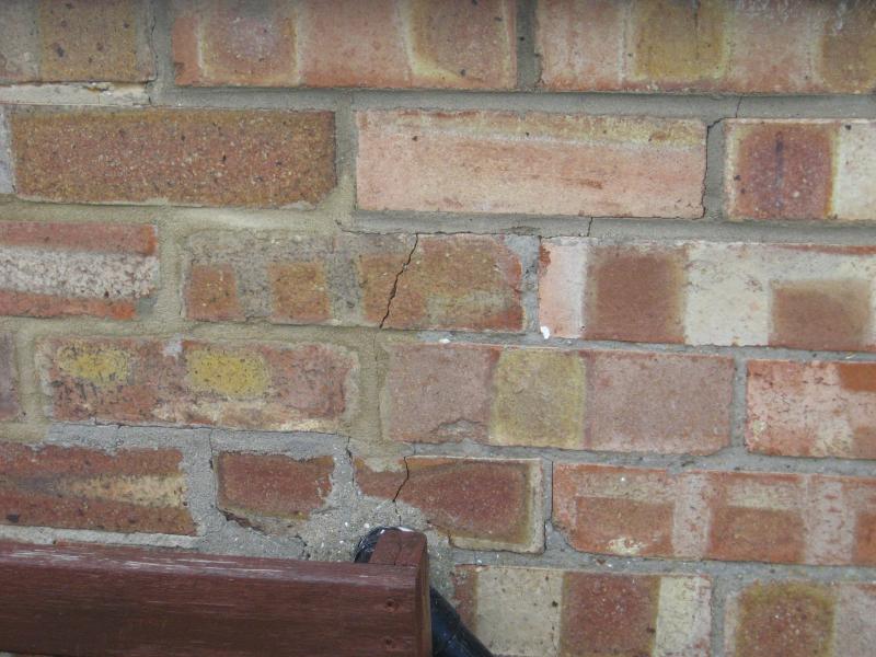

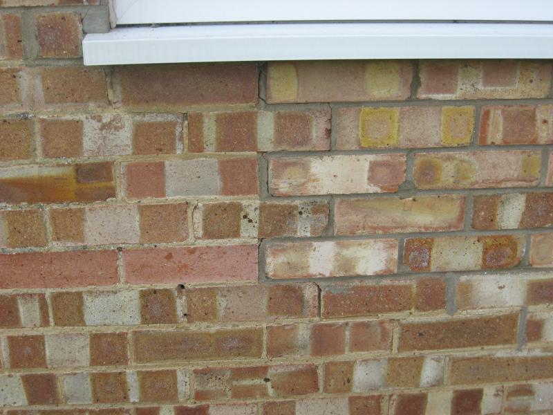

Brickwork crack, well someone made a measuring error.. seems like the crack is re-occuring and has been repaired in the past.. is this the division between old and new extension?
Brickwork crack 2, urm same as above? Other side or same crack?

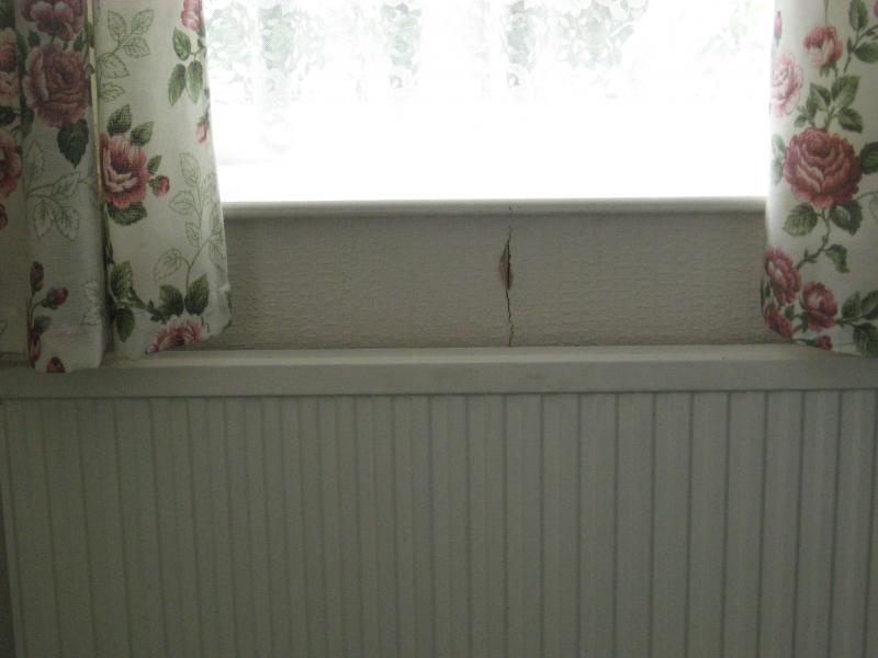

Crack under window, would need to know the length of the wall that occurs on, as well as general location in building.. look outside the window for cracks around the window corners as well as inside.. could just be thermal movement in internal blockwork..
Nothing to lose sleep over really..
Thank you for both your replys..as to the ceiling crack there is a hairline crack running about 5" under the coving.
The crack near sliding door is in the extension and the crack under the window runs down the back of radiator meeting the skirting.
they are the only two in the extension the rest are in the main bungalow. As for the brickwork its around the back door built into extension.
the second brickwork is under the kitchen window. The plaster has blown on chimney breast which looks like has water damage.
the back door in extension looks like its dropped or not fitted properly. once again thanks for all the help, Loraine.
chimney other side made into archway for extention.
back door in extention.
under bedroom window.
drawing to show random cracks.
Would not loose any sleep over any of those cracks. They all appear to be either lateral or thermal movement.
If they are all the cracks you have in a 100 year old building, then she is not in bad nick.
old un.
I agree with oldun them cracks are very minor movement caused over a period of a hundred years. Don't worry too much it's expected and I see a lot of it in older proprties.
If the house in on clay soil that would account for it.
Yes i think it is, as my husband works for the water board and when he was renewing a water main on that road he said there was clay.. Does that mean the house is possible to subside or just move in seasons?
