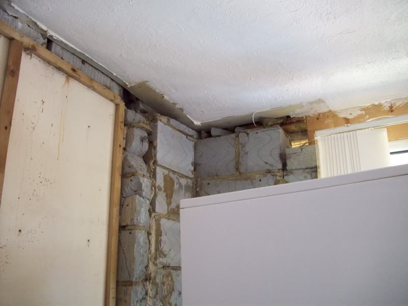

Hi, im hoping someone can advise,
I live in a 1950's built bungalow, it has a 21ft x 8ft extension on the back which we believe was built around 15-20years ago. We noticed a while ago that there were cracks on the outside walls (between the house and extension). We have recently removed the plastic cladding that was covering the inside of the extension and can see some daylight through some of the cracks. I can try to post some photos.
What would be the best course of action?
Many thanks
20 Jul 2010
122
Kent

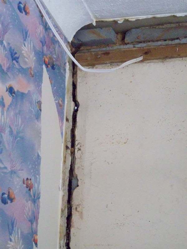

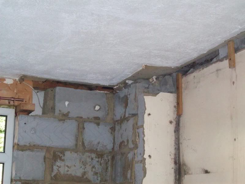

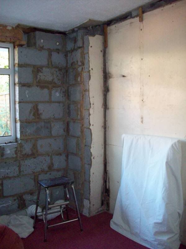

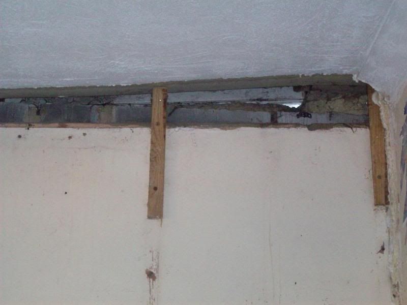

the cracks run from the ceilings to the floor, about 3/4" at the top and about 1/4" at the bottom. will post photos in a mo. Will try to get better photos when i get home from work. Where the roof joins the walls in the extension it dont look very "finished" either
top left joining to house
bottom left joining to house
top left far wall
top right far wall
top right joining to wall
right far wall

Extension not tied to house, inadequate foundation on extension!! Obviously extension built by cowboys without building regs.

Looks like the extension is falling away from the main house.. as said above could be inadequate foundations or settlement.. all being covered over by the cladding that can deal with that kinda movement.. get a structural engineers report.. probably require a hole dug to the foundations to see whats what..
Rest of the extension looks pretty poor.. almost looks like the ceiling plasterboard sits above the inner skin of blockwork!?
