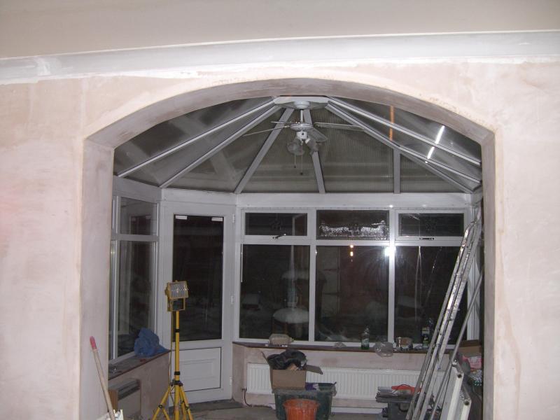

Was the arch alredy there macs3232 or have you just knocked it through? Really need more info, have you worked out how to past those photos yet :?:
Give us a long shot pic of the whole arch Macs,,,, and is the arch made of plasterboard?

There were no cracks before the re-skim so the plasterer didn't use anything to patch walls, just applied pva prior to skimming. The arch was already there. The walls were taken back to bare brick and then plastered, but the arch form was left intack, this was scored with a knife, pva and skimmed on top.

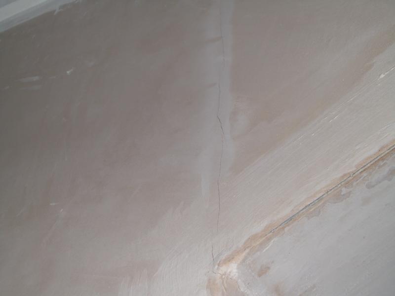

Thanks for the extra info Macs. We know the wall/s part is brick,, but what is the arch itself made of. Could it be made of plasterboard, and it has cracked where the plasterboard met the brick? If that's the case, it has probably not been taped and that's where the two vertical cracks come from. The horizontal crack could be from a fault in the brick/blockwork. I also think the shape of the arch itself, could have been formed much, much better, if the plasterer had used a flexible plastic radius bead, rather than snipping the beading he used, every foot or so, to try to form the shape. It cranks around like a fifty pence piece. Sorry,, but i'm just saying it as it is.

The arch was there before, just got it plastered and skimmed.

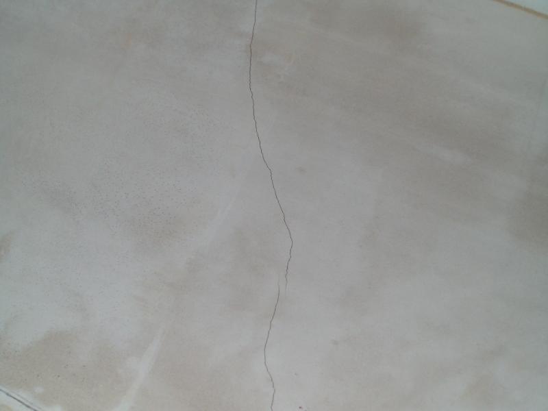

The other two runs where the arch starts to curve.

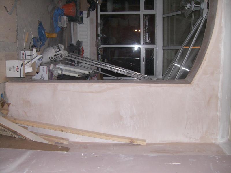

The middle pic shows the crack meeting right in the corner of the arch. From looking at the latest pic of the 'long distance shot', any stresses are definitely going to like those sharp corners.
I can't make it out from the pic, but I think you're saying there is a similar one on the other side too.
I'm not a builder, so not sure if those cracks would be typical of expected settlement following the wall cut/lintel fitting?
