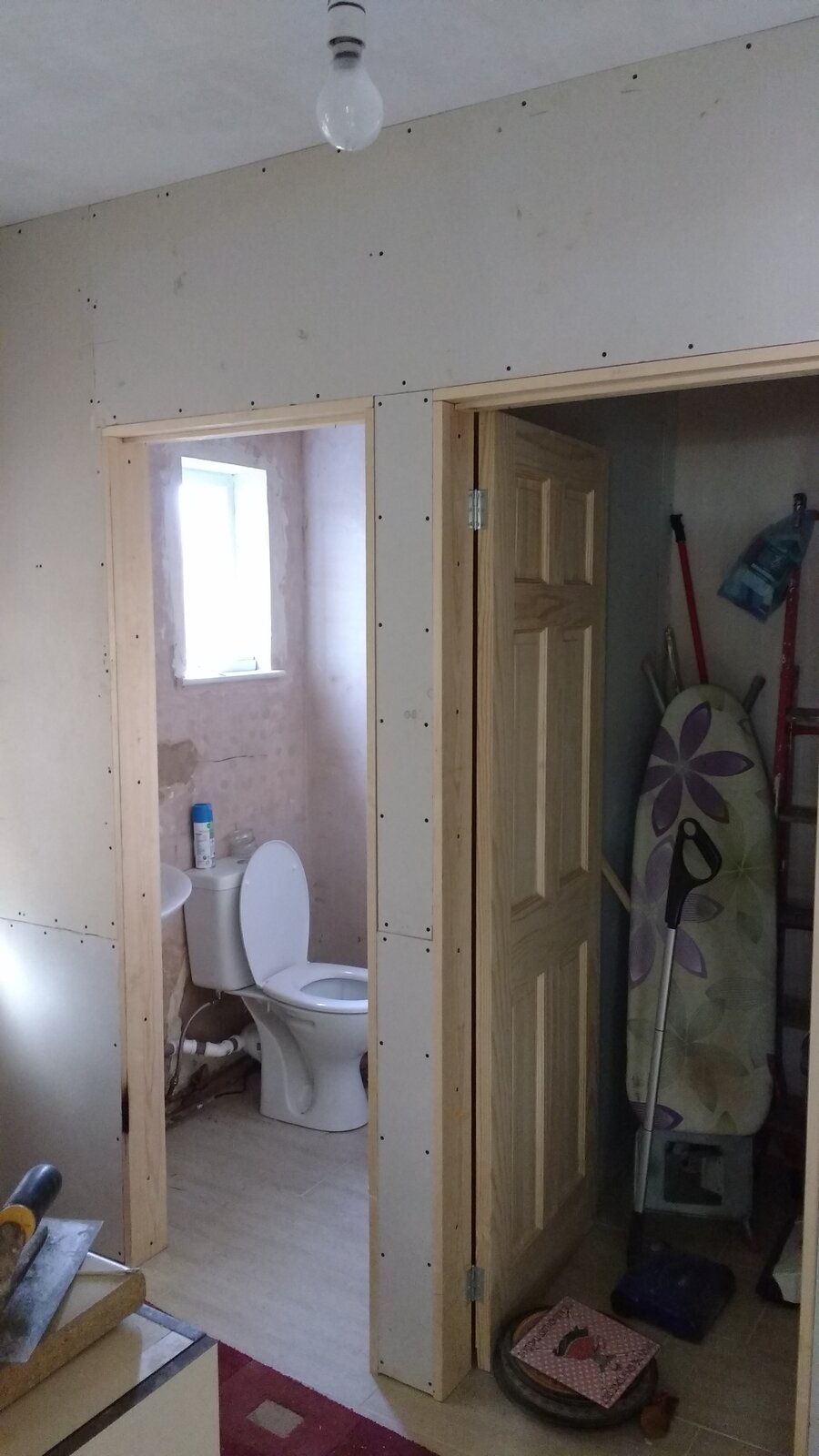

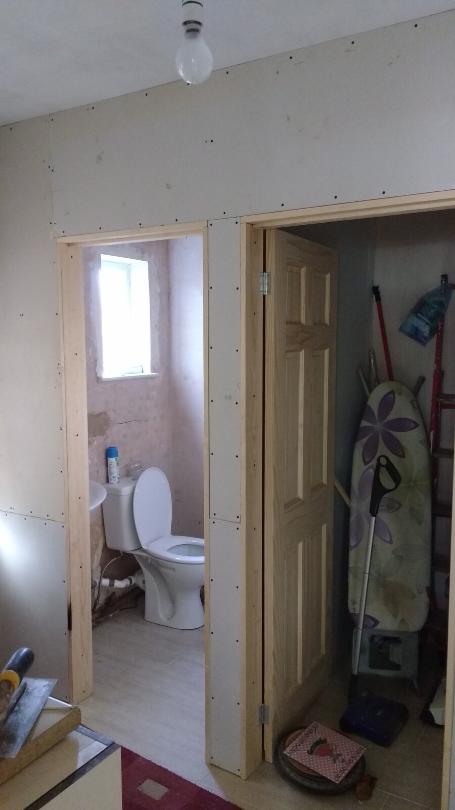

Here's mine I did a few years ago, width was 1200 and from front of pan to wall was 22", there is a towel rail on the front wall, and even if it had been 20" it would have been OK
Thanks for providing that, my width is about the same and the front of pan to wall is about the same too! The layout is pretty much the same as well but I will have a door into the utility which you have on the right, then from the utility a door into the toilet.
