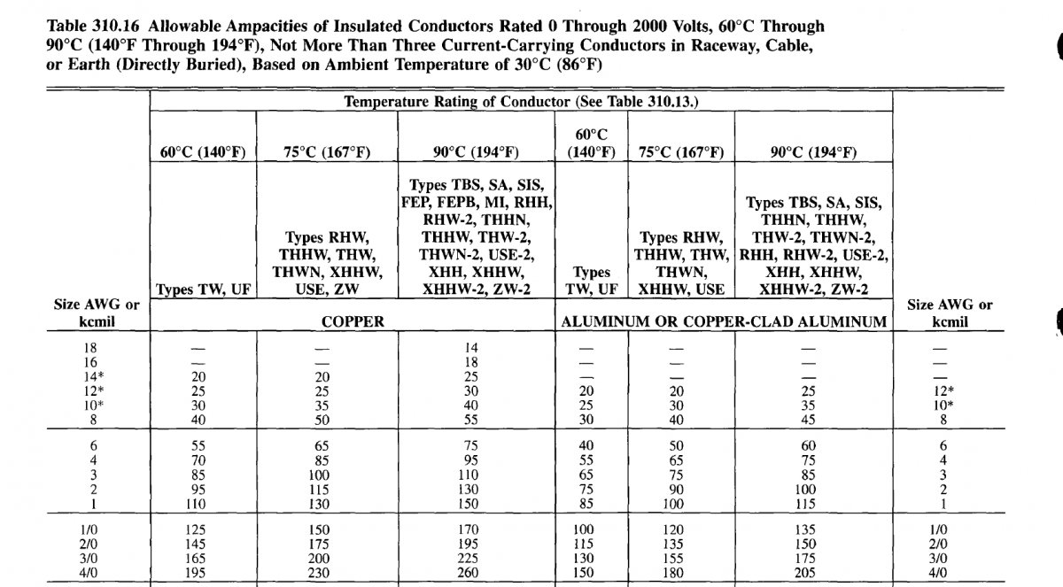

OK, doing more research I came across this, not sure if it helps though, the tables used for countries that use 2.08mm2 wire. But it has me confused. At 75*C, 2.08 is listed at 20amps. I take it the conductor insulation is rated higher?
http://www.encorewire.com/wp-content/uploads/wire-size-table-CU.png
http://i.stack.imgur.com/V56uL.png
And the old table 310.16 before it was changed to the above:
I think you are probably looking for too much precision and consistency. It is widely believed/accepted that CCC tables are very conservative (i.e. have large 'safety margins' built in) - and since those margins are essentially arbitrary, it's hardly surprising that different countries/authorities come up with somewhat different figures. However, if you're thinking of using such cable in the UK, it seems reasonable to use interpolation/modelling based on the CCC Tables we work with in the UK - hence the figures I suggested. Is this just a hypothetical question, or do you plan to use such cable (and, if so, what for?)?
