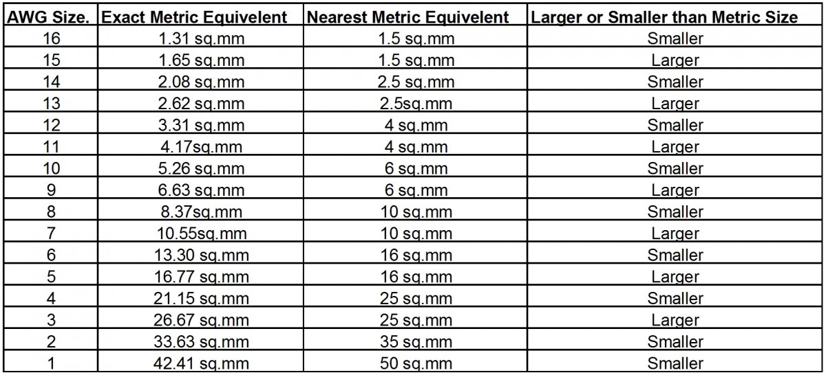

How would one determine the current carrying capacity of 2.08mm2 conductor?

I dont think so. I did some digging and found this. 12 gauge is 3.31 mm2. This wire here is 2.08mm2.
Found this, but I can't say how it relates to UK CCC's though. Realistically I'd treat it more like 1.5mm than 2.5mm
