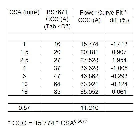

When I tried to analyse things from first principles I got a power law with a power of 0.75. Comparing with BS7671 current ratings showed that the BS7671 ratings were more sublinear than that. I didn't go as far as trying to fit a power law to the BS7671 ratings but I would be interested in the results if anyone does try.
I'm on the case - watch this space!
Kind Regards, John
A power law curve (with a power of 0.6077) fits the Table 4D5 Method C CCCs (1mm² - 16mm²) almost perfectly - see graph (line is power curve, red points are 4D5 figures) and tabulation. So, if we go with extrapolation based on that power curve, the answer to BAS's question is that 7 separate 0.57mm² conductors in parallel probably have a total CCC of around 78.4A (7 x 11.2A), as compared with 37A for a 4mm² conductor.
Kind Regards, John
...So, if we go with extrapolation based on that power curve, the answer to BAS's question is that 7 separate 0.57mm² conductors in parallel probably have a total CCC of around 78.4A (7 x 11.2A), as compared with 37A for a 4mm² conductor.
I probably should have added that, in practice, it would not be very practical to exploit this. To get that 78A CCC would require the 7 separate 0.57mm² conductors to be appreciably physically separated. If they were 'grouped' together, the consequent de-rating factor would get one back to much closer to the 4mm² CCC - which I suppose makes sense.
