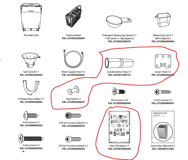

Good Morning,
I've got Currys dishwasher, and I've lost Door Fixing Kit, what mean that I can't fix end plate on. Can anybody can help me with that? I was in Currys, they told me that there is no fixing kit with the dishwasher, we've called partmaster, but they don't know anything about fixing kit.
I don't know what I can do right now, nobody can't help.
If You know where I can get these kit, please let me know.
Regards
Grzegorz.
Anybody can help me with that?
I've found manual:
full
but nobody can't explain me if they will work with my dishwasher.
Regards
Grzegorz
The lower hook in pic goes on the decor door. As the top ones as well. There will be two holes on the consol panel so the hooks slot in. The template is put on the inside of the door so you can measure the holes to put hooks on. The condisation strip goes under the wooden work top at the door top to stop the steam when you open dishwasher door to stop the work top swelling up. If this is a new dishwasher then the kit is supplied with it. The dishwasher is made for currys by a 3 third party. Could be Chinese or anywhere
