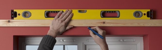

Ideally you should get the fixings into the brick and then repair the damage to the plaster before fitting the rail. But as you are looking for a "quick fix" you could fit a length of wood across the top of the window fixed at about 6 points that are away from the damaged areas. it will also spread the load over the surface of the wall and prevent damage to it. The curtain rail would then be screwed to the timber. You will need to get the fixings into the brick though. Lath and plaster won't hold the weight of curtains.
