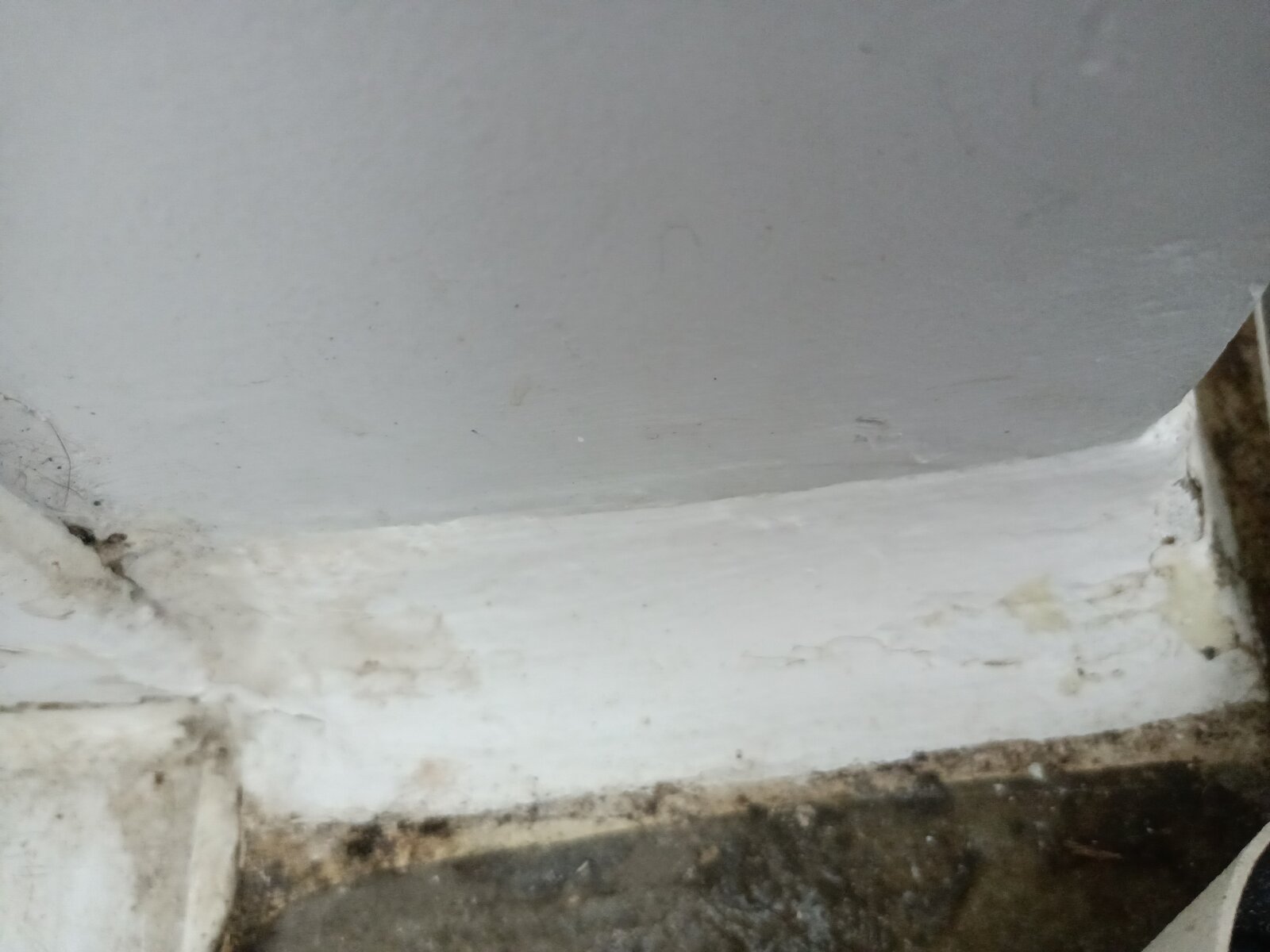

Good evening, if anyone knows how to remove this or cover it with wooden skirting?
My house is old and in this hall way the wall and floor has a curve concrete skirting type thing. Any help on how to remove it so I can have normal skirting. Or even why was it made lol could be fun any help would be much appreciated. Picture to demonstrate what I fail to explain

Was it an external wall once, the concrete designed to throw off water, or maybe it marked a change in level at a blocked up doorway into another room. You can make a mess and chip it off or just live with it if it's not causing problems, and check on it now and again..
Blup
No I have the original plans for the house. It has always been there.
I just want it to look tider would chipping it away cause problems? Like if I chip to much? Is there like a filler or something? Sorry I haven't a clue
You could match what is there (wood/plaster?) on the vertical plane, and use a screed or filler for the floor element. But it's still going to look odd unless you replace the tile, which is why I suggested leaving it in situ.
Blup
Chisel it off.
It's very unlikely to be concrete.
I'm with Johnny on this - these sort of skirtings are often plaster or render material and are run in situ (i.e. moulded) by the plasterer. You sometimes find them in bay windows, but I have seen them in kitchens and service rooms, such as pantry rooms, etc. You'll struggle to get any sort of skirting to fit over those neatly, so they are probably best chiselled back to floor level and replaced (electrician's bolster chisel and club hammer works well). The main issue I see is that if you are retaining the existing flooring you'll need to add a beading (e.g. a quarter round) to the bottom of the skirting to cover up where the original (plaster) skirting finished

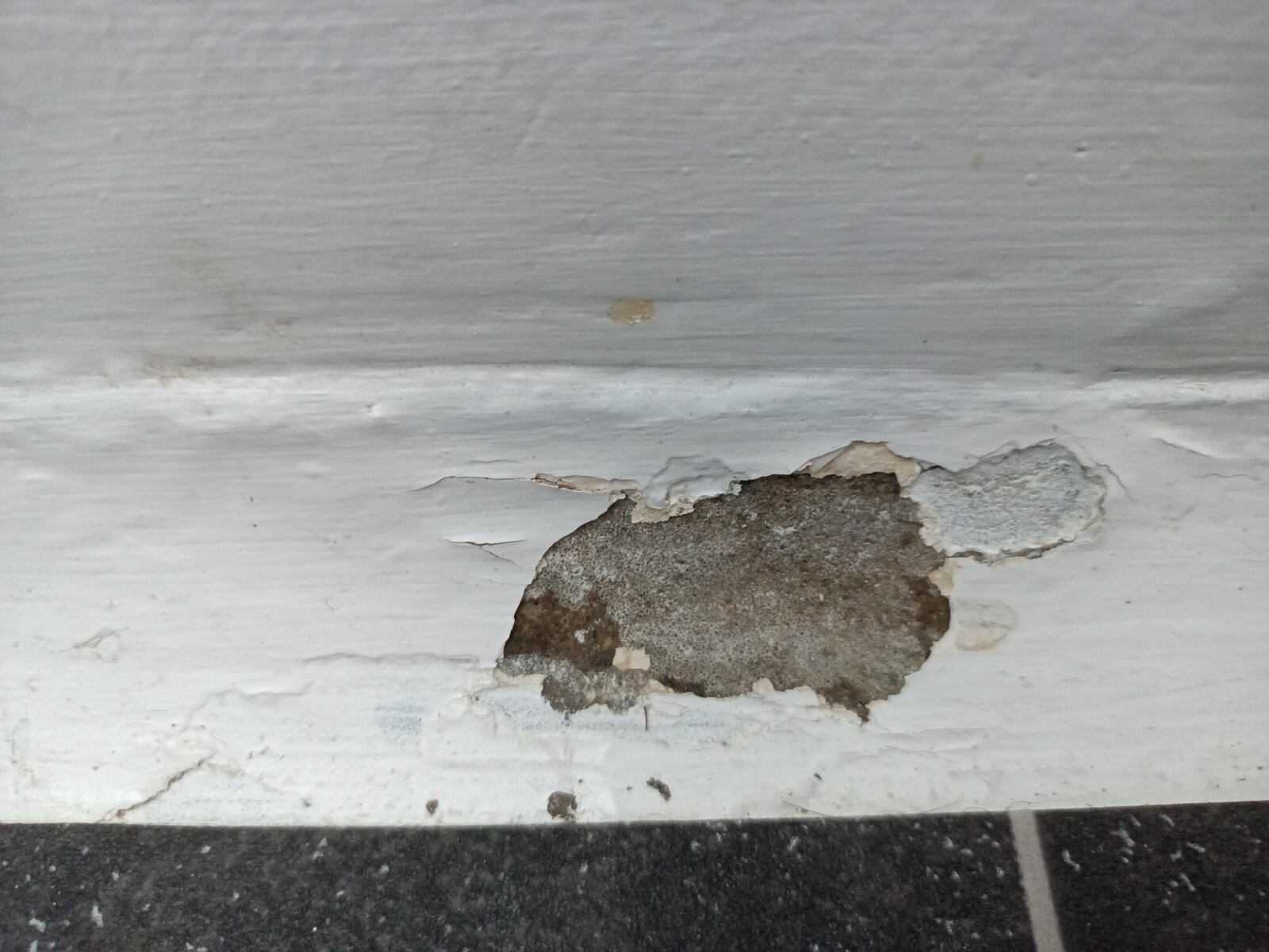

Does the tile butt up to it or does it run under it? I can't tell from the photo. It almost looks like a scotia moulding but with no visible bottom flat.
Yes it's vinyl flooring as I have no clue. Even the person who laid they vinyl hadn't seen anything like it before
That's just under the vinyl. Does it look like concrete or plaster?

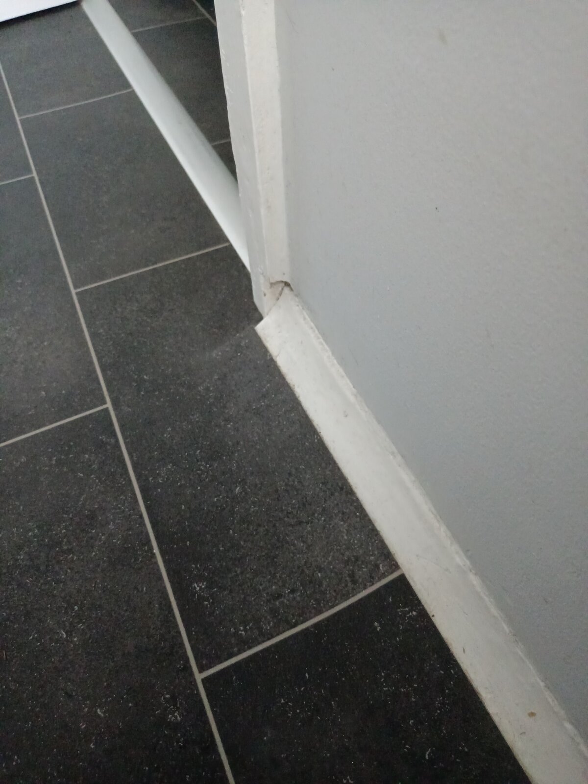

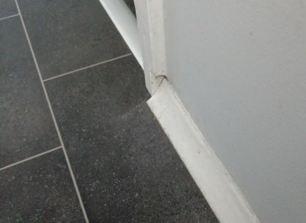

Thank you all for taking the time to reply. I really do appreciate it.

It's like it's built into the floor like the wall and the floor are one. I really have no clue what I am talking about excuse my ignorance.

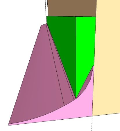

Plane the back of the skirting so it has a wedge that will slip over the concrete
Won't work without a lot of effort because tilt piece runs quite a way under the vinyl
and therefore the edge you'd need to plane onto the skirting results in a chisel edge at an acute angle which can't be sawn directly with a circular saw without the aid of a jig and would be a lot of work to plane and to fix accurately in position on the wall (you'd need to fix a levelled batten to the wall and work to the underside of that):
And it still ends up a distance above the vinyl
