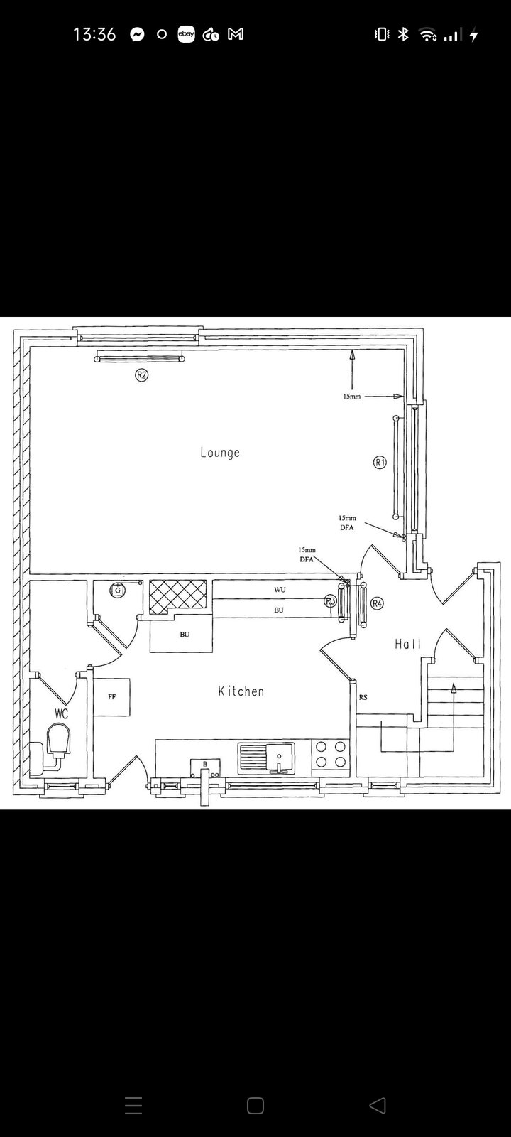

It is a a corridor hallway leading from the kitchen to the back door with a toilet and 2 cupboards. Everything in that hallway has this weird skirting thing. There is also a patch in my kitchen that's not covered by units.
The floor under the vinyl is concrete as far as I can tell (yes I own that my knowledge is severely lacking) the house is old it's around the 1950s
That is the plan I have for the ground floor if it helps. Thank you
