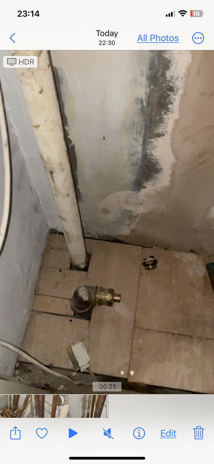

Cutting Barrel Steel Pipework For new cylinder
The good news is that the unions did come undone ! So it now looks like this!
I am going to reduce the pipework to copper sizes and then connect up
Is it a case of simply connecting flow / return / hot water draw / cold feed in and thats it ?!
Pretty much so, but if you have Gravity Primaries, as said previously, make sure the cylinder is suitable, and don't reduce the pipework size, or you may have problems with the circulation, (or lack of.)
Thanks - All makes sense - I could not get a gravity coil and research shows it will work and is not too bad.
Current feed was 28mm but cylinder only accepts 22mm so will need to reduce flow and return

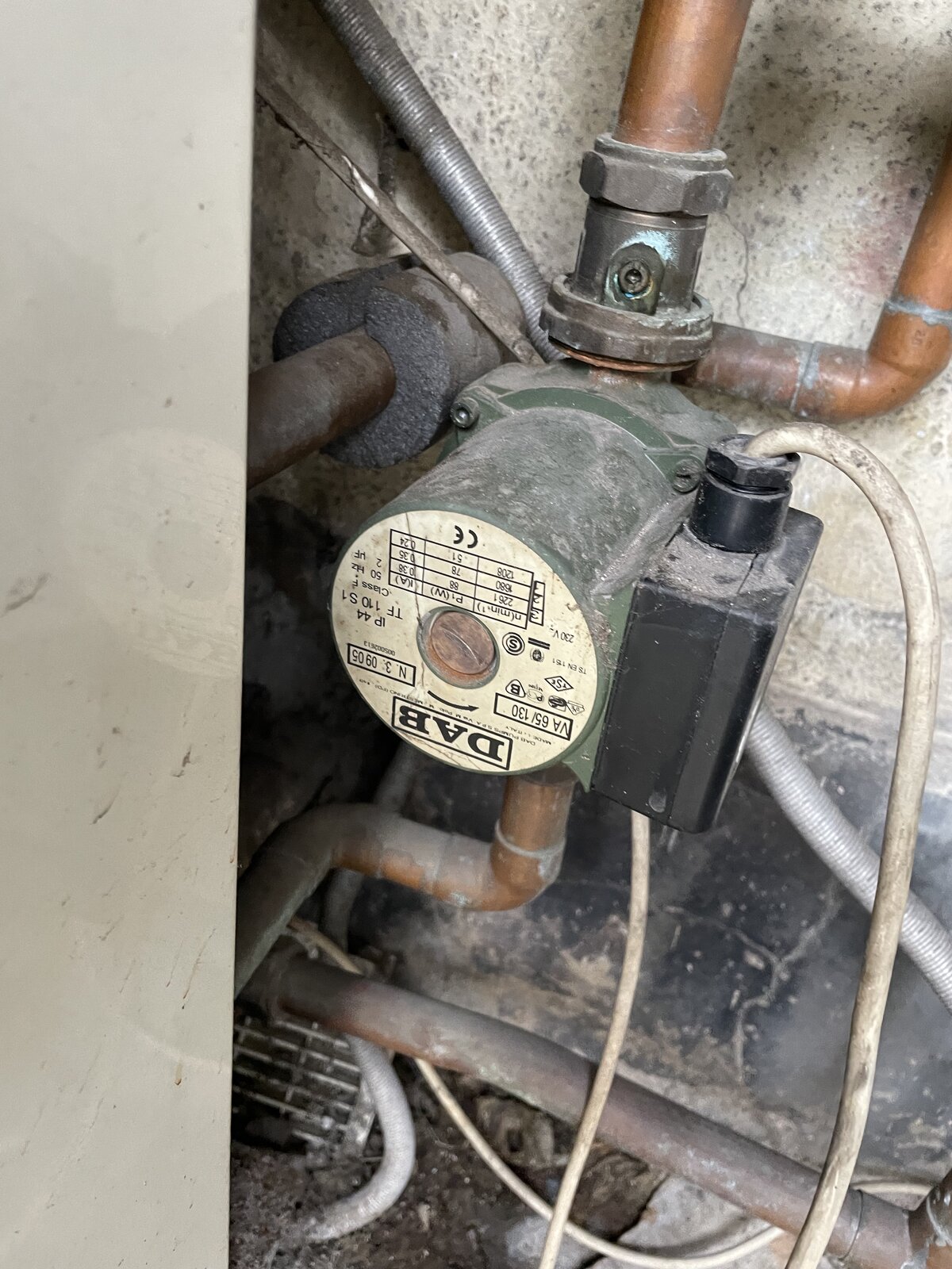

I see this on the return hot water near boiler on ground floor! Not on flow but on return - Am I correct that this is pumped hot water in that case
That pump is on the C.H return. You have a gravity circuit on the hot water. Can't get a grav. coil cylinder ? Look for an "annulus heat exchanger" - that's what's in the cylinder, with the opposite side tappings
Remember this is a one pipe system so if the ch is pumped then the hot water also must be pumped
There are two return to the boiler which are joined at the end before entering the boiler.
Is it your suggestion to add another pump to the hot water
Very doubtful the cylinder connections are pumped.
That looks a standard gravity set up .
Really needs cylinder with gravity coil .
With your set up just for ease and speed I would have a cylinder made . Extra cost is not excessive most cylinder manufacturers offer a bespoke service .
If you in a hurry turn round can be as quick as 3 days .
We use Newark cylinders great service and in our case we can collect.
You've said you're going to replace the boiler, the new one will have one flow and one return connection. You could add a motorised valve after the tee to the HW cylinder, and run it as S-plan.
Assuming the 2 returns are 1 from the rads, 1 from the HW cylinder, if you leave the pump where it is, on the return, the 2 pipes should be joined before the pump.
Thank you. There is already a motorised two port valve by the hot water cylinder which cuts off the flow when cylinder is hot
That means in the summer I need to turn off the radiators and run central heating to get hot water
I can’t get a cylinder made up. It’s too difficult to arrange and we have been without hot water for a while
The two returns are joined up before the return so the current boiler has one flow and one return
Is a gravity coil really necessary. I be seen others post that they have used the normal cylinders with good results
Yes, the new valve would go after the tee to the existing. S-plan has two 2-port valves
S-plan does it for you. The new valve only opens when CH is called on the roomstat.
No, as you're going for fully pumped a regular cylinder is OK. I doubt you could use a gravity system anyway, AFAIK all modern boilers are only suitable for fully pumped.
I won’t get to change the boiler for another six months because of money and new baby. Will the current setup work fine for six months until the boiler and new pump is fitted
By current set-up I assume you mean after a new HW cylinder has been installed. In that case, and if nothing else has been altered, if it worked before it will be OK now.
Thanks - What I mean is with the non gravity coil cylinder is this going to cause a problem. Wont be able to get to it until tuesday as waiting for wages to clear to buy material but dont want to be without hot water for much longer
I took out an old (heavy copper) cylinder which had an enourmous coil inside from top to bottom and the new stainelss steel one is much lighter
If the HW is gravity now, it will still be gravity until you alter things and convert to fully pumped. But fully pumped won't be a problem with increased pressure, if that's what you're concerned about. Though looking at it again - are you sure it is currently gravity HW? Doesn't the pipe that the HW tees off feed the rads? If it were gravity I'd expect dedicated pipes from the boiler to the coil. Not that it makes any difference to your plans.
