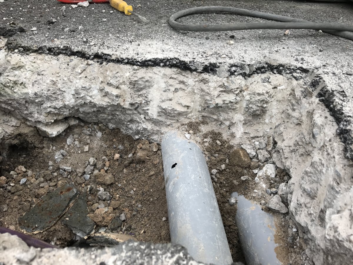

Spoke too soon, gas and electric in ducting:
And the drain I need is dropping down right below them :(
Very close shave on my parents driveway, gas service was found going through a bit of rainwater downpipe used as a duct, immediately below the garage floor slab, so about 5" deep! Only thing you can assume with an service is, its there. Until you know the exact depth and location, care is advised.
