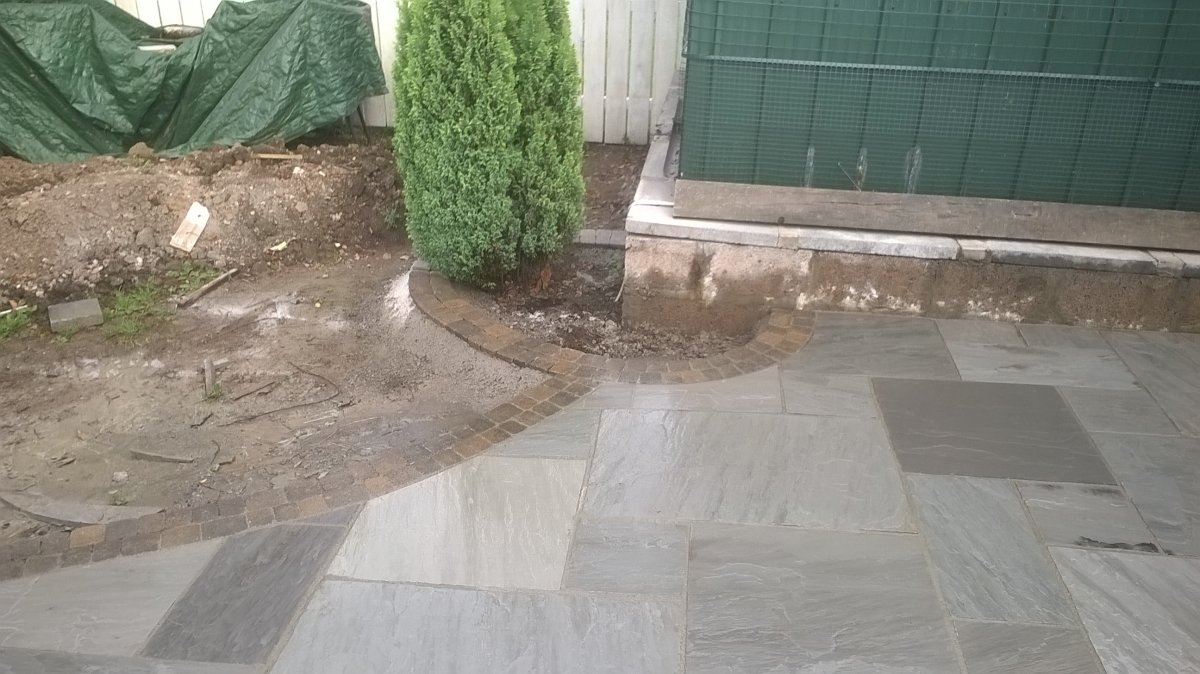

HELP! I've messed up!
Guys I was originally going to do the patio myself, but due to back injury I let a builder take over.
However, it didn't last long because I noticed the builder started taking shortcuts, such as spot-bedding. So stopped him when he had already completed approx 25% and since my back was feeling a bit better, I decided to continue.
My problem is regarding the pointing. He has already covered the paving slabs with wet pointing and after I completed another set of indian sandstone slabs, I used totally dry sand/cement mix brushed in, which was not squeezed in. I then sprinkled the loose mix with a fine mist of water spray.
This has not only left 2 dark/light colours due to his mix being different, but also my pointing isn't as solid (crumbling).
Is there any way to fix thesw issues please?
You will have to pull yours out and wet point it.
Are you sure his spots didn't knock down to a full bed?
