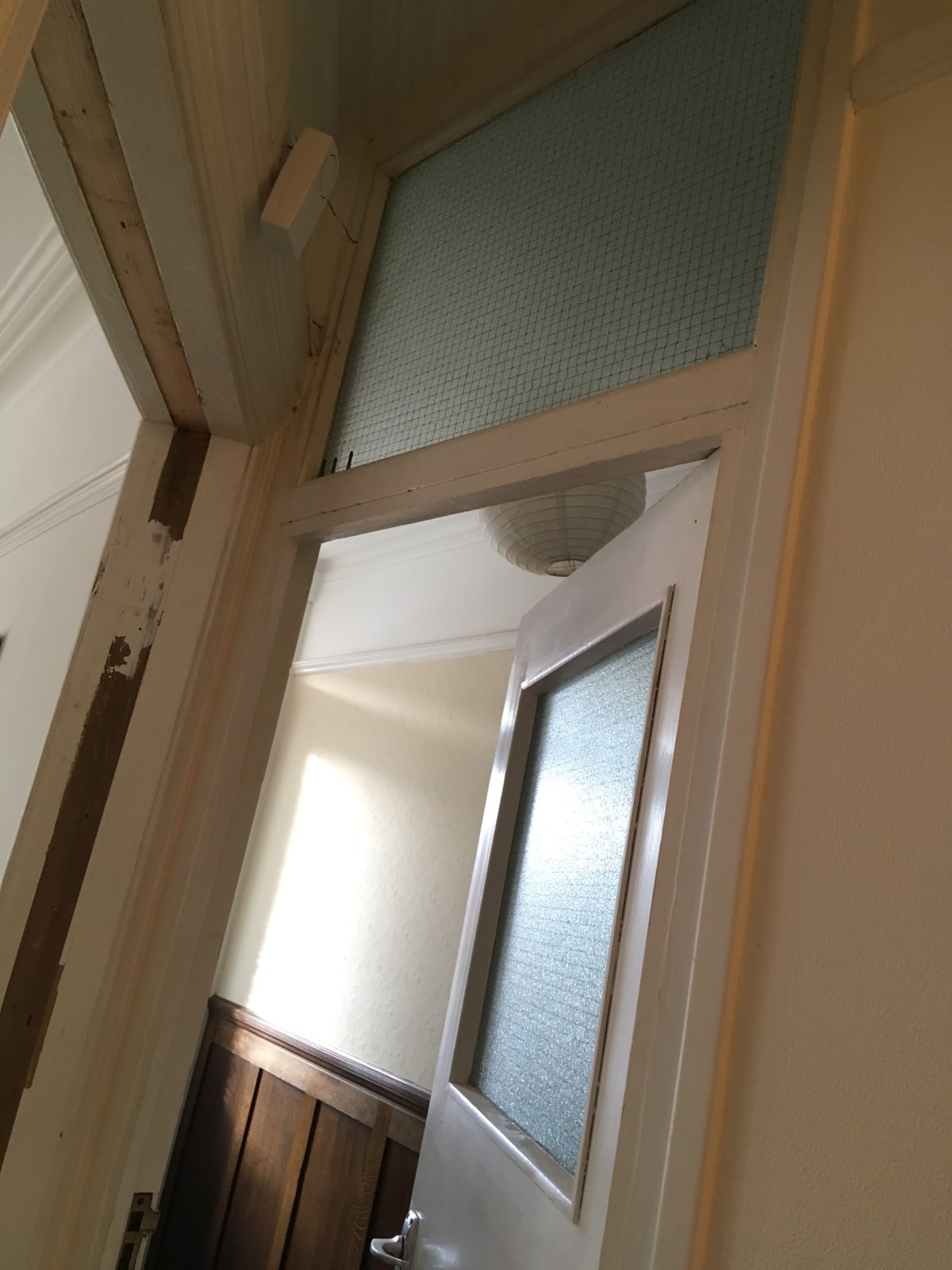

Hello,
I’m hoping someone can tell me what to look out for in terms of door type and size if it will have to be cut to size as I can’t find one to fit the existing frame.
The measurement is 28’’ 1/4” (from memory, an old fashioned measurement I have been told)
So if I buy one for the carpenter to fit, what extra width shall I go for or does it not matter so much as anything can be cut down?
It’s for an internal flat door with a glass panel at the top as per pic.
Any pointers appreciated.
Thanks very much!

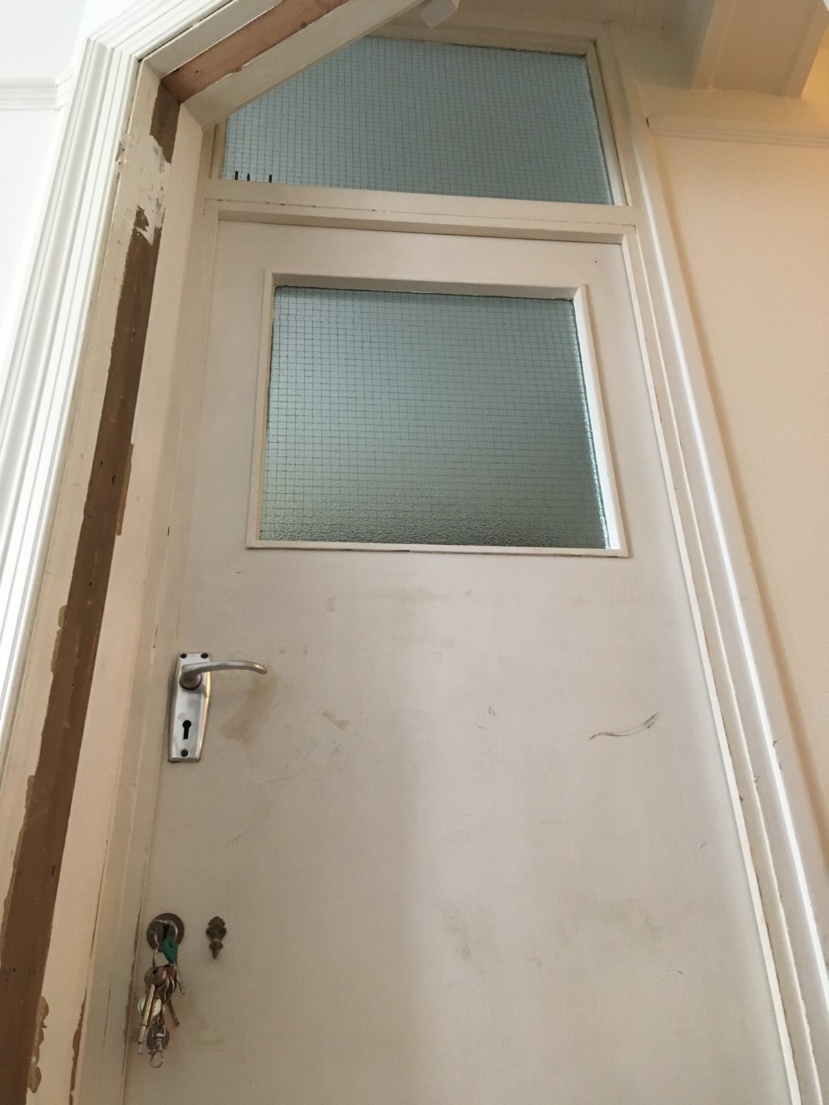

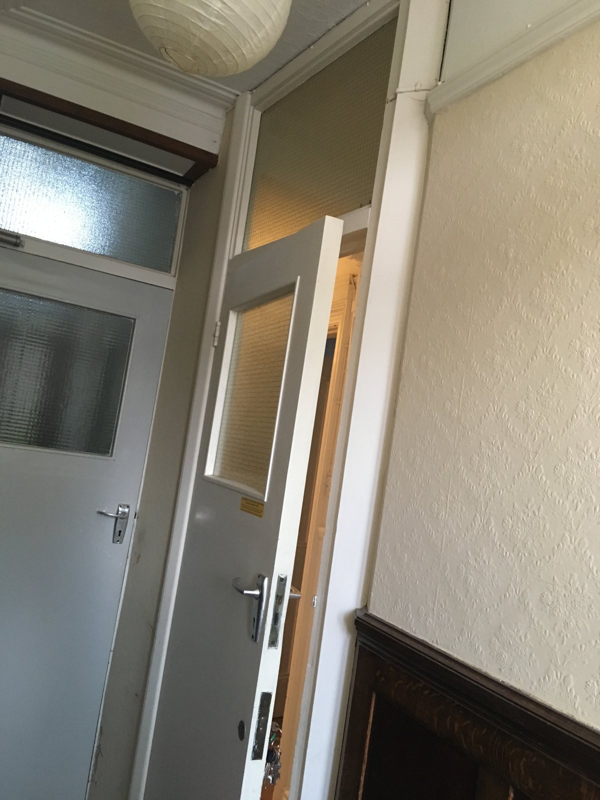

I’m uploading a couple of pics of the existing as this may help.
The conversion happened around 1990 so unlikely anything is compliant.
If I go for a glazed fire door, I guess I should be ok?
The existing does have wiring in as you might be able to see.
There is two bits of paneling and I would really like to keep at least one in the door as it will be quite dark otherwise. The existing door is 440mm thick.
My carpenter seems a bit unaware as you say. I haven’t discussed the job in detail though yet with him to be fair.
I’m struggling a little with the terminology, too, to be honest, as English is my 2nd language.
But a lot of good pointers and I will read up some more and hopefully make the right choice.
Is it ok to upload a link to a specific website where I’ve seen a door that may suit?
Thanks again.
