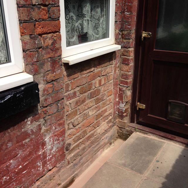

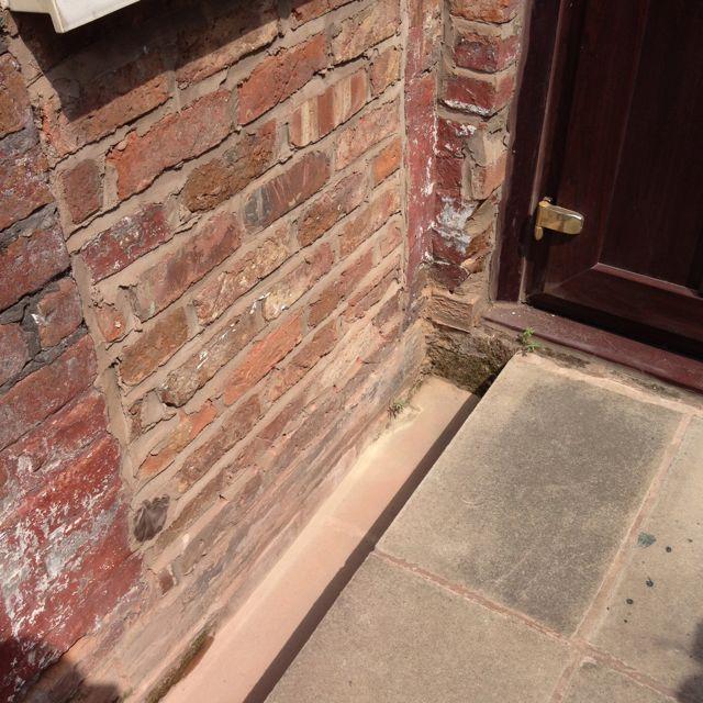

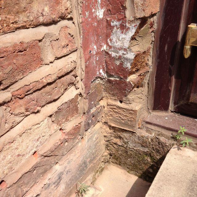

Just want to come back to this and say we've had the trench dug around the house. It works fine and water flows away from the house. Nice 2 - 3 bricks deep trench.
However, we still have a damp issue on the internal wall.
There's been a hammock bag resting against that wall to just above skirting board level for a long time. But other than that its been exposed. The trench was dug about 10 months ago. This wall isn't drying.

The orange affected wall is inline with the door.
