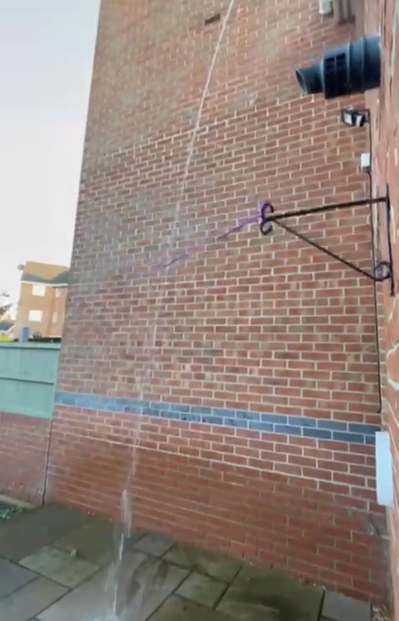

CW tank overflowing randomly for approx 20 mins daily.
There's a air bubble probably trapped in the top of the cylinder which is exerting pressure when heated and pushing the water back up the cold inlet, the vent should be straight off the cylinder top. In effect, a unvented cylinder.

My tenant say the boiler has been off since yesterday yet the banging happened this morning followed by the cwst expelling water like this.
Afraid I can't give a definitive answer to that, all I can say is that a mixture of air and water is not desirible in any pipework but might be unconnected with this nightly banging. You should try and sort out the HW cylinder problems first, you are certain that there are two vents, one goes up and over the F&E tank, the other, (where the water comes out) is over the CWST. Can you see how far this vent is from the HW cylinder, also cylinder details from the label, also the vertical distance from the HW take off to the cylinder top, might be barking up the wrong tree if this is taken off the top of the cylinder even though it doesnt look that way.

A dip pipe into the water on the overflow - aka. byelaw 30 kit ( to stop draughts blowing across the water surface) could suck out a load of water if , as JohnD says. Picture of the overflow inside the cistern ?
