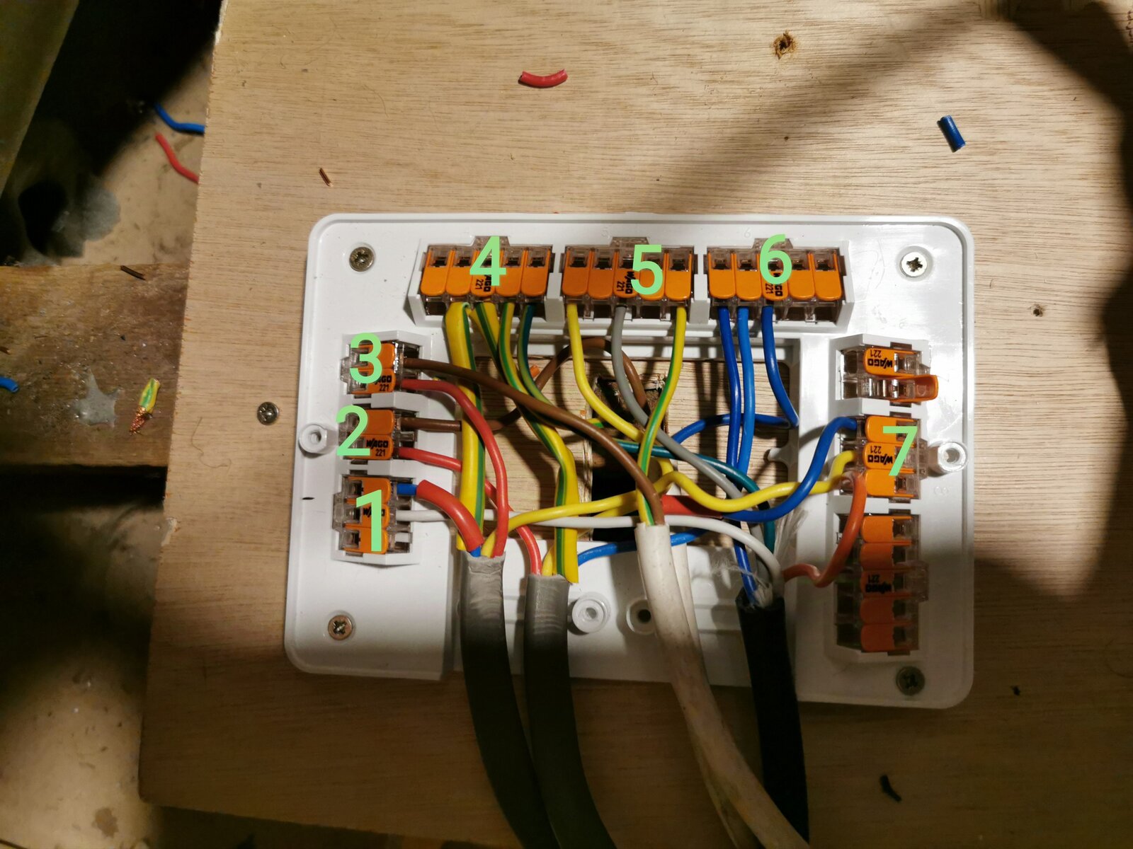

I just remembered my wiring centre is bagged to prevent any moisture entering it. With the cover screwed on and then bagged. This was done few months ago.
Any moisture would now be entering the pump wiring, cylinder stat or the 3port valve (where the lever is). Pump works fine.

The problem reoccurred this evening when HW turned off at 650pm the CH turned off too despite being set to turn off at 8pm. Happened last Friday as well!!
I did some testing today (from the boiler end).
The yellow wire (No7) connected to the orange got 240v for CH only and HW only and also for CH with HW. However a few times it got 140v too. Boiler did not fire up nor did the pump despite getting 240v.
The "HW on" cable sent 240v when HW was turned selected on programmer. Similarly when selecting CH the thermostat cable sent 240v. Cylinder stat is at 60 so there would be demand for HW and the water in the cylinder was cool (unless cylinder stat faulty).
I then checked the PCB on the boiler the switch live was getting 140v (via the yellow cable connected to No 7) and the wire connecting the PCB to the pump was getting 140v too. Other occasions I was getting 240v.
The pump and boiler then decided to fire up.
240v is going up to the 3 port valve but on occasions only 140v is being sent down.... Why would this be??
This morning same issue again but was 240v where needed but boiler and pump not firing up despite getting 240v on pcb switch live and the pump from pcb.
