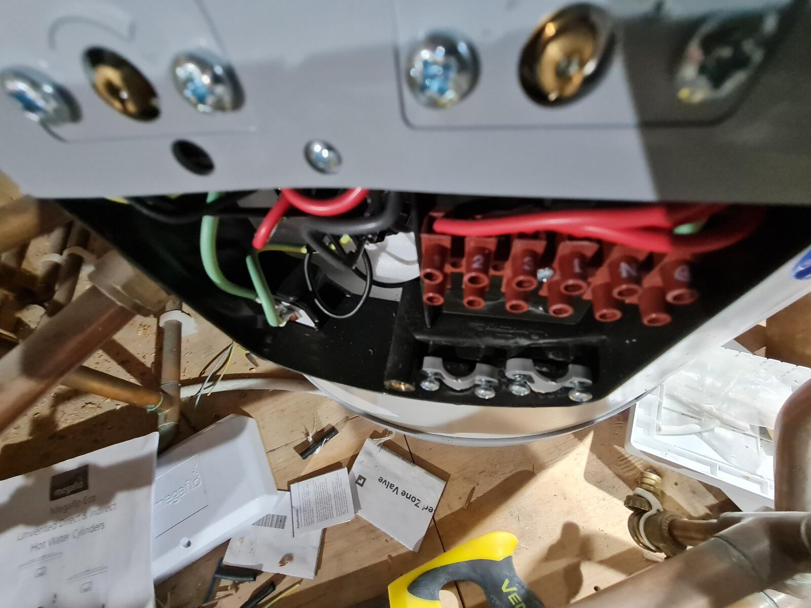

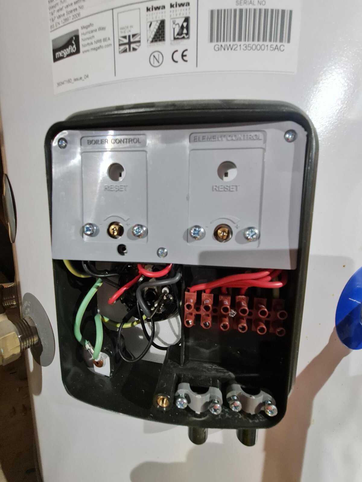

The plumber has temporarily wired up my central heating system to give me hot water and heating. He has wired an S-Plan system as requested but i have noticed he hasn't ran the hot water via the cylinder thermostat so at the moment the boiler heats the water I the cylinder when the programmer tells it to but doesn't stop when it hits the set temp. I have set the programmer to heat water for 1hr in the morning and evening for the time being but i want to run via the stat to prevent potential for overheating and for it to be connected correctly.
The cylinder has 6 electrical terminals. The 3 on the right are L/N/E. I assume I connect the emersion heater supply here so that if the boiler ever goes down i can flick the water heater switch and heat via the immersion? Is this correct?
On the left there are 3 more terminals labelled 1/2/3. I assume the 2 port valve signal cable goes into one of these and then a cable out back to the control box essentially breaking the heat water command to loop in the cylinder thermostat. Which terminal (1/2/3) is for signal in and which for signal out?

1&2 for S plan, with 1 as the input and 2 as the switched output, although it doesn't really matter with only 2 as it's just connecting them together when heat is required.
3 is only used for Y plan which requires a 'hw off' connection.
LNE for the immersion heater, normally supplied via a 16A circuit and a 20A isolator switch. Not a FCU with a fuse in it.
Wiring info can also be found in the instruction leaflet on the floor.

Thanks Flameport. So just loop the stat in between the 2 port valve and control centre via terminal 1 and 2.
I got a 16A circuit for the immersion linked water heater switch on the landing then to a fused spur which i had planned to connect the immersion to. So does this need changing to a 20A isolator?
I am really sorry to say this @padstar but you need to stop heating the cylinder via the boiler, if he hasn't wired it into the stat.
You should not heat an unvented HW cylinder without a thermostatic control, that's could be downright dangerous. That plumber needs a serious kick in the stones to leave an unvented HW system like that, even temporarily. It would have only taken another 5 mins to run a suitable temp cable to tie the stat into the system.
Unvented cylinders are not DIY'able, any trade working on it needs to be qualified to work with unvented cylinders for your safety.
As @Madrab says , it is not that simple with an unvented cylinder, the zone valve is also a safety device and definately not a DIY job
