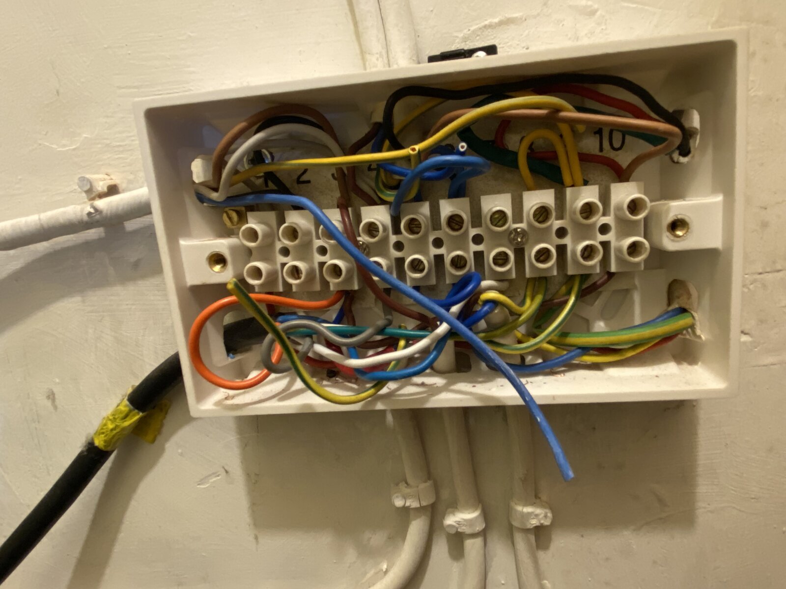

Hello.
Drayton HT3 tank thermostat wiring?
Common, call for heat, satisfied. Simples!

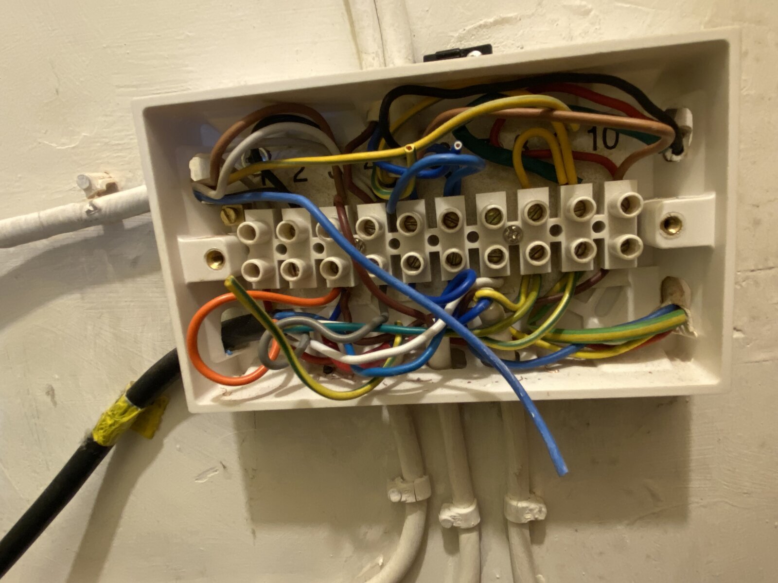

Just swapped thermostat out as old was faulty. Think there’s also a wiring issue?
Satisfied seems permanently live. HW is off on controller. When plate at back depressed, common turns live so circuit is satisfied and common as loop. Call doesn’t get any juice.
With HW on, common live, satisfied live, call live, when backplate depressed common is live, satisfied is live, call is dead.
Where should the permanent live go to, common, right?
Then the call and satisfied make the loop accordingly to thermostat setting? No?
The issue is when controller turns on, whatever temp thermostat is set, boiler continues to heat, until controller turns off, not as should be when reaches thermostat temp.

You don't say, but assuming that you have a mid position 3-port valve...
The above would be correct. HW satisfied (aka hot water heating not required) gets its live from two places 'satisfied' from the cylinder thermostat and 'HW off' from the programmer. So if HW is off at the programmer, then cylinder thermostat 'Satisfied' should also be live.

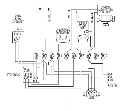

Can't comment on your other points as I don't really understand what you mean. However, here's how it should be:
Common (C in drg below) - Goes to 'HW On' at the programmer
Call (1 in drg below) - Goes to boiler switched live [starts the boiler when heat is called for]
Satisfied - (2 in drg below) - Goes to motorised valve grey wire and 'HW Off' at programmer

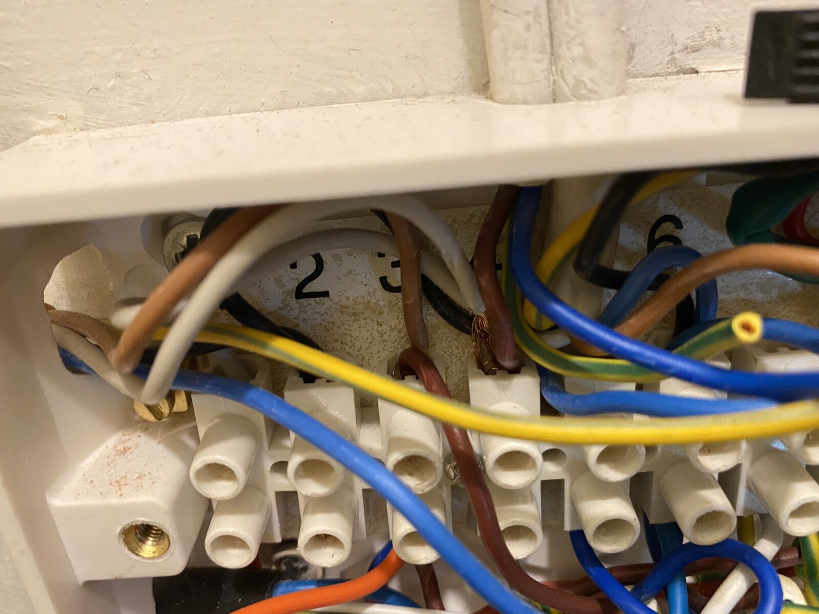

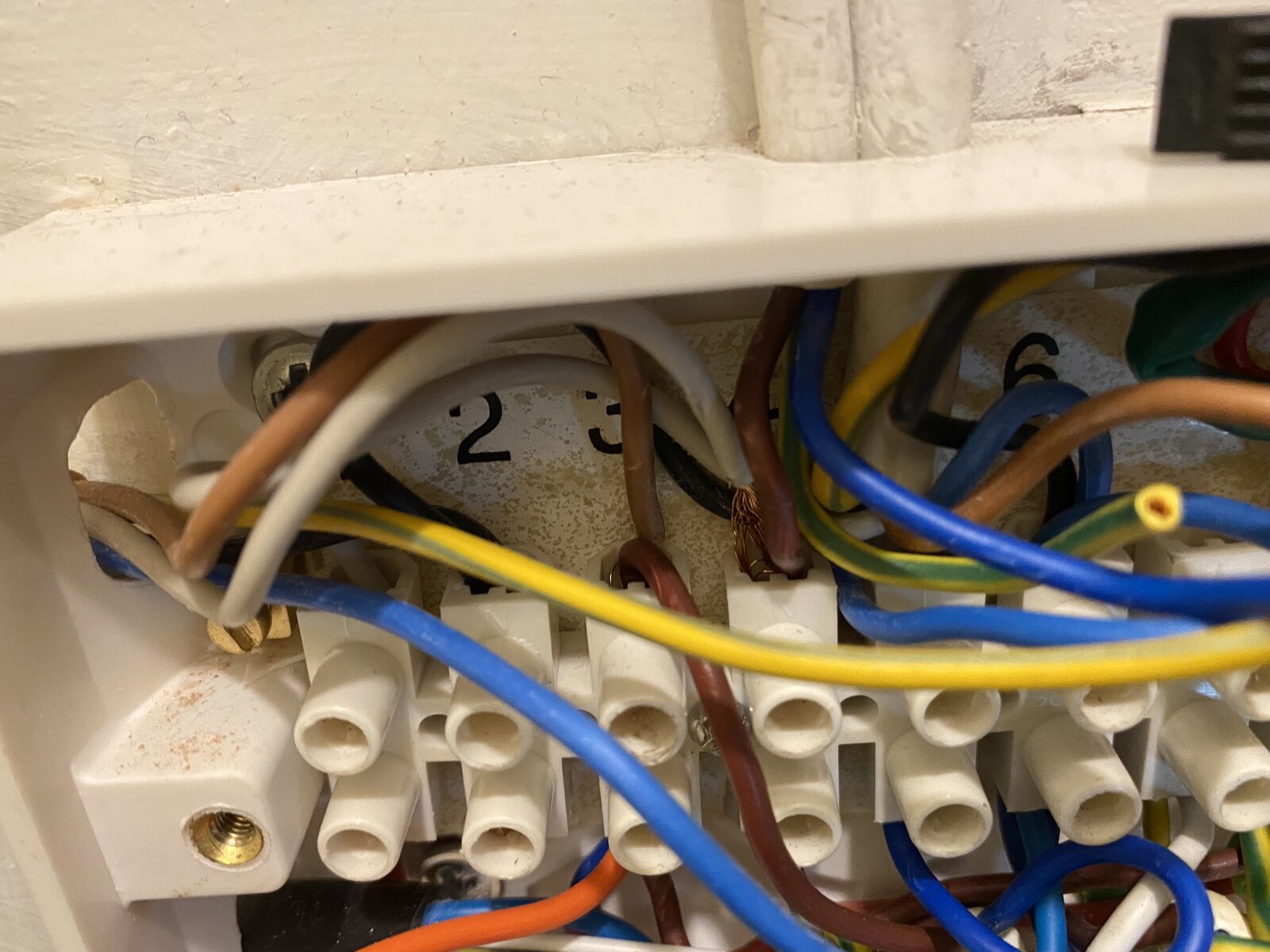

Thanks. After further troubleshooting, I might have found the problem. The satisfied is loose and not connected in the junction box, so not telling HW off in the controller. I’ll reconnect and try again. 3 port valve cable is black, bottom left. The grey is connected at the bottom of the chock block, and the brown going in top is the Hw off controller feed, but that other grey, is the satisfied.

So, checked and fixed all wires. All are lined up as they should be and match the y wiring diagram. However, HW still doesn’t switch off. Have set new tank thermostat to 50, which is lowest before permanently off ( when I turn permanently off, it does switch heating off). The boiler and pump are still called for.

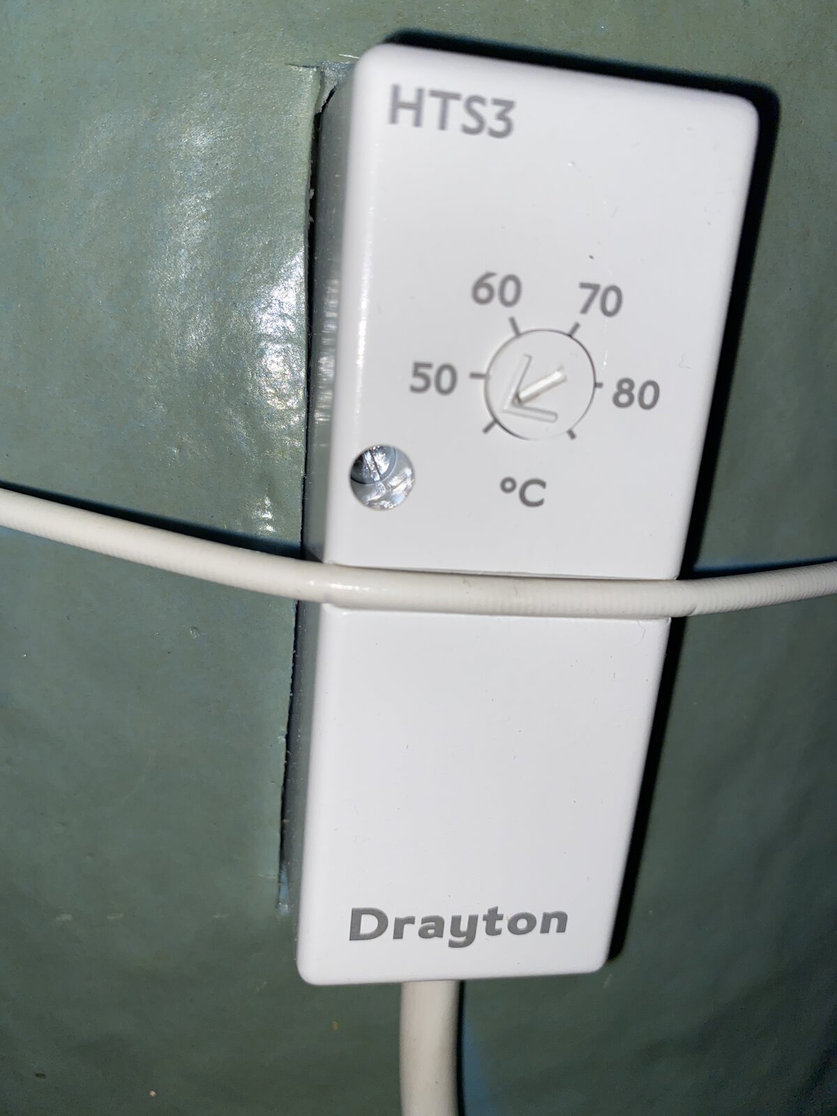

When checking the placement of tank thermostat, it’s clean inside the insulation cut to the brass tank, the level is about right at 1/4 - 1/3 from bottom, but when touching the bare brass and holding my hand there, it’s really not that hot, yet the water out the taps is significantly hotter (don’t have thermometer to take actual readings), system was fully yet washed/descaled/etc nov 23, but I’m now wondering if there’s sediment at the bottom of the tank, therefore reducing the stratification?
That's normal. The thermostat is calibrated during manufacture to take that into account.
The cylinder thermostat is quite easily tested, when the hot water cylinder is at the temperature you want, turn the thermostat up and down until it clicks on/off. The point between the two clicks should correspond to the temperature of the water at the top of the cylinder that would go to the taps.

All wiring is now correct, and tight, and lines up with normal Y plan schematics.
3port valve body is working and free.
3port mid position head is new, and wired correctly.
Tank thermostat is new and wired correctly.

When I meant permanently off, it’s the Drayton ht3, and the new one has a final click for 0, that is a complete ‘off’.
Really?
If by 0 you mean the symbol at the bottom it's °C as in Degrees C, the value it is measuring. It will click off when sensing a value below its set temperature.

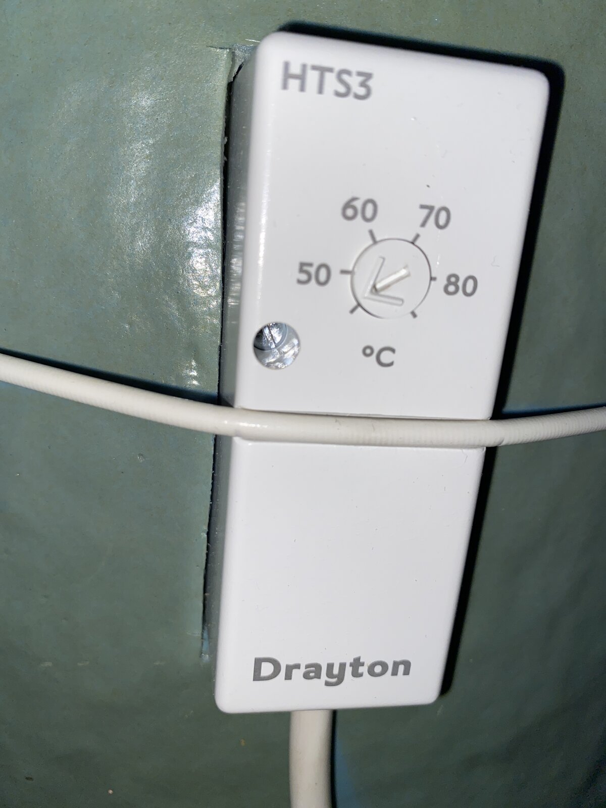

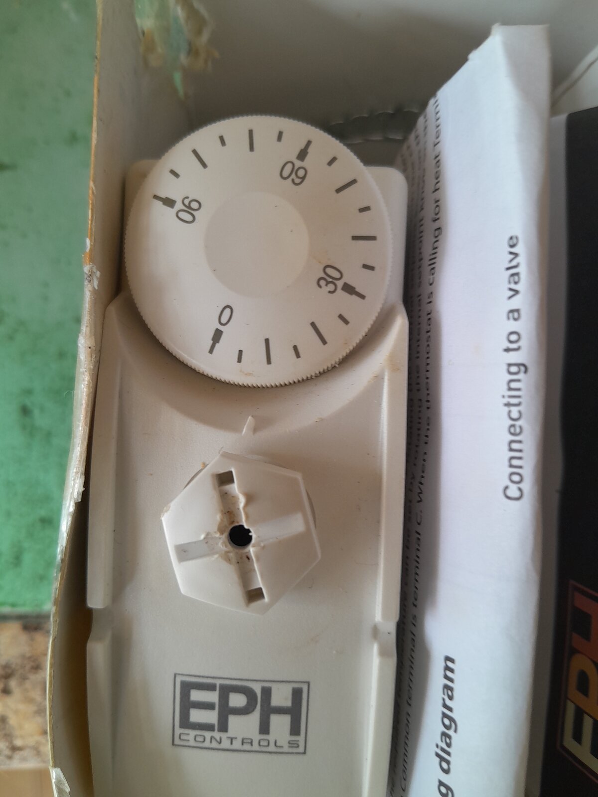

Yes, that’s the old ht3, the new one is slightly different with an extra, off position but right at the bottom. You see the different screw position. Everything else is the same, except the extra off. It’s an extra hrs click, not a marking. You see how low the setting has to be for it to slightly work. I’ll get a thermometer and get some propert water temp readings. I’m getting a flow of 38c into the coil reading a radiator strap thermometer, and there’s a good difference on the return, so it’s working.

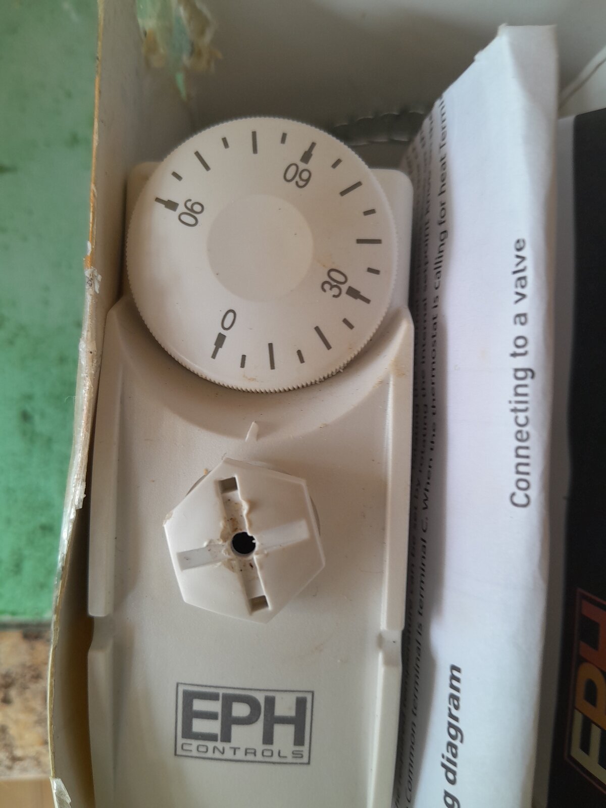

Thanks. Yes, the HW turns on and off when adjusting the stat, but it only really registers right down the bottom of the measurements. So I know electrically, it’s working. I’m just perplexed as to why I need to be setting it almost off to get the temps of the taps down.
There should be ~ 8 to 10C difference max between clicking up and clicking down the stat, if the tank temperature is say 40C then just turn the stat fully up and then slowly keep turning it down near the 40C mark until you hear a click, then turn it up very slowly until you hear another click, should be around 8C to 10C max between clicks, stat hysteresis.
I've installed a few of these for relations, I just tried the hyseresis on this new spare and its only ~ 6C, it seems to have a better defined scale than the HTS3 above.
