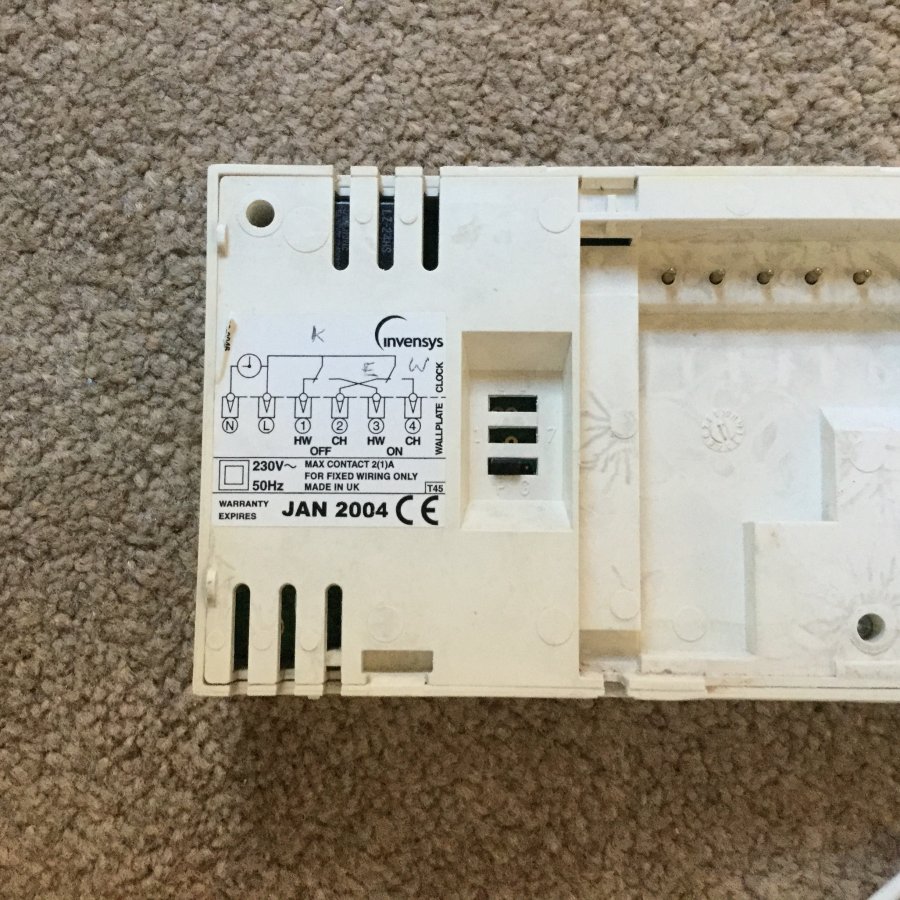

I have an ideal classic boiler and a lifestyle LP241 programmer, no thermostat on the system. I can turn heating and water on and off separately or together.
I want to swap the programmer for the nest heatlink and then control it with the nest thermostat third gen (which says it can control hot water).
My existing programmer has the following wires.

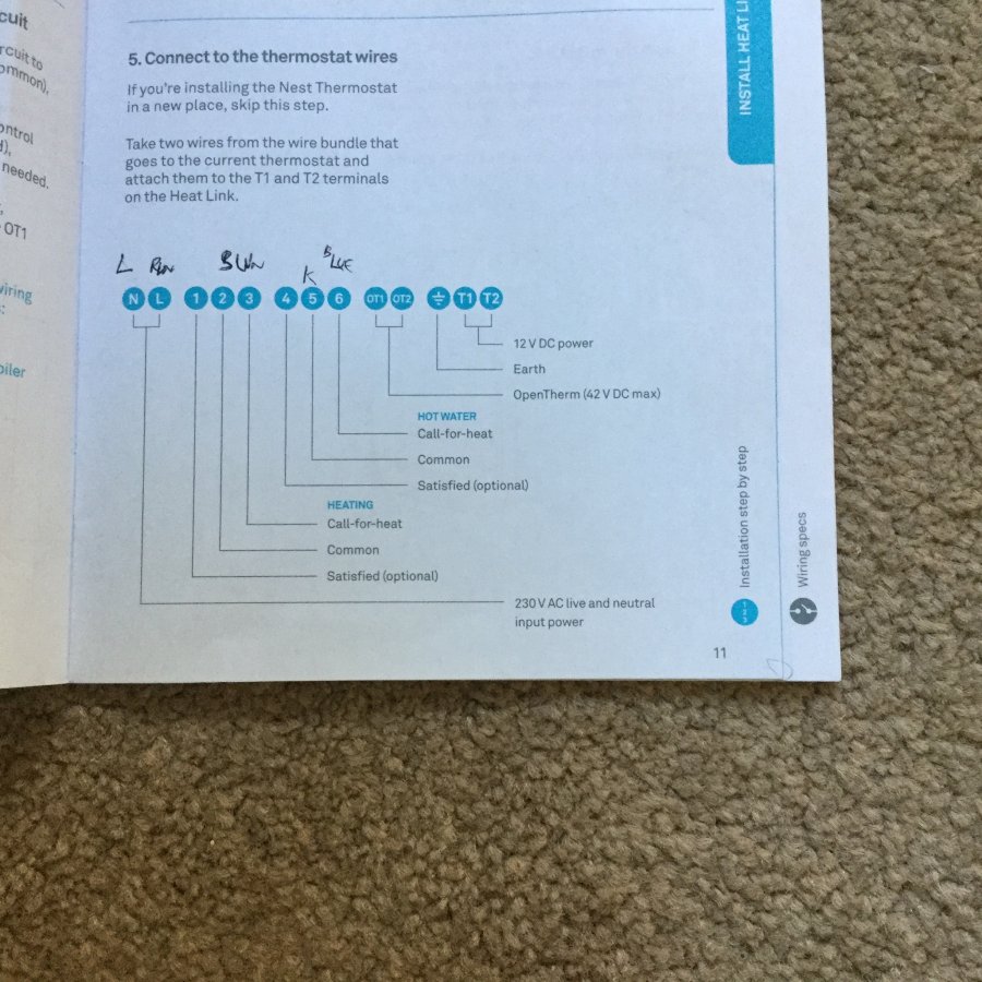

The heatlink appears to ask for four wires, hence my confusion. It asks for CH Call for heat (i presume this means on), CH common, HW call for heat and HW common. On the basis that hte old programmer had only got a connection to heating on, i connected CH ON from the programmer to call for CH call for heat, HW ON to HW call for heat and HW OFF to HW common. What am i missing?

Link Live to CH common and HW common. Everything else is blatantly obvious
