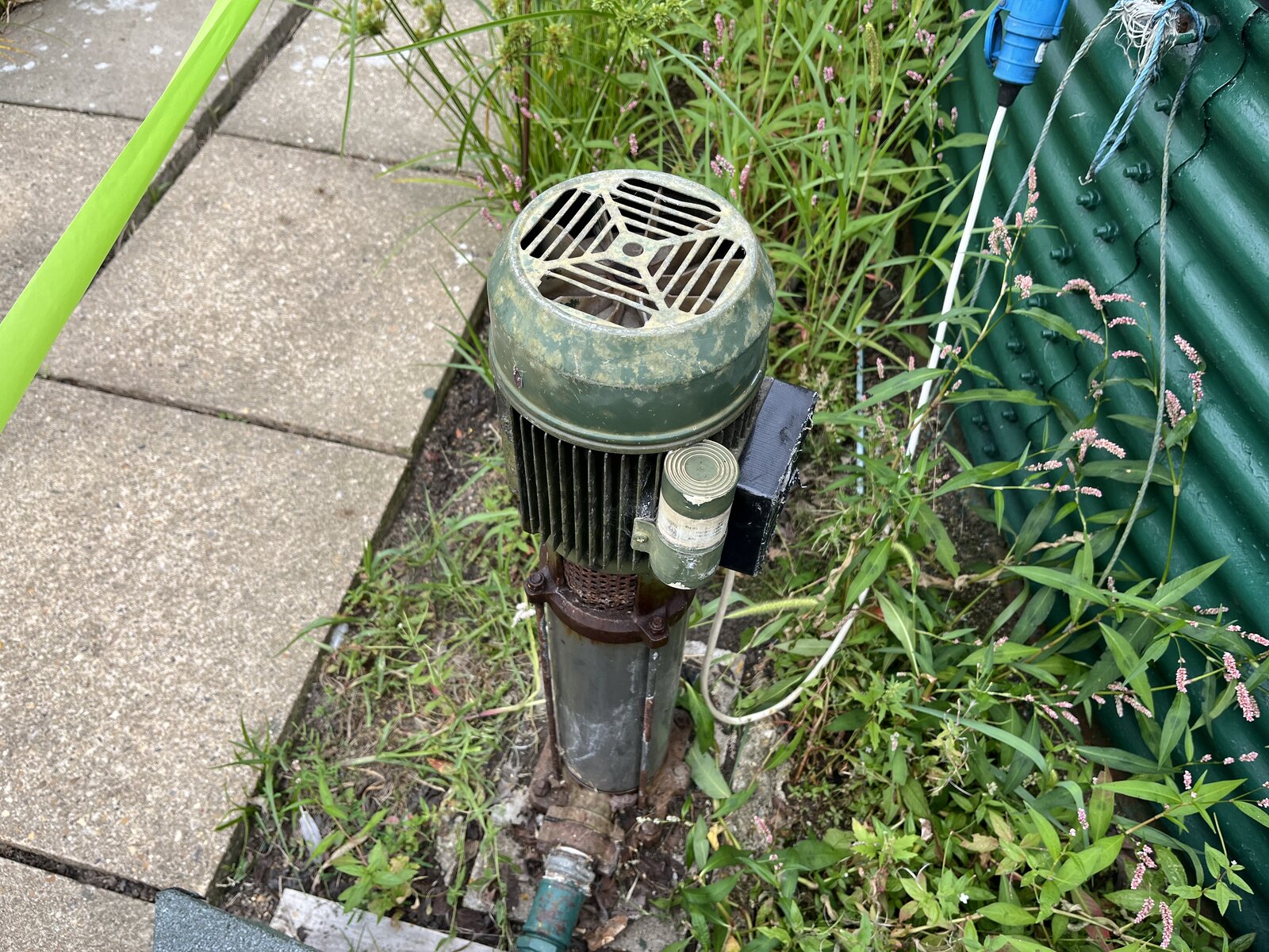

I have a dab centrifugal pump for pumping water from a holding tank to water plants on a nursery. It’s quite old but generally works well. Recently it’s been cutting out after an hour or so of use. The supply is fine and the motor spins freely when this happens so not seized. 10 mins later it runs again, but only for a while and I have to wait a while again. Is this likely to be overheat protection? Not sure if it even has this feature. Any other ideas as to what might be causing this?

The fan turns freely when it suddenly stops. The electric doesn’t trip, although it did an earlier in the year before this issue arose. I think I’ll get the motor off and have a look and take it to be tested if nothing obvious.
You have an old multi-stage pump there, can`t remember if it has overheat protection or not. There are plain bearings within the pump and ball bearings in the motor. Personally, being an old unit I wouldn`t waste money on having it tested or a rebuild.

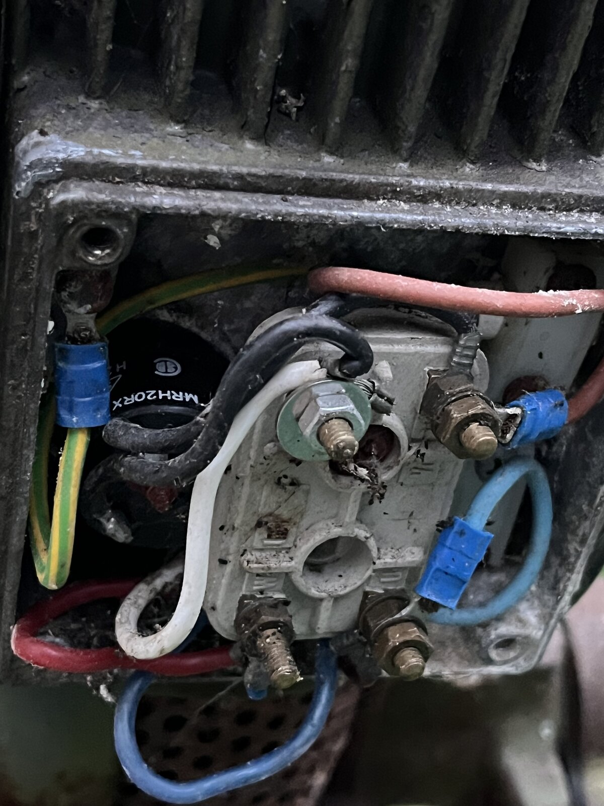

I assume the round black component is the thermal overload
Probably, but a search for mrh20rx finds nothing. A couple of tests would confirm it - the resistance between those two terminals at the top, will be zero, and - when running, and it stops due to overheating, the resistance will go high.
However, if the motor is getting too hot, then that component is doing what it is there for - switching the motor off.
