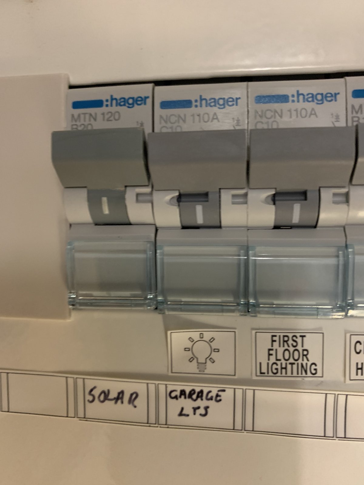

Sorry for being super cautious but just to be safe on ensuring that I’m not overloading the circuit by adding two more lights.
The garage seems to be on it’s own circuit. Here’s a pic from the consumer unit. I’ve tried turning off just the garage at the consumer unit and checking lights in the rest of the house and it seems to confirm that that switch is only for the garage.
And therefore, four fluorescent lamps is absolutely fine?
Thank you.
