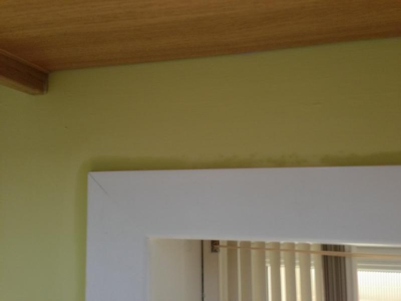

Hi, Ive a weird damp problem around the window frames in my kitchen.
Basically, Ive damp patches appearing all around my freshly painted walls at the edges of my plastic kitchen windows. Has anyone any ideas about what might be causing this and how I can cure it?
It could be the sealant on the outside missing or not well-done.
Alternatively condensation through cold bridging?
ive seen this before, it wasnt damp, it was the sealant reacting with the paint
